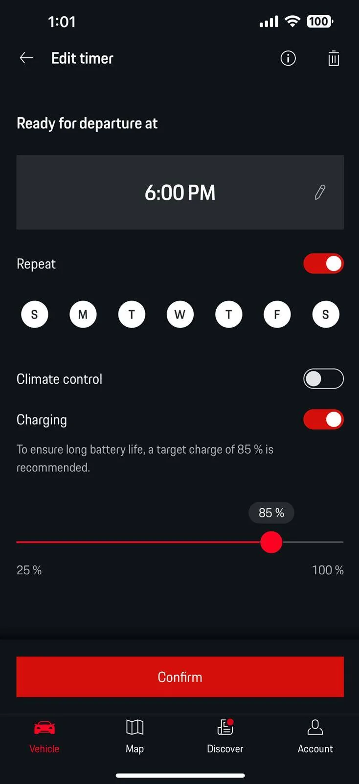

Here is a timer you can setup in the app which would charge daily to 85% by 6pm. Note climate control unchecked.
It will only charge, not precondition. Preconditioning is heating or cooling battery to specific temperature for DC fast charging.
Note climate control unchecked and charging checked above.
While charging, 12V battery is topped off too because the car is mostly on. No need to heat the main battery. If your set it up to charge less often, it will fill up longer, heating the battery some.

1. Charging HV battery also causes 12v battery to be re-charged?
During charging, the HV subsystem is powered on. The 12V battery tops off whenever HV system is on. My speculation (hope?) is that the 12V "refill counter" is reset the same as the turning the car ON, so that it will automatically enable the HV battery for top off up to the max counter value.
2. If car is stored and not being driven and theoretically not losing much charge in 24 hours, would <brief> daily charge to 85% - once battery achieves 85% one day - actually have any impact on 12v battery?
The main effect in this case I would hope for would be to trigger a 12V top off (even if not at refill threshold) and reset of 12V refill counter. It's probably not required every day, I was just making up a quick example.
3. Is HV battery charging the same as "preconditioning"?
It's whatever "Charging" means for a departure timer. I would hope some battery preconditioning, but not sure.
4. Assuming this works to keep both batteries charged, why not charge daily to 50% if car is in storage?
I just made a quick example on the app to capture the screen. Yea, 50% would probably be just fine and maybe slightly better for extended parking (weeks).
5. Can this profile be set up in the PCM, not the app?
I would imagine so, but haven't confirmed it.
