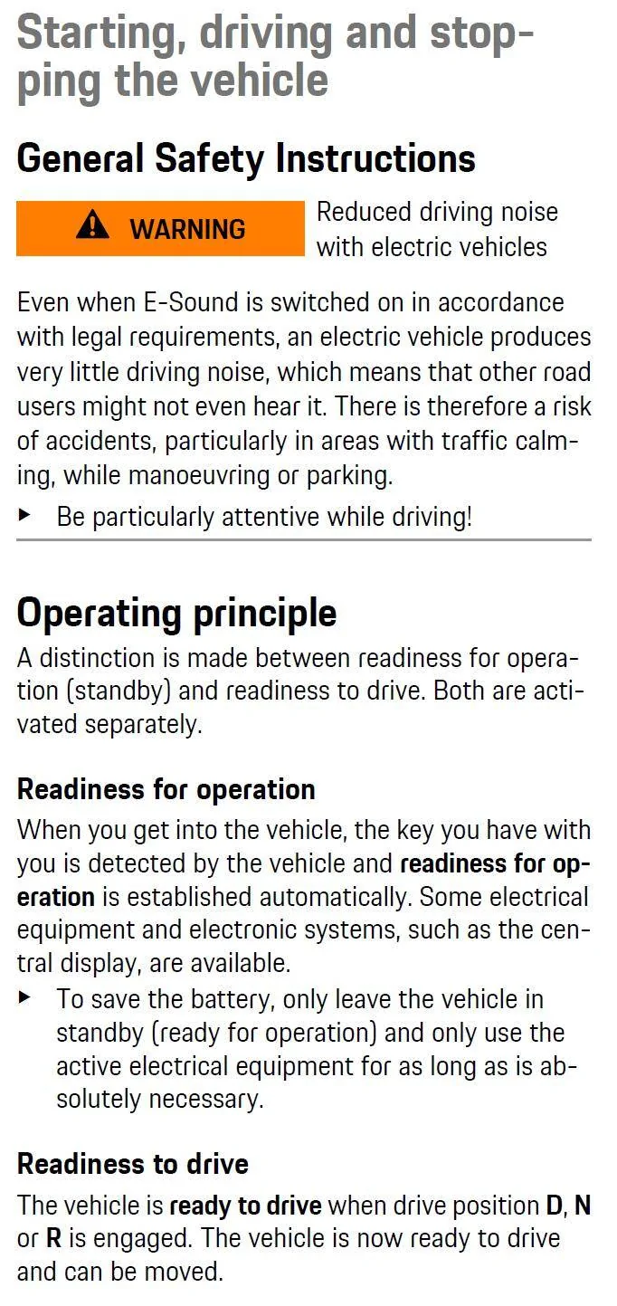

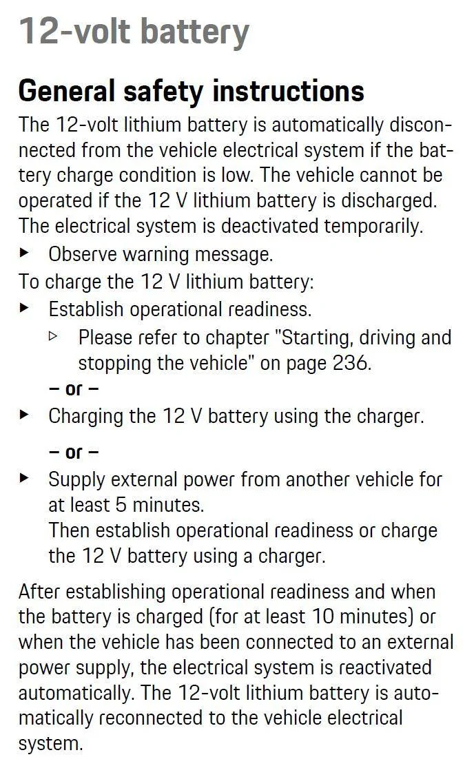

During charging, the HV subsystem is powered on. The 12V battery tops off whenever HV system is on.
Are you certain of this? From what I see in the manual, the 12V battery ONLY charges when the vehicle is "ready to drive", meaning turned on and not in Park. Maybe I'm reading it wrong, but that's how it appears, hence the warning about the 12V disconnecting if it gets too low and others talking about connecting trickle chargers for long storage periods.
Porsche Taycan Taycan Dead After Vacation 12v_2
Porsche Taycan Taycan Dead After Vacation 12v_1
