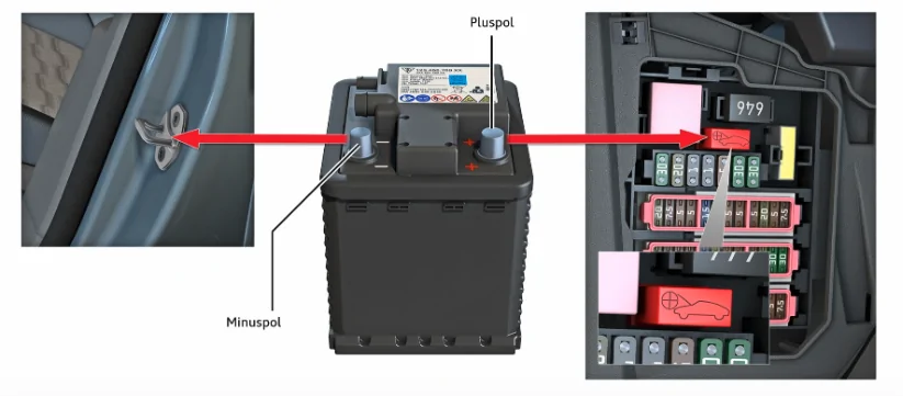

Most likely you will have a dead 12V battery which will need to be jump started. The 12V battery is located in the frunk and I assume you can't open it since the car is dead. You will have to access the fuse/relay panel in the driver side footwell and apply 12V from an external battery or VERY powerful power supply. This is also described somewhere in the owners manual but you will basically have to apply the positive 12V to the red pull out tab and the negative to the door lock hook. That will set off your alarm among some other things but after some time you should be able to unlock the car and open the frunk which will give you access to the posts of the 12V battery to jump start the car again.

Thanks to all… Flat bed truck arrived and jumped to open frunk and jumped once again to power on the car. Was able to drive onto flatbed but car died once again after powering off. As all suggested 12V battery is probably dead after 4 years, but don’t believe the 12V top off is working as when plugged in charger it went into standby mode to take waiting for reduced electrical charge cost.
