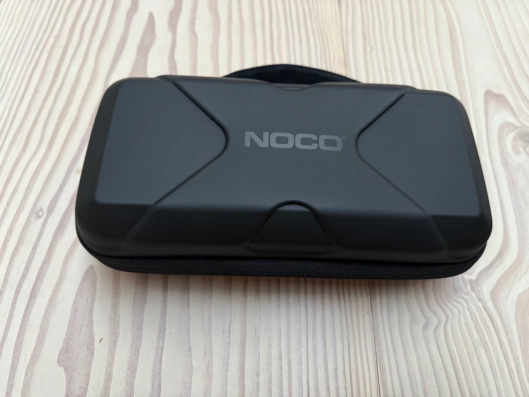

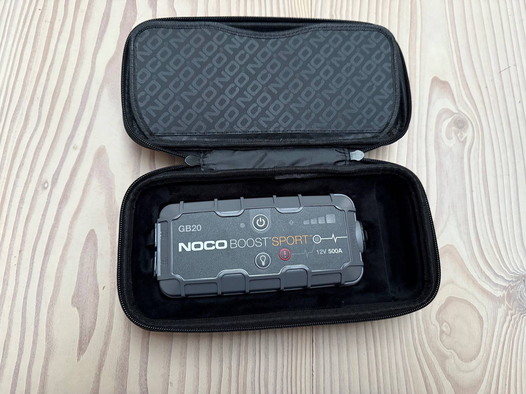

I'll check to see if it fits with it's case etc, but might be a bit chunky to fit in the glovebox inside the case / or find somewhere else to stash it in the cabin:
Porsche Taycan Taycan Dead After Vacation IMG_0475
Porsche Taycan Taycan Dead After Vacation IMG_0476
Hence my question on the smallest 12V 'pocket-able' power source I can get away with....
I have/fit the NOCO Boost XL GB50 in my glovebox.

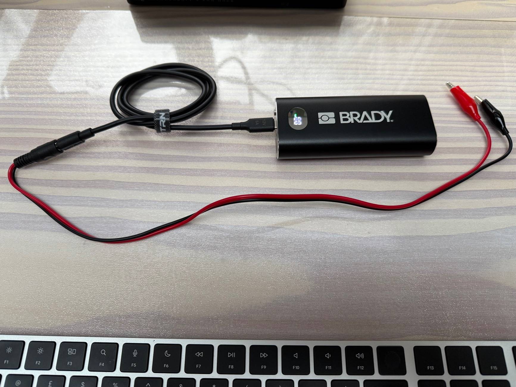

Borrowed a power bank, and used a USB-C PD lead (12V output up to 5A) with the alligators on the end of it. This should do the trick - enough poke to be able to pop open the bonnet/hood....not to jump it off course.

I can't get the NOCO GB20 in the glovebox here. Don't know if our RHD cars have waaaay smaller glove boxes than LHD cars, or I'm just not ramming it enough ?
There are different "levels" in the glove box that you have to negotiate to get it in there. Pretty sure the GB50 that I have is bigger than the GB20 that you have.
Your power bank solution may not get you very far. After using the GB20 to get the frunk to open, you are going to have to charge the 12V battery enough to get it operational if you want to continue on with whatever recovery you are tasked with. I don't think that little power bank is going to do the trick.

Use the power bank to open frunk and keep Noco in frunk to boost 12 Volt. It should only be necessary very occasionally as the software usually keeps the 12 Volt charged by the big battery but occasionally it can get caught out particularly when very cold (the software is not foolproof although some members think it is). Only had a problem once in two years.
