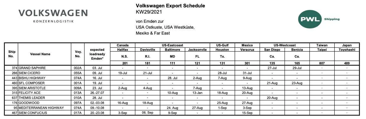

V332 Exit port Emden. This means your car has been loaded onto a ship and has left port. Prior to your car leaving port you can use the V332 expected date as a way to figure out what ship it might be transported on. See below
Go to this website: http://www.pwl.de/en
On the middle right side of the screen under “Liner Schedules” select trade lane “US West - and East Coast"
Then under select carrier choose “Volkswagen Konzernlogistik Export”
It's worth noting that this link (http) no longer works. But the https version did, at least for me:
https://www.pwl.de/
Scroll down a page or two to "Shipping Portal" and under Schedules select "U.S. West- and East Coast" and "Volkswagen Konzernlogistik Export"
