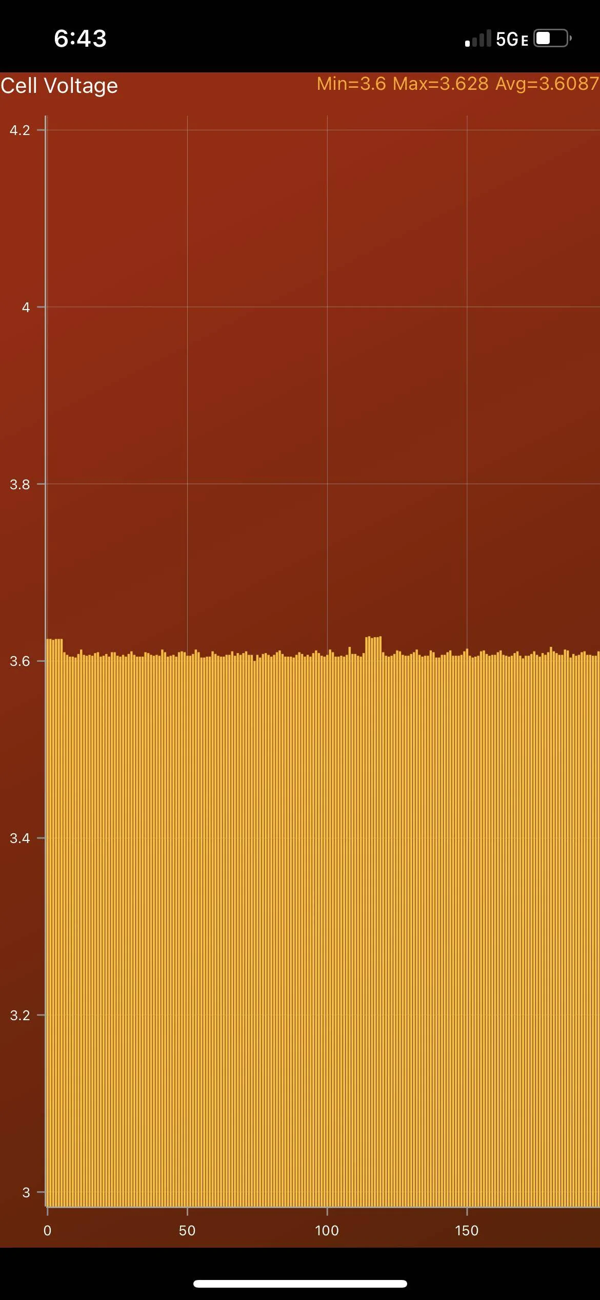

Have my car back! Everything looks good, and I plugged in Vgate iCar Pro using the Car Scanner app and it is terrific! For $30 bucks it's definitely a great buy, and gives you hundreds of data points on pretty much everything your car is doing, or has done (didn't think I had done 32 launches... ;) ). The estimated mileage is back to normal, giving about 270mi at 100%, and battery SOH is 91%. It's very interesting to look at the individual cell voltages. They vary from 3.601 to 3.629. Can you guess which cells are in the replaced modules?
:D
Congrats on getting you car back. Did they replace other things than just the cells? It feels like these cars have an issue with balancing the individual cells - Wonder what they do to prevent these issues reoccurring. It must be super expensive for them to do these kinds of repairs.

They had to replace a drain tube that was damaged during battery removal, but other than that, just the two modules. I did ask specifically about whether the problem would recur, and the tech felt the single cell was probably defective from the beginning, and felt very confident the other cells, AND the HV charging system/software was good for long-term. Yes, it is quite expensive for this kind of repair - flying a tech in from Atlanta for three days... They replaced the second module out of an abundance of caution, so I feel pretty good about this as a long-term fix. ?
