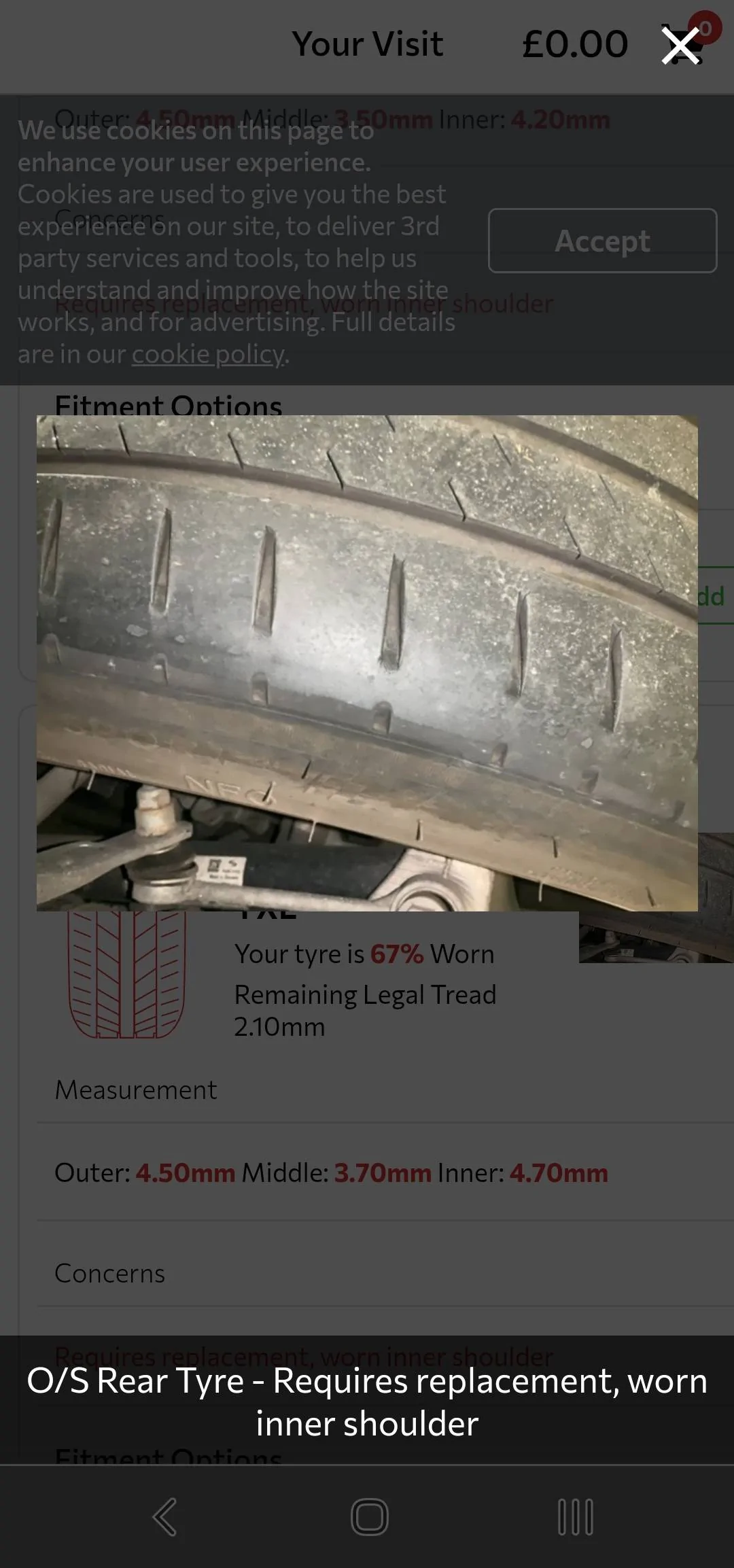

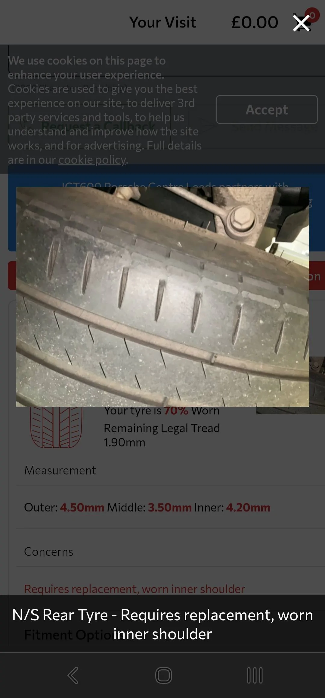

There was a separate recent thread on this.
https://www.taycanforum.com/forum/threads/taycan-problem-potential-catastrophic-tire-failure.16788/
Quite a few people with the strange inner shoulder tyre wear across different Taycan models and tyre brands.
Mine was one. RWD and I drive quite sensibly.
I'm not too bothered, as I got 16k miles which is acceptable for a RWD car (Michelin PS4) - but the wear was very strange and only got flagged as it went in for service.
