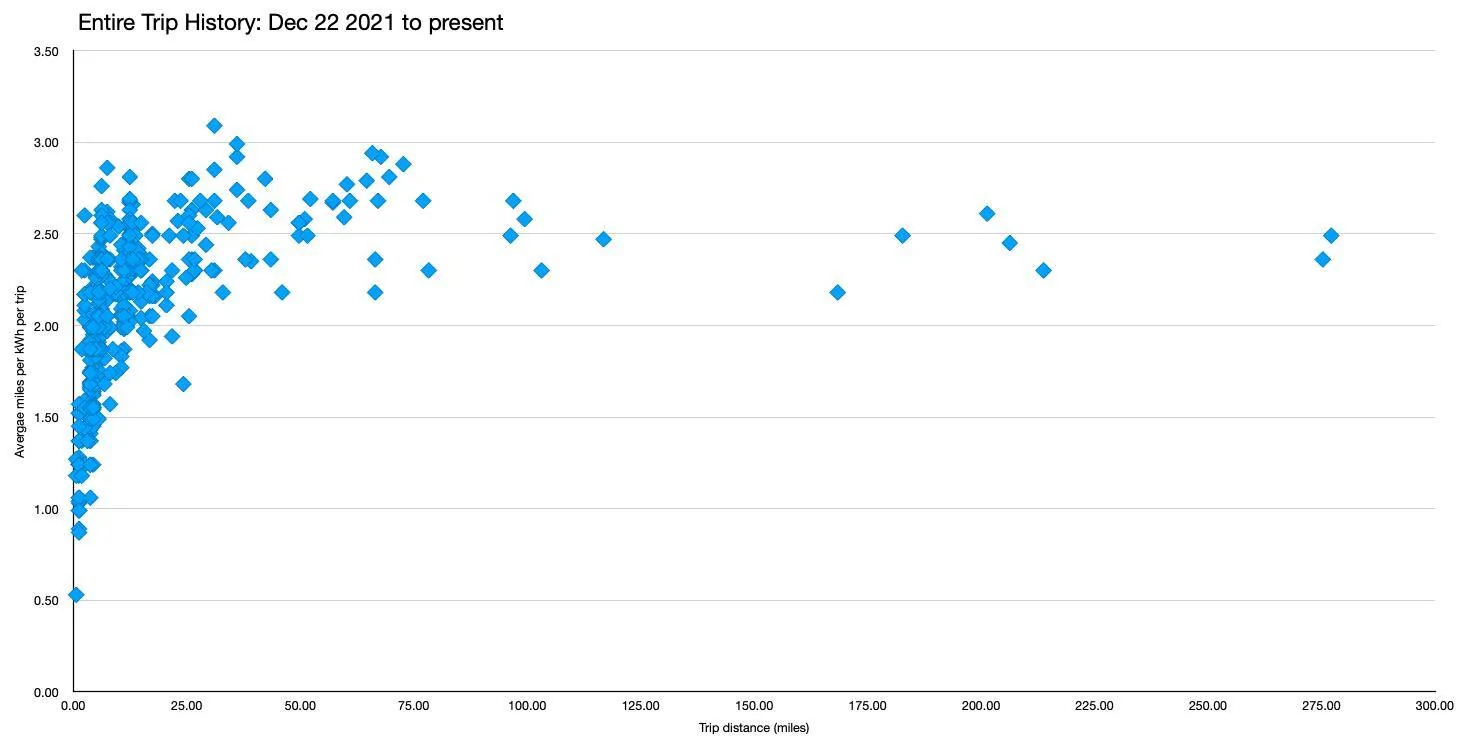

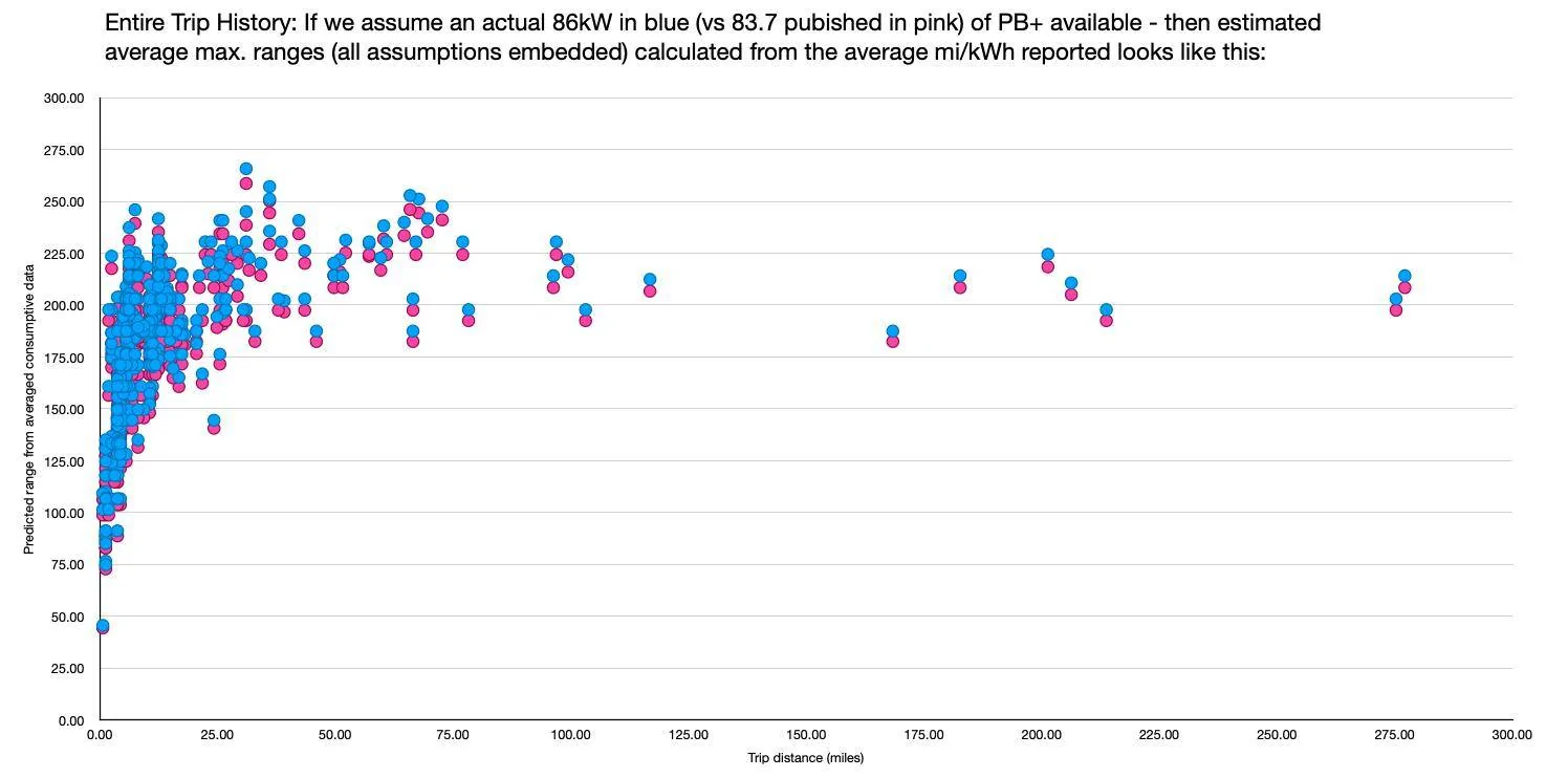

Realize you ay have a genuine battery condition issue but thought I'd share with you some of the data I've plotted for my car since picked up in late Dec 2021 for comparative purposes - consumptive (mi/KWh) data as provided by the PCM/MyPorsche app/Web site (itself being averaged for each trip) and a plot where i have recorded every charge the car's had in 1.75 yrs of ownership to date.
Suffice to say that as the majority of my trips are very short in and around Houston, the efficiencies or resultant mi/KWh and both calculated and 'predicted' ranges vary enormously.
That said I can however 'routinely' with only a slight variation in my driving style and/or trip length and/or charging cycles get back to decent 'guessometer' range predictions which as we know are totally dependent on recent driving history etc. - but perhaps the key difference to your situation. Just a ref case you might wish to compare to albeit from a 4S and not a Turbo S etc.
Aside: Note that for this year I have yet to attain the max. PCM predicted ranges I saw in the Summer-Fall of 2022 but still time before I can say anything definitive about that (suspect declingin Soh part of the answer) - however I definitely drove less long range trips this year which would impact that and the brutal summer (esp 3 months if insane evening temps) we've had has not exactly helped my overall HV battery Soh (very hot climates being possibly the single biggest detrimental impact on Soh preservation).
Plots 1/2:
Consumptive data reported by the car - of course again thee mi/KWh are averaged for each trip i.e. we do not get to see the min-max for each average:
Quite a large range in the data as one might expect - very crude data 'dump' i.e. simply plotted in order of occurrence and same for the 'calculated' range estimates based off these mi/KWh reported:

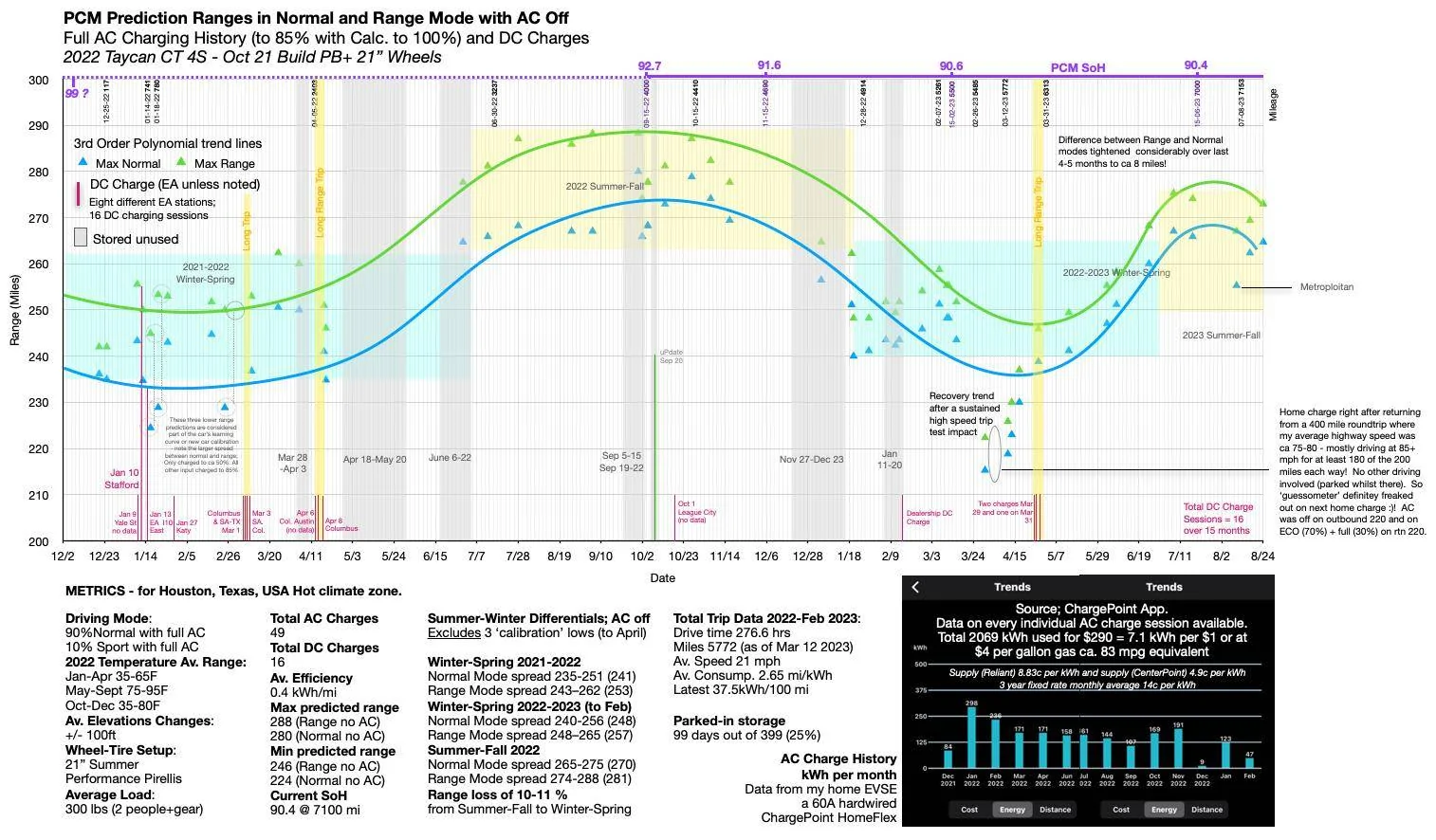

Plot 3:
AC and DC charge history with clear impact of seasonal prediction of max. range (for at home charging calculated from an 85% charge in Range and Normal mode with AC off).

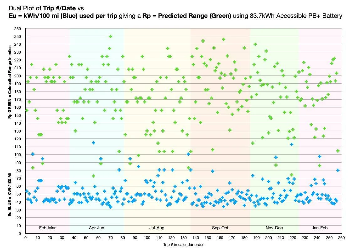

EDIT - bit of overkill but forgot I had this older post too (I might edit this a bit if I had more time but good enough :)!
____________________________________________________________
Old post:
This chart uses reported kWh/100mi or energy used (Eu) in blue to calculate a predicted 100% battery charge (actual 83.7 kWh) range (Rp) in green i.e. of course this assumes constant level of efficient/inefficient energy draw from the battery:
Porsche Taycan Taycan Problems are overwhelming an otherwise great car Screenshot 2023-08-28 at 8.11.07 AM
So Rp = (83.7/Eu) x 100
e.g. 37.7kWh (my latest Eu number) would give a calculated range of 222 mile range. This is 23.6 kWh per 100 km.
a 60 kWh draw would give a range of 139 miles or in metric 37.5 kWh per 100 km.
This method of calcualting the range is of course biased towards extremely inefficient short trip data (based both on driving style and on my trip length-duration data). The predicted range data (green) calculated from the recorded per trip kWh’s used (blue) go from as low as 70 to a high of 250 miles with the bulk of the data between 160-220 miles. The longer range predictions here (230-250 miles) are clearly tied to the 10 or so longer (over 75 miles), more efficient trips and the chart just re-emphasizes that trip length and driving style have a fundamental control on any ‘predicted’ ranges whether based on the PCM post-charging calculation or as in this case derived from kWh per trip data and remaining capacity of the available 83.7 kWh battery.
The bulk of the ‘predicted’ ranges here are very low but these data must again be regarded as a more pessimistic use scenario i.e. they are based on scenarios which assume I would continue to drive very short distance/duration trips at low average speeds in Normal Mode with full AC for a full 83.7 kWh usage. The key point here being that you should not consider short trip derived range predictions as any useful indicator of your car’s ability to do far better during long range driving.
I can fairly confidently state that in my usage case that the combination of trip length and driving style are the principle variables controlling my range predictions vs impact of weather, terrain, load etc., as I have driven the car near 100% of the time with other parameters essentially fixed - they being:
