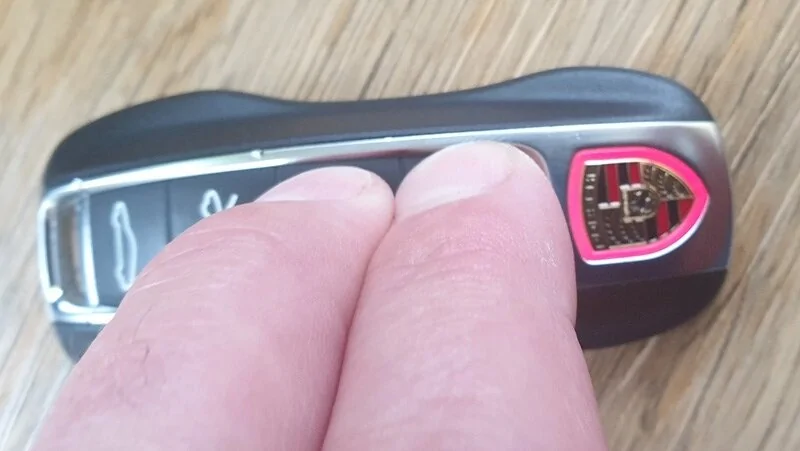

I actually take my key out of my pocket when I wash my car for exactly that reason :) Was too annoying to deal with the frunk popping open all the time.
A few seconds press the buttons open and close at the same time, the key light comes on. The key is deactivated until you press any button again.
