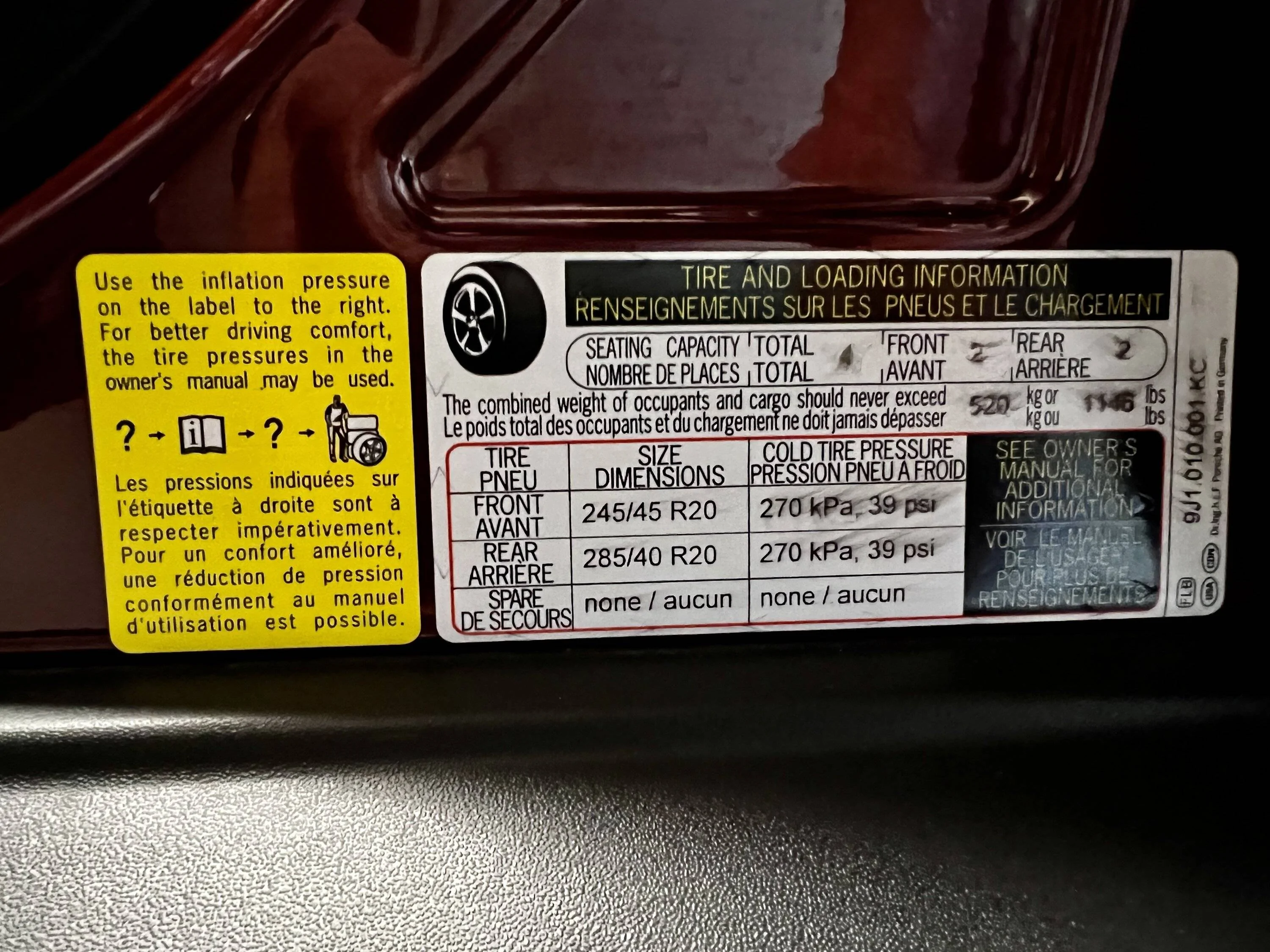

I had a concern about tire pressures on the door jamb sticker and the dealer corrected me.
Door jamb says 45psi.
I inflated to 45psi and the pcm noted the deviation to be somthing like +8psi front and +6psi rear. When I inquired, I was told door jamb is references max psi for when the vehicle is fully loaded. Oddly, the recommended pressure for daily driving cannot be found anywhere. I had to decrease the tire pressures until the pcm read no deviation.

Porsche provided an updated Taycan TSB for tires and recommended pressures in May.
See attached. I have not checked to see if these pressures match the PCM "deviations" display.
I have similar experience with my Pan ST. Door jamb says 41 front and 45 rear. At service, the dealer always lowers them to 36 and 39. Perhaps for the reason you state above…?

These pressures sounded really high to me as I recall from what I looked up last and read and run on mine-
RWD, 21" Mission E, partial load summer tires- 35 front, 36 rear. Tires are wearing really fast but very evenly.
Many thanks.
These pressure numbers seem to match the "PCM-recommendations" for my car, at least when selecting 20" summer tires in the menu.
