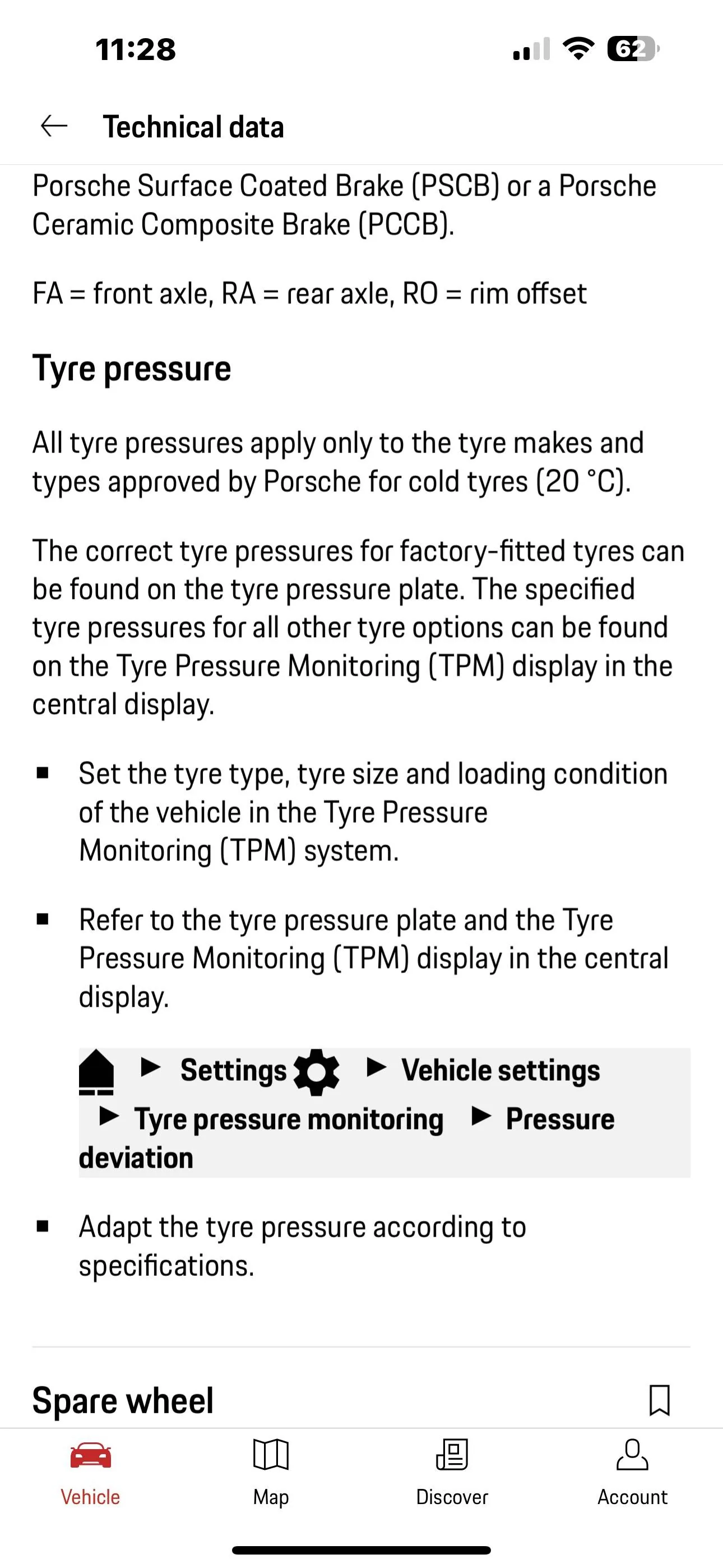

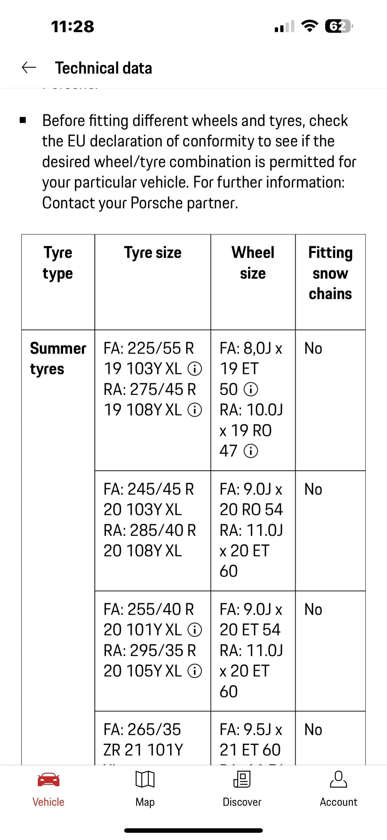

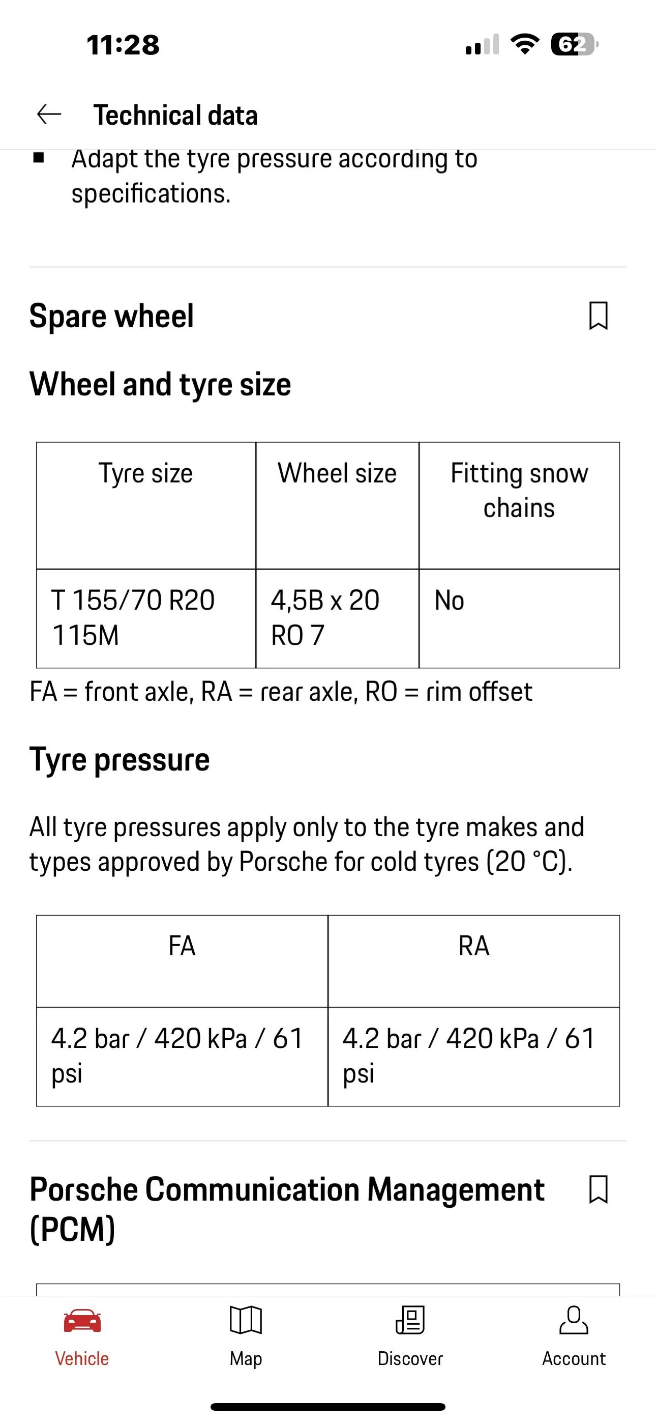

There is lots of detail in the Technical Data section of your manual. Go to My Porsche -> Manual -> Technical Data -> Wheels and Tires. There, you can look up recommended pressures for your specific Taycan model, wheel size, tire type. The pressures there assume you have NF0 tires, of course.
Tip: Navigating to the technical data section didn't work for me just now. Workaround: search for "Technical Data" in the electronic manual search, and then go from there.
Again that is region dependant it seems. I have the following info available in the app manual.

Only pressure stated is for the spare wheel, which the car does not have! ??

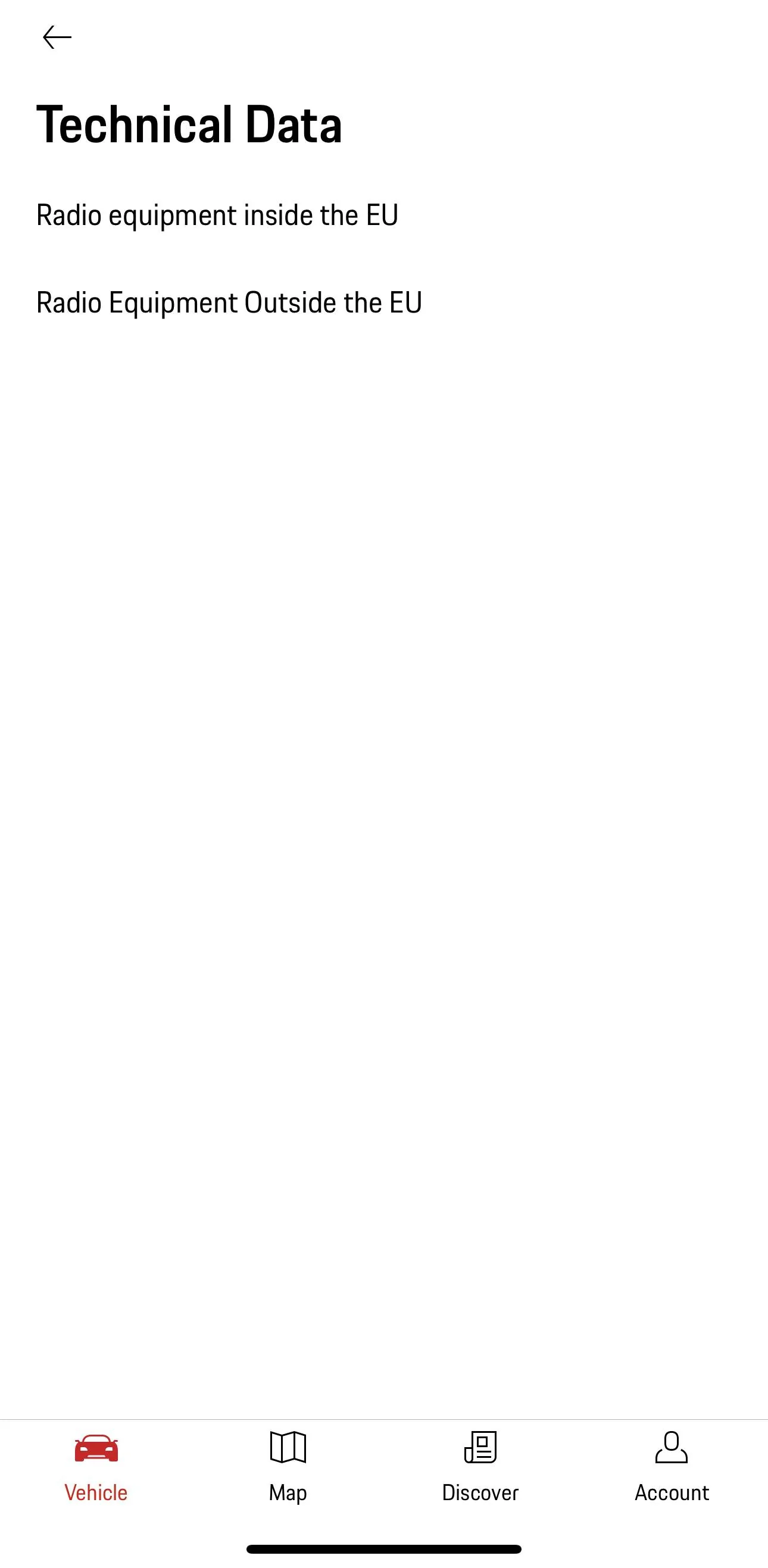

There’s absolutely the square root of F all in the Techical Data section here. Well only about the radio….
“Tyres and Wheels” is listed under “Mobility and Minor Repairs”.
