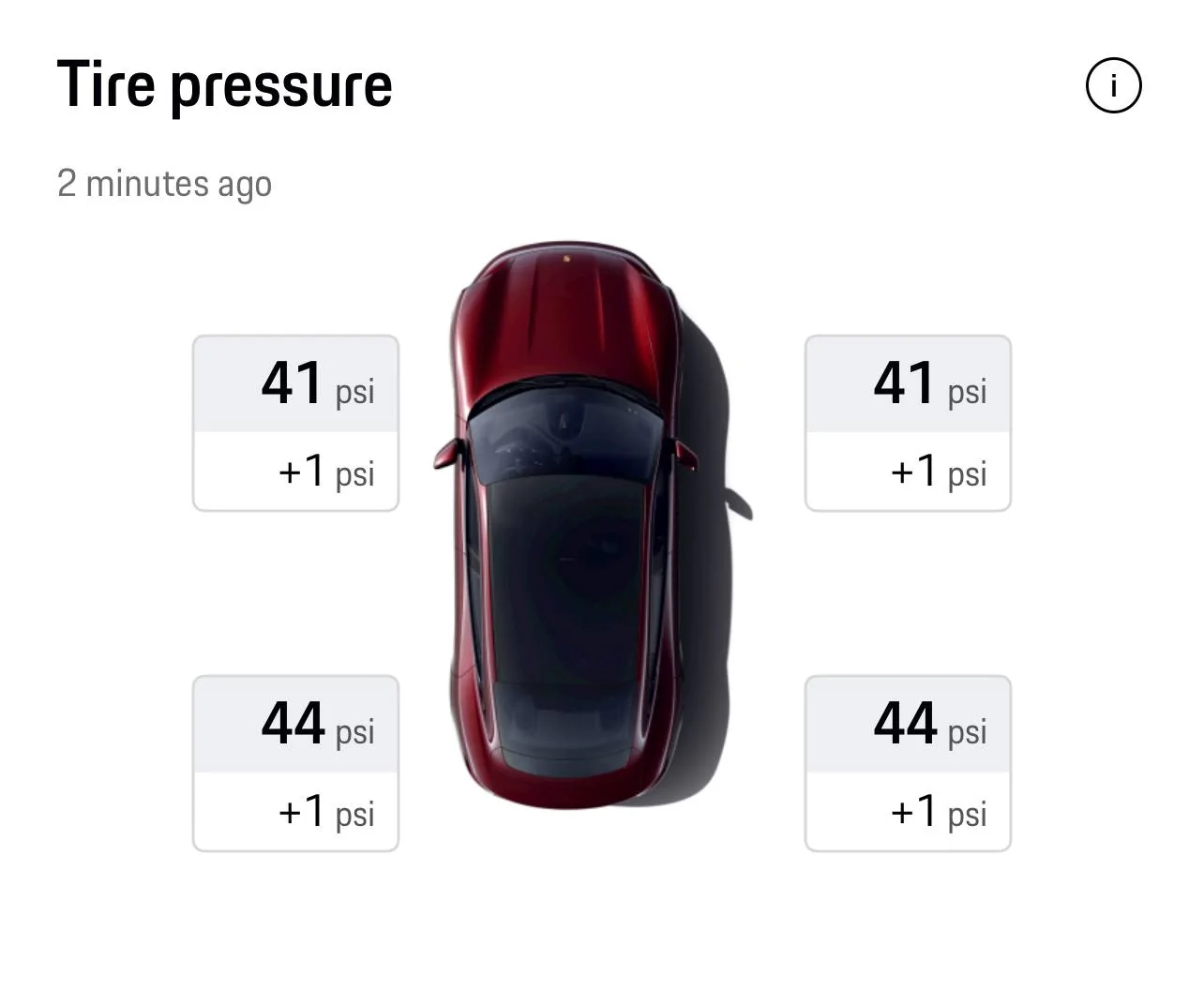

My 25 Taycan 4s has 21” wheels. Dealer had 38psi on all 4 tires when I purchased it. Ride was amazing with 38psi.
I noticed the label on the door says 41 psi in front and 44 psi in the rear, so I added some air to match this on all tires. Now the app is saying I may have over inflated the tires. What am I missing? See attached photo.
Porsche Taycan Tire pressure question IMG_0163

PCM was set to partial load (40 psi front/rear). There is also a setting for full load (41 psi front, 44 psi rear). So the app is basing +/- based on this setting.

I am still little confused. If 41 and 44 psi are correctly rated pressure, why does the car say all 4 tires are +1? May be I am not understanding these numbers.
When the TPMS was run the tires were at 40/43. During the drive they heat up, and +1 is the delta recorded.

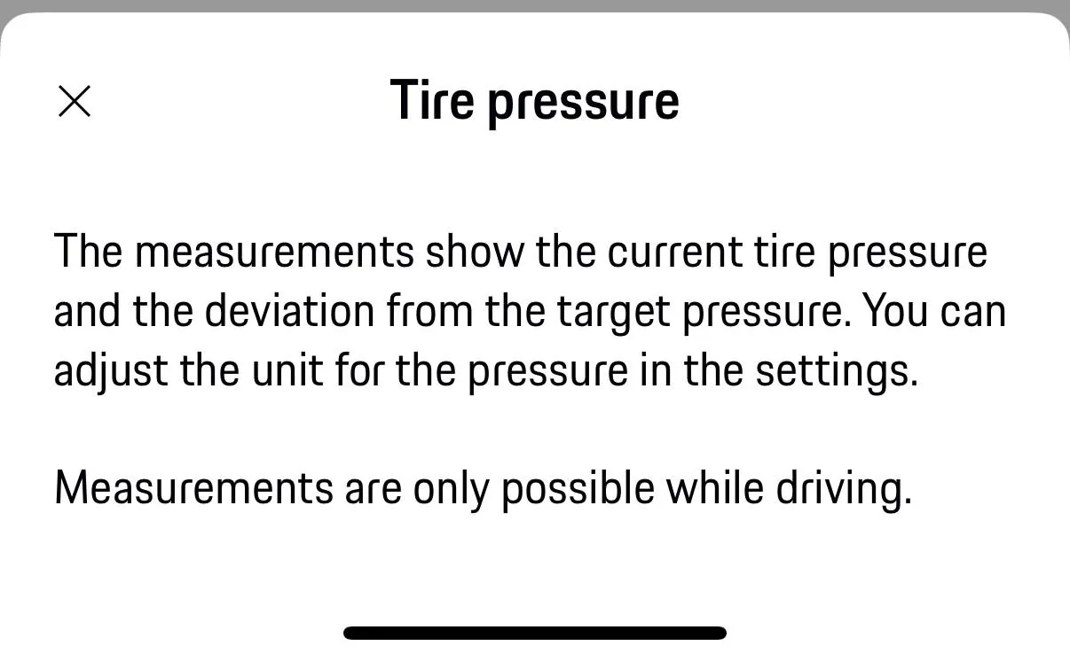

According to the app, psi shown are the current measured psi and number in the parenthesis are the deviations. So according to the pic, 41/44 are current psi and the rated psi must be 40/43? Thus (+1)?
No big deal, just wanted to understand how this really works.
Porsche Taycan Tire pressure question IMG_0173
