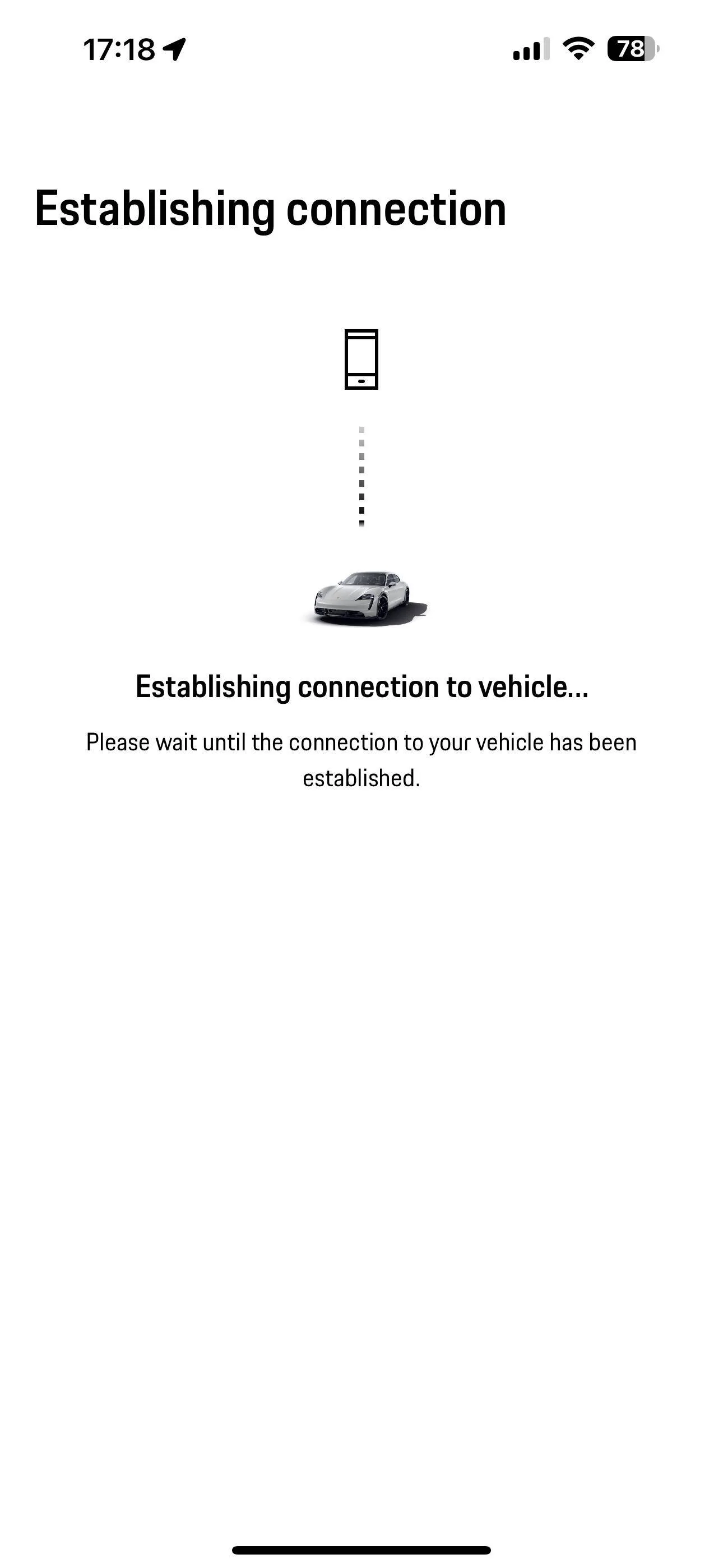

Posting here because it seems related to the app update. While it s faster and has an improved layout, it broke the remote parking feature. Specifically, it broke the connection to the car. It stopped working right after the update. It shows “no connection“ for 3-4 times, then it hangs on “establishing connection” indefinitely. Everything else seems ok. Has anyone with remote parking experienced the same? Thanks
MyPorsche 10.0.1 has just been issued. It's a bug fix release. Please report back if it fixes the remote parking issue.
Thanks. just updated. I will try again in a few hours (who knows why I have a strange feeling.... :)
I just updated to the latest and tried it. Didn't work. Still hangs when trying to connect to the car. I also completely deleted and re-installed just in case. That didn't help either. ?
Confirmed. In my case it no longer even tries to connect to the car, simply says "vehicle not reachable" while showing all the other updated info (e.g., state of charge, windows, pre heating, etc) ie the vehicle is in reality connected . bunch of German amateurs (in the negative sense :))
