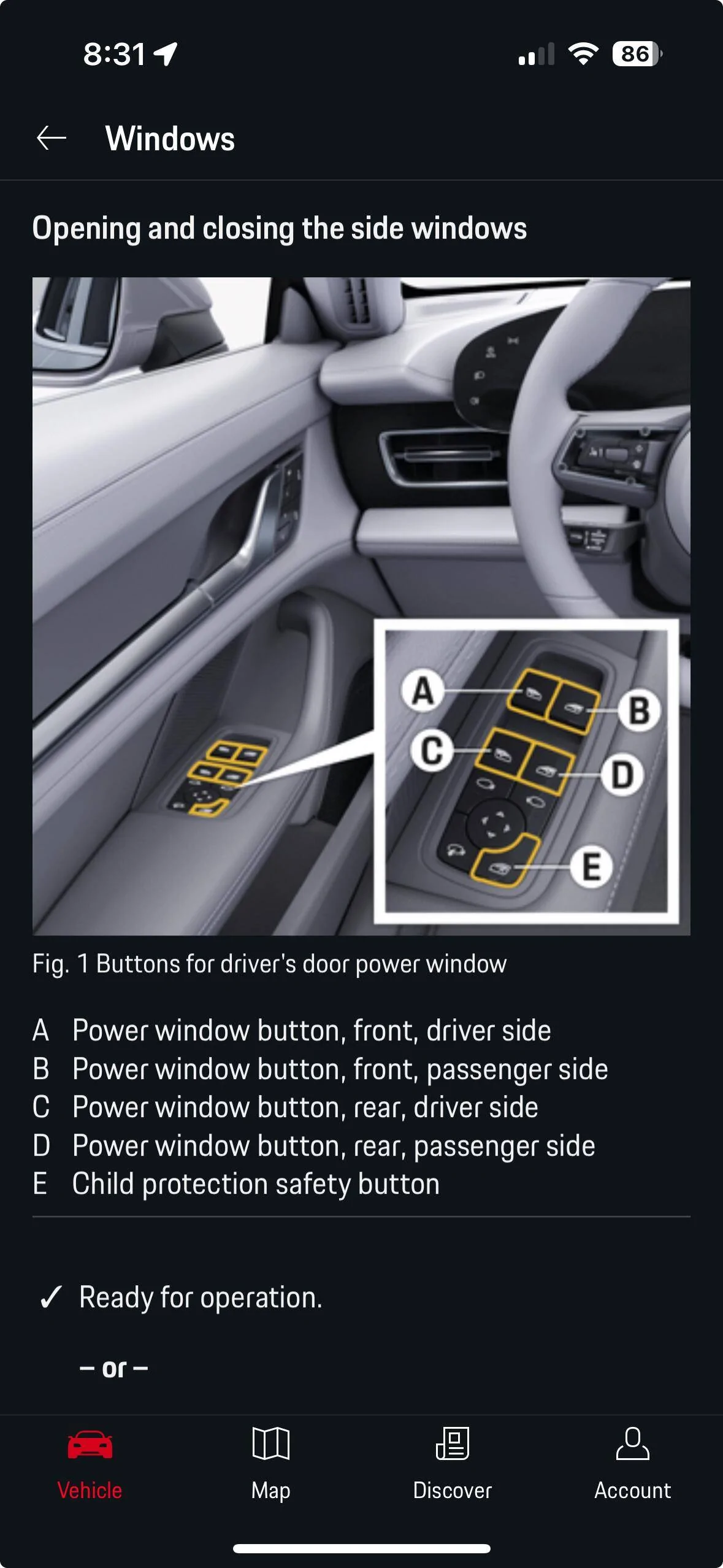

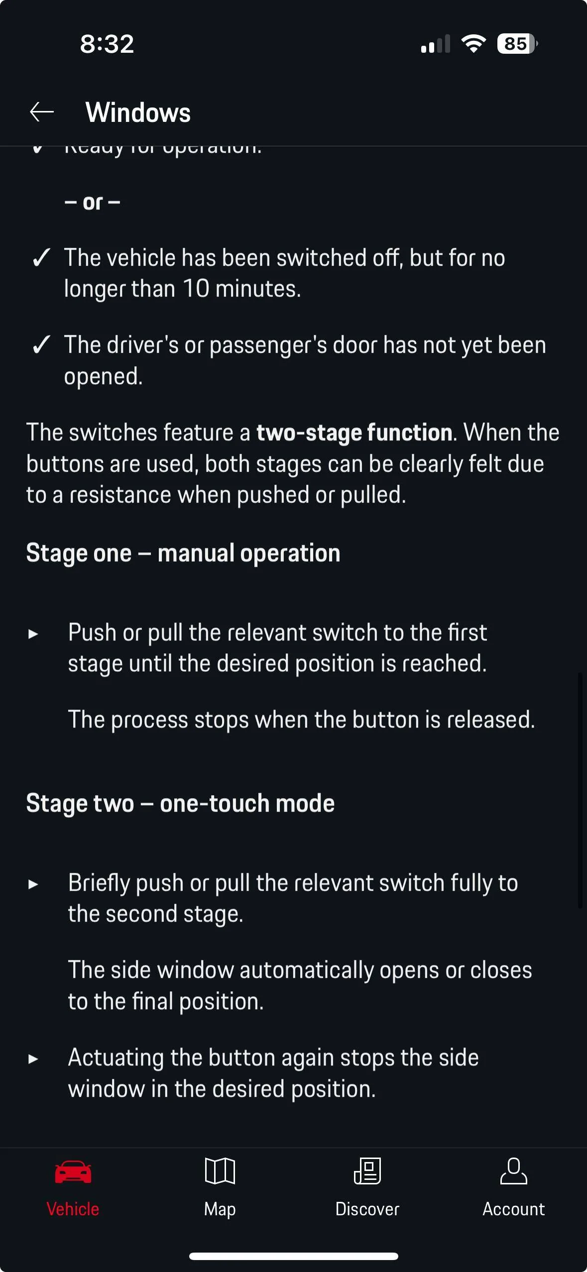

This may help (or not ?). See the three screenshots of the My Porsche mobile app on the page "Opening and closing the side windows".

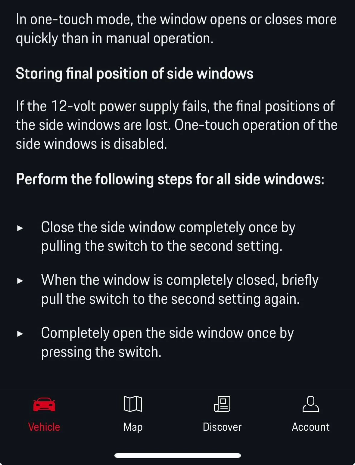

The information of interest is on the third page - "Storing final position of side windows". This refers to the situation that can occur (probably during a service visit) when the location of the side window is "lost", disabling the Stage two - One touch mode.

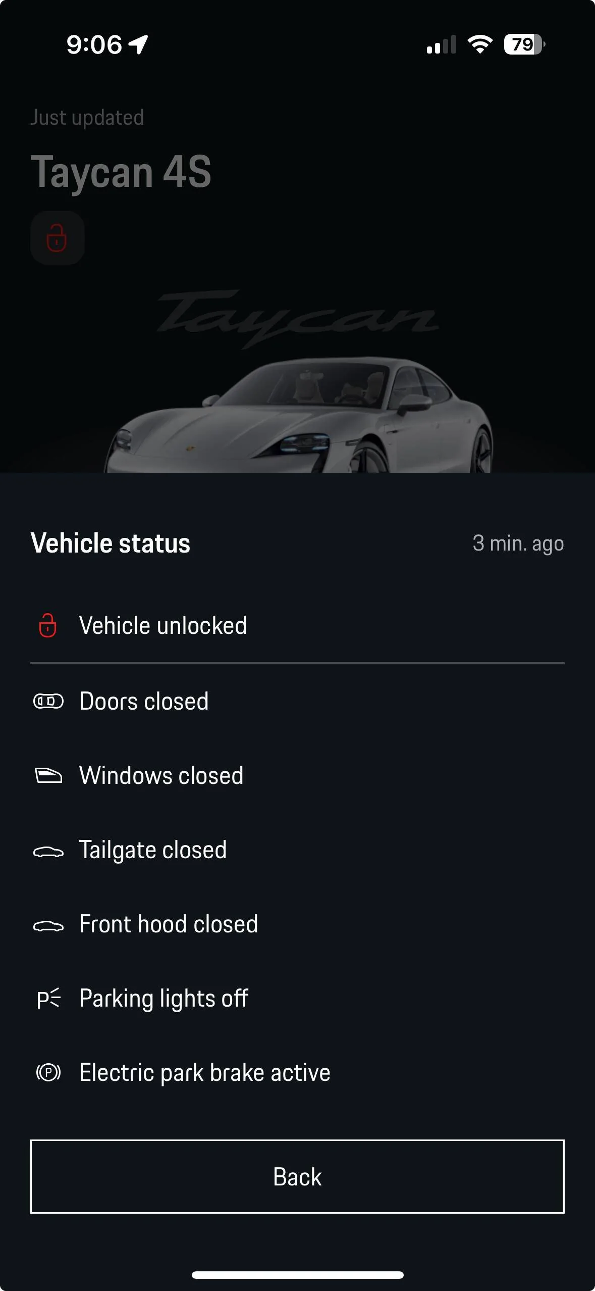

After dealing with the "Left/Right Rear Window" unlocked message, I tried following the instructions by following the last 3 bullets on the third page. The key appears to be the second bullet - pulling the windows switch up to the second setting - to signal to the car that the window position is Closed.
As I walked away from the car I checked the Lock Icon status in the My Porsche App and it changed 2-3 times before stabilizing as shown below. I think it was picking up the status from me opening the car (Left Door Open), then eventually it showed all the windows closed and the car itself unlocked (I don't lock it in the garage).
Porsche Taycan [Updated] My Porsche App updated w/ new interface and functions Screenshot 2024-01-29 at 9.06.16 PM
I have no idea if this will stick or not, but I'm encouraged. Good luck!

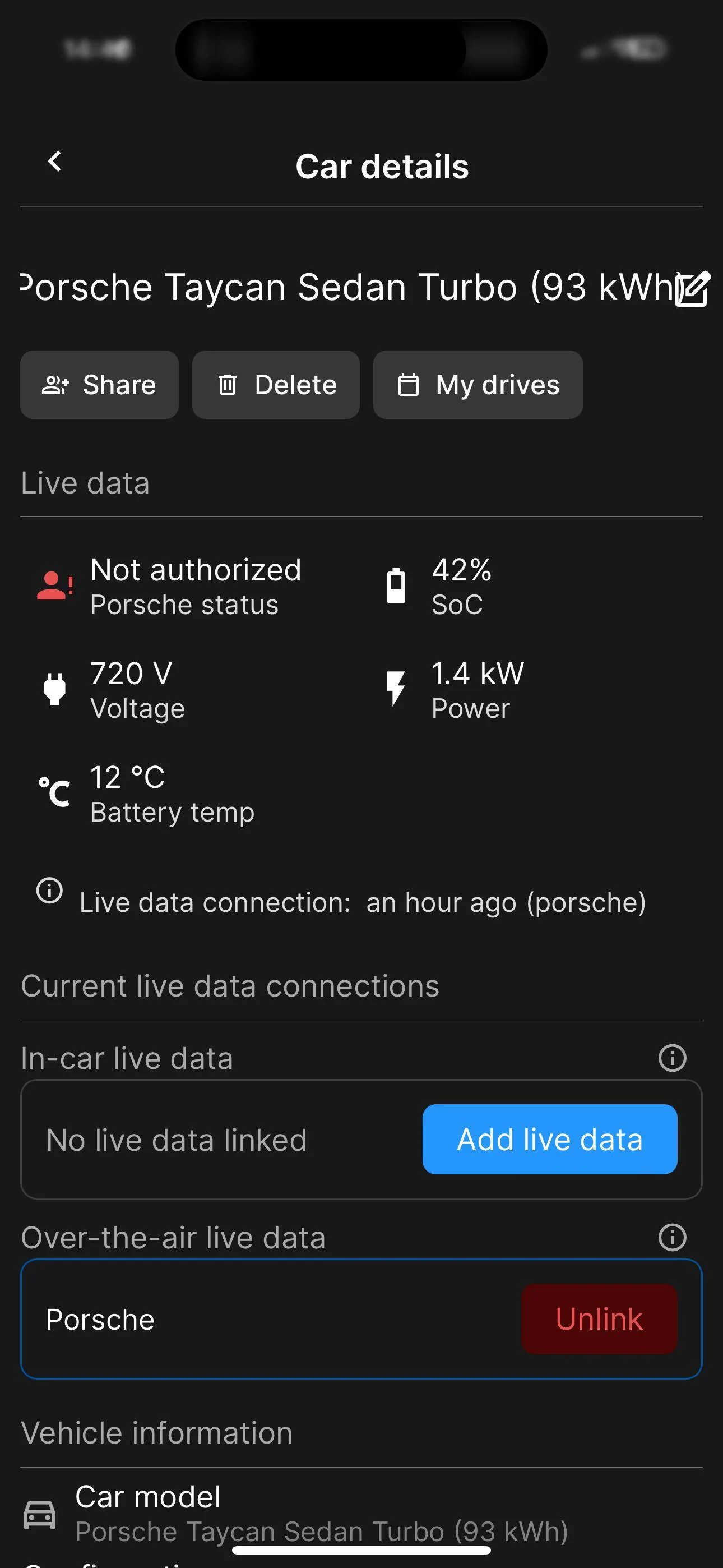

I have also quite av]curate predictions from ABRP now that my car is linked via the Porsche site. It has also been quite accurate predictions.
Could you explain what "now that my car is linked via the Porsche site" means in regards to using ABRP?
What is being linked via the Porsche site?
Using ABRP for planning, or for in-route guidance, or ?

What I mean is that ABRP is linked with my Porsche account and then gets my charge level automatically. And I believe it also adjusts the consumption figure that the algorithm in ABRP uses. That way I get quite accurate predictions of charging levels depending on time of year etc.
Here is a screen shot of the link between ABRP and my Porsche account.
There is some delay for the data to update, it is not completely live data. But the delay is minutes only so no problem when driving.

I agree that it is goofy that a user has to reset the "closed state" of a window after a 12V battery disconnection. That extra pull of each window switch to the second setting should not be necessary. Bad design decision on Porsche's part.
But.... At this point I just hope that the reset holds and that I get good info from My Porsche about the state of the car going forward.
