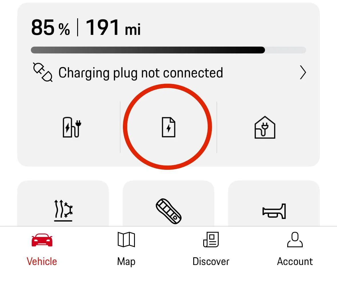

Charging records for DC and offsite charging are in separate spot from charging records from your own EVSE.
  • Click the center icon in history to get offsite charging records.

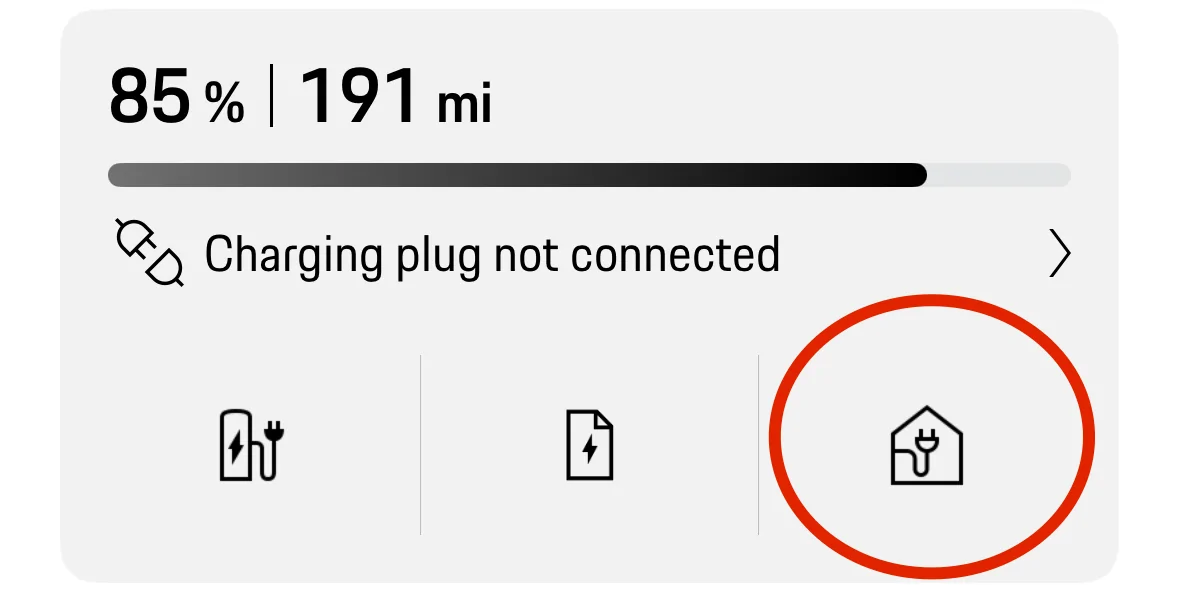

  • Click the right icon and then scroll through the EVSE devices to see charging at home

Apologies upfront if you were already aware of this!

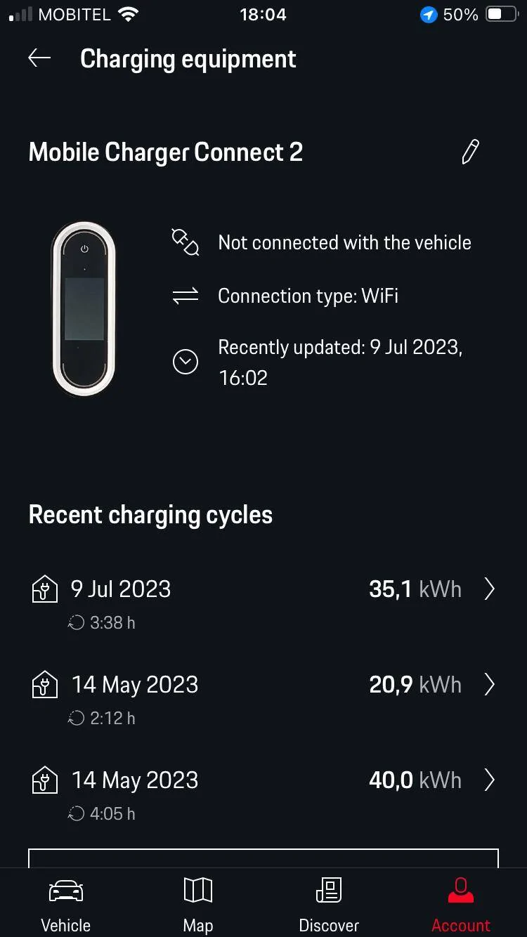

Thx, but I knew that.
There are no DC records at all.
Speaking about AC…as I said last record dated as July 2023.
Porsche Taycan [Updated] My Porsche App updated w/ new interface and functions IMG_2095

I would check to see if the PMCC is connected to the Internet?
Check on the display of the PMCC to see if it is connected to WiFi and also the cloud symbol.
Log in on the PMCC directly as well to see what the status is.
I think you have lost the connection between the unit and Porsche servers?

I am not sure I fully understand you here?
If you have no WiFi signal where the car is parked, is that also where the PMCC is placed?
I thought the PMCC needed WiFi or PLC to communicate to the Porsche servers?
Porsche do this different then Tesla. With Tesla all the charging sessions, AC or DC are recorded by the car. But for Porsche you rely on getting the AC charging through the PMCC and the AC and DC charging via Porsche Charging services. If you for instance charge at a Tesla Supercharger, you will not get any charging record in the account. Any AC or DC charger outside of the Porsche charging service will just not register. Unfortunately!
