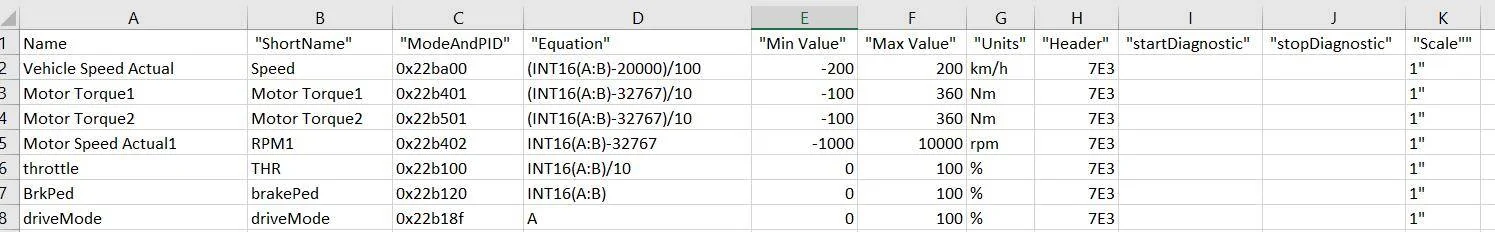

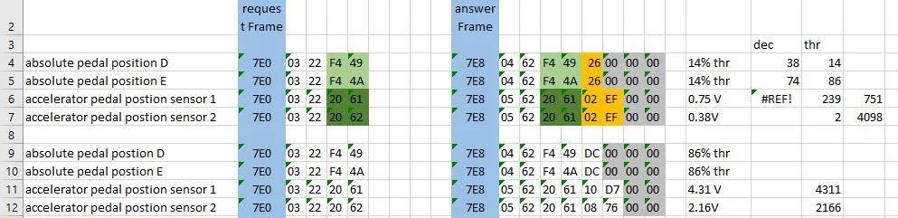

ok I see. I'll do that. in the meantime, I used y-cable and Carscaner. this is summary what I could read for throttle:
Porsche Taycan Using Car Scanner App to log, understand and diagnose Taycan throtlePID

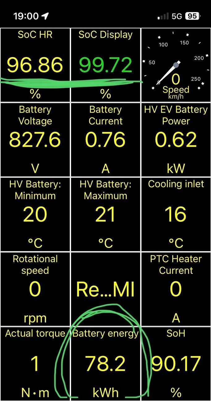

hello,
There are 2 SOH in our Taycan.
1, compares between de max capacity of the battery and de max 100% car capacity.
example max range battery = nom cap 93,4 KWh
and useable cap by 100% charge taycan = 83,7 KWh (safety margin Porsche) 83,7/93,4 * 100 = SOH 89,61% theoretically.
2. The real SOH of your car.
read with the OBD scanner by 100% charge the real battery capacity ( new car = 83,7).
so 100% charge cap of your car/ max new car * 100= SOH %
Example:
my Taycan 42..000Km 22GTS 78,2/83,7*100 = SOH 93,42%
