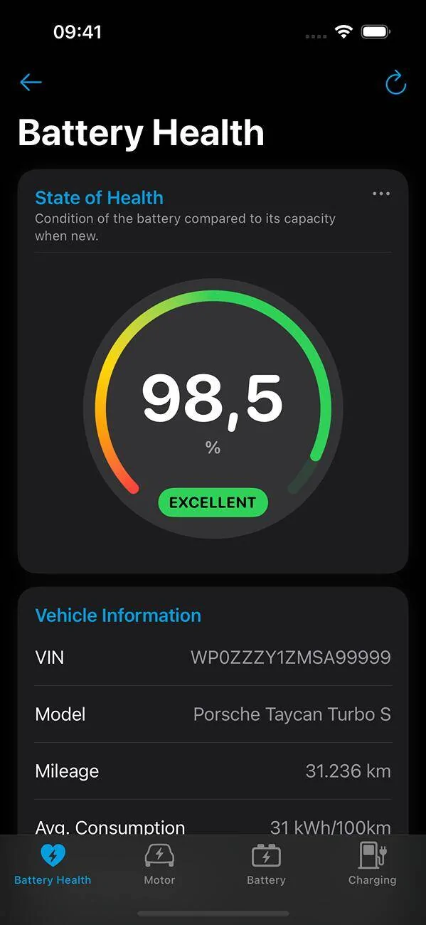

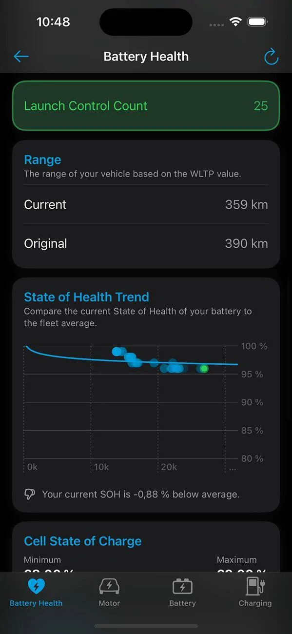

As an alternative for checking your battery’s SOH, you might want to consider using the eFlow app (for transparency: we developed the app).
It allows you to compare your SOH to the fleet average, gain insights into other metrics, and track changes over time. The battery health data is automatically exported into a CSV file, which is accessible through the iOS ‘Files’ app.
You can check it out here: https://geteflow.app
Please feel free to get back to us with any feedback here in the forum or contact us directly.

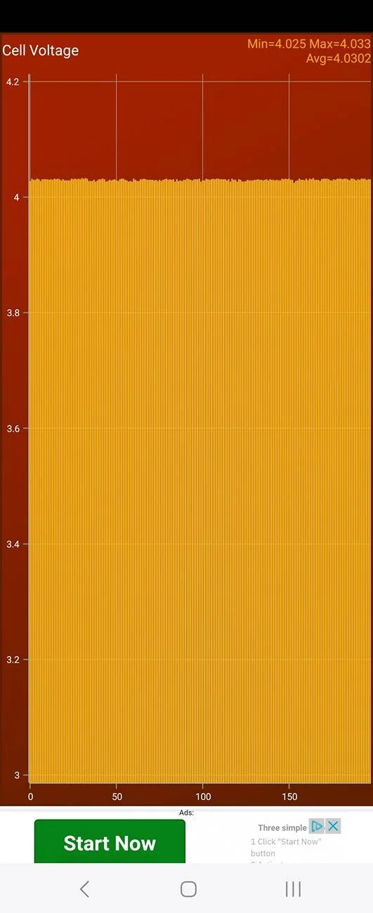

I just tested on a MY2025: the battery reads 0kWh.
Most other functions read just fine, I looked at battery cell voltage and they came up:

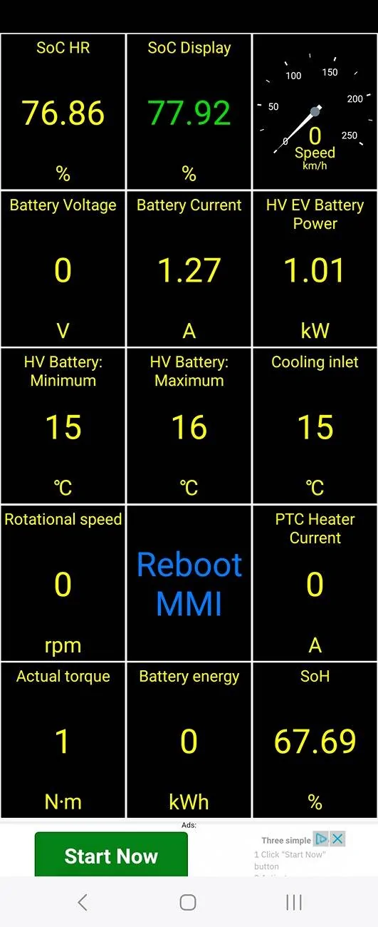

Thanks, what reading did you get for battery SOH?
Speuk
Simon
May 6, 2022
1,153
619
Something strange: SoH is 67.69%.
SoC is correct at 77.92%
Yep, mine is 67.564% Clearly it is not reading the correct information. Mine had a a new HV charger fitted prior to delivery and OPC did a full diagnostic check and re coding. Their flash SOH reading was 98.4%
