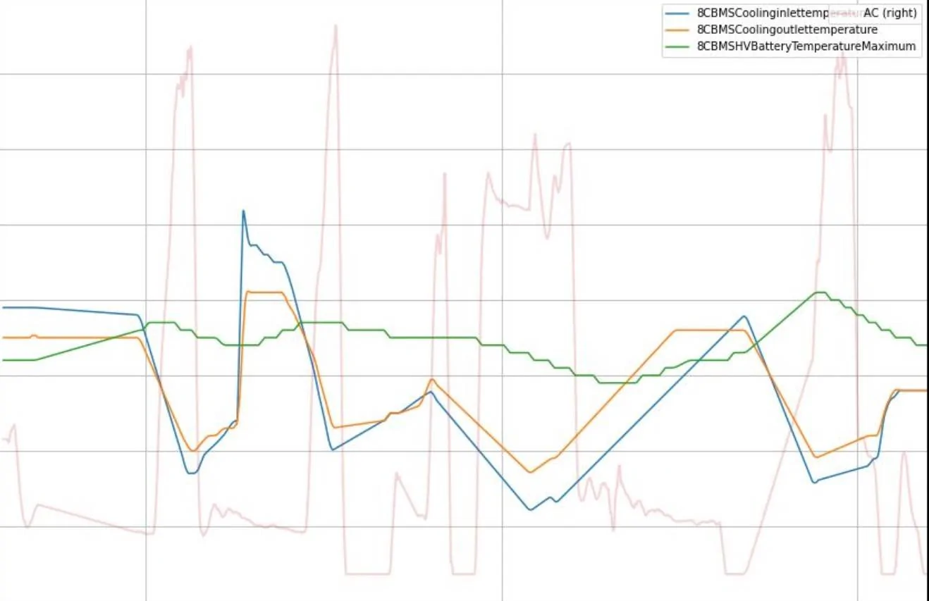

https://play.google.com/store/apps/details?id=com.ovz.carscanner
https://itunes.apple.com/app/car-scanner-elm-obd2/id1259933623?mt=8
Pro Version is not a must, but worth it, no ads and the ability to export logs to analyse further e.g. with Jupyter
This is one of the better known OBD2 apps and I helped the author with making it work with the Taycan and provided some reverse engineered diag channels (some call it sensors or PIDs).
I tested at least 5 different dongles, BLE Dongles are much easier to handle and must have for IOS.
please test it and share some impression, screenshots, data, bugs, ideas and dashboard designs!
short howto:
in settings, choose your BT device, then select Porsche, Taycan profile and ready to connect and play around.
latest find of some error codes that the app cannot translate:
https://static.nhtsa.gov/odi/tsbs/2022/MC-10215441-0001.pdf
