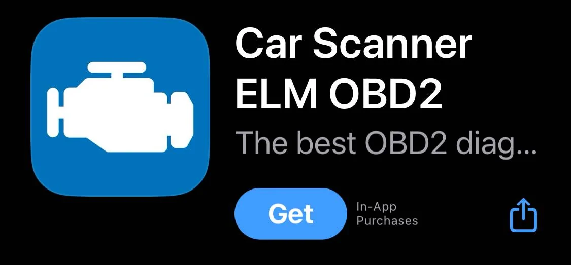

Just ordered the Veepeak OBDCheck BLE+ for delivery tomorrow. Do I need to download any additional apps to see the graphs you show for the battery cell data?
Thanks again for all your information & advice.
Hirschaj
Jim
Sep 5, 2021
68
2,227
2,626
Austin TX
Thanks for the heads up...
Download the CarScanner app
