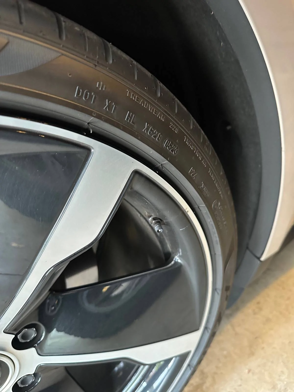

P ZERO 305/30 Z21
Performance summer tires on 21” rims aren’t going to yield the best range. Driving style will affect it greatly also. Trade offs.

Thanks, We drive very carefully. We don't push the car hard. My wife basically drives it around town with very little highway driving so I'm sure the fact we do mostly stop & go driving and on the highway briefly at times.
So does the car calibrate its range to the way we have been driving it for the last 3500 miles? We will only use it for a long trip to Las Vegas once or twice a year at the most and 4-6 trips to LA & back which is about 80-90 miles all highway per trip at 70mph to 75mph max.
Yes, projected range is based on available energy and driving efficiency (which is based on many factors, including tires). Not any different than an ICE vehicle.

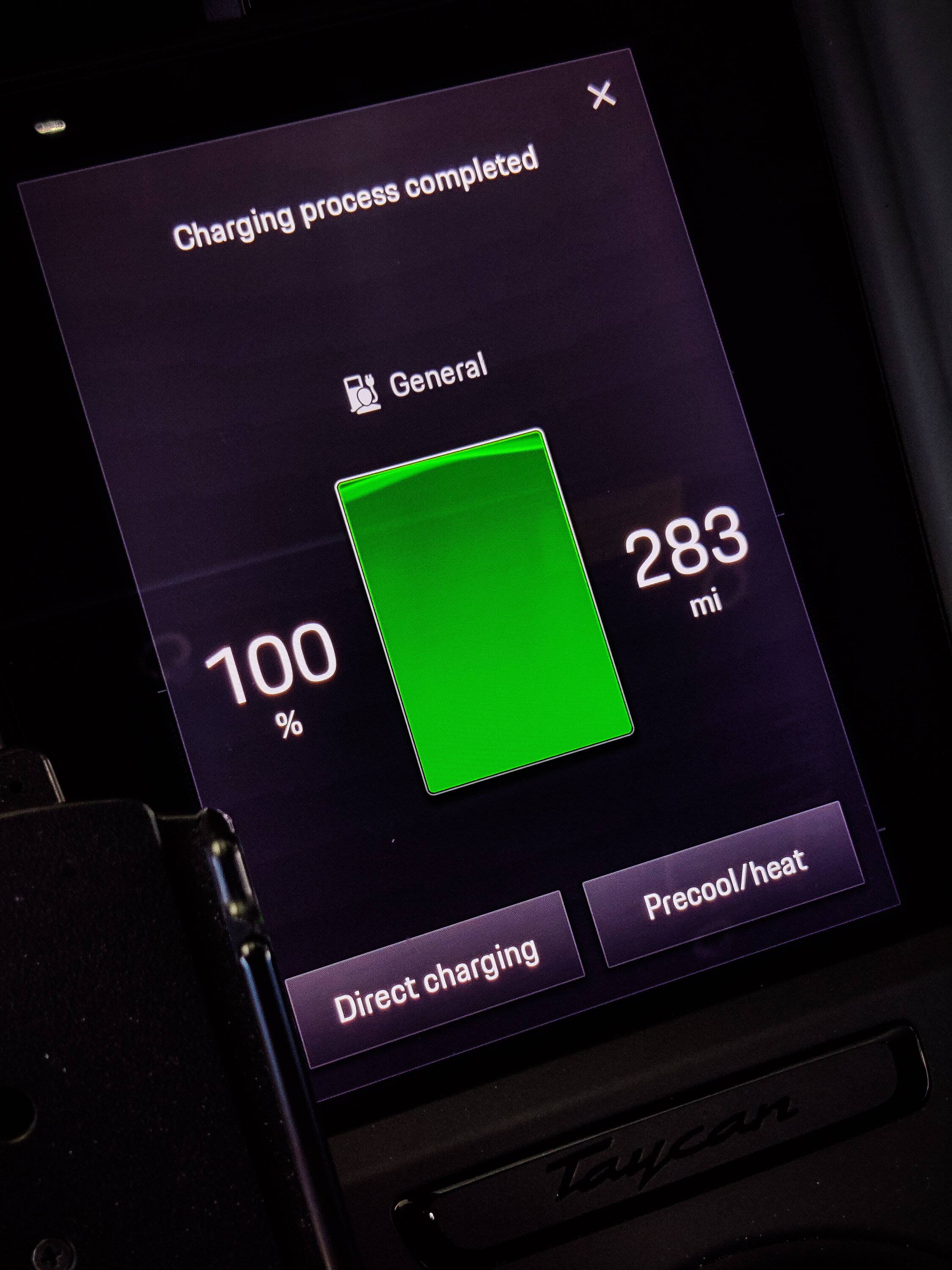

TLDR: how you drive and the conditions you drive in will determine what you see for range.
So what is my range? Safe to say "it depends". I left Florida 3 weeks ago with a calculated range of 276 miles at 100%, just over 10,000 miles (real world 250-260 miles). Flat terrain, low 60's F, generally sane diving. Arrived in NJ, 1,100 miles later with a calculated range of 228 miles at 100%. So my range dropped by 17%. Drove mostly on Route 81 through the mountains of SC, NC and VA with steadily dropping temps at higher speeds than normal. I felt like I had a comfortable real world driving range of around 170 miles (can't realistically charge to 100% and certainly don't want to go below 15% given the charging infrastructure). But ... State of Health and battery capacity are essentially unchanged at 92.2% and 80 kWh, respectively (from Car Scanner). I'd love to panic and assume my battery is crapping out, or I've got a stuck brake caliper or, fill in your favorite Taycan malady, but I'm pretty sure it's the driving conditions and speed that are responsible for the reduced range being displayed. I'm assuming/hoping the displayed range will go back to my normal when temps go up and I'm not significantly over the posted speed limit. I will say that a usable range of 170 miles sucks as the conditions were not extreme. No rain or snow, no temps below freezing, no insane speeds. Hello Taycan .2 if the range improvement lives up to the advance billing. So just as with an ICE range varies.
