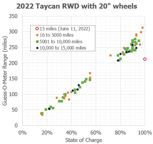

TXAG
Dan
Mar 9, 2022
540
537
Goodyear, Arizona USA
2022 Taycan RWD
Apologies for the late response, but I was out of town. Here's a chart of my data. I've had my 2022 RWD with the large battery for just over a year and it's approaching 11,000 miles (~16,100 km).
Great to see more data - very similar to the ranges I have plotted from my car's predictions (despite mine being a heavier CT on 21" wheels etc) - see this post in this thread #14 - I've also broken it down into seasonal impact on charge guestimations which are noticeable.
I love this graph. Single data points for range can be misleading by an unknown quantity, this gives a bigger picture and is more informative. As @ciaranob says, also seeing the seasonal variation is very nice. But the simplicity and richness of this one is highly appreciated.
But you have to note the range and SoC result of each charge manually, don't you?
ciaranob
Jul 3, 2021
3,547
2,640
My charts show all of this data and more so not entirely sure what you are seeing here that is different esp the ref to 'single data pts' as both charts contain these? In this case just a different way to display - for ref., my car's mileages/timeline are posted at the top of my chart, his color coded etc. This plot also does not differentiate range variation between winter and summer etc.
For example what's also missing from this chart is what was measured and what was calculated i.e. I'd assume (rightly or wrongly!) that he did not charge to 100% every time so was it to 80 or 85% and 100% range was then calculated as in my chart; are these all AC or a mix of AC and DC charging (I separate mine out in the same chart); also what was the car's mode when reading the predicted range, is this Normal or Range mode max. predictions etc etc.
Not a criticism - just depends on what level of detail you are interested in :)
I certainly agree that your chart gives much more data. It also takes more time to understand and glean info from.
The questions you have about calculated tor 100%, AC or DC, range etc for the simpler chart are also surely valid. Simplification makes you lose something (some of it could have been explained in text). In this case I like the simpler graph for what it does: show an overview and not all the details. I think that is an OK concept for a chart.
At other times, I appreciate the details and can then spend the necessary time on your chart to learn even more. So I think both types of chart are useful.
Yes. A lot of the data comes from my trips from my home in the Phoenix area to Las Vegas. The charge at home is AC and the rest are DC. I take before and after pictures of my dashboard at each charging station. I enter the data into my spreadsheet when I get home.
Porsche Taycan What is your Taycan Range after X miles, Let's get some data 1688053515444
Note how the guess-o-meter is affected by elevation change. Kingman AZ is 2000 feet higher than my home, so the guess-o-meter thinks I drive more miles than actual when going uphill and less miles than actual when going downhill.
Can you clarify as to when you read/have read your range 'guesstomates', what driving mode were/are you in and is the AC on or off? All these factors can add anywhere between 8-20 miles of addition guestimated range!
And yes there are many factors including terrain/elevation, temperature etc that do indeed have a direct impact on the PCM's calculated ranges.
Re spreadsheet, same approach :)
