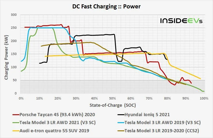

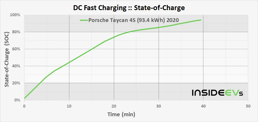

The 80% thing is not about optimizing range. It is about optimizing time spent charging. Sure, if there are no chargers in range of 80% SoC, then you will need more, but if you can get to the next charger on ~80%, then you are better to charge to 80% and stop at the next one with a low state of charge. The reason being that 10%-80% (i.e. adding 70%) takes less time than adding that final 20% (and the final 10% from 90%-100% takes longer than the 80%-90% too). Battery charging is not linear. When you start at a low state of charge (assuming a warm battery), you will be able to get up to 270 kW, but as the charge increases, the power level drops. By the time you get close to 80%, it could be down to 100 kW, and by 90% it will likely be down under 50kW.
Porsche Taycan Why US drivers may be thinking about EVs all wrong.... BBC article.... taycan-934-kwh-2021-dcfc-power-comparison-20210607
Here's the Inside EVs charging curve for a Taycan 4S which shows how much slower that 80%+ part of the process is compared to the first part. If you split your charge into two sessions from 10% to 80%, then that 40 minutes spent charging adds 140% of the battery as opposed to just 85% (if you go from 10% to 95%).
It is not immediately obvious, and is very different to the approach taken with an ICE car where you fill up at each stop to maximize range, but an ICE car refuels linearly.

That Taycan theoretical maximum charging curve has almost zero relevance to DCFC in New England (with the sole exception of the Magic Dock in Enfield CT).
I've experienced only relatively modest tapering during most EA sessions all the way up to ~95%.
And as the graph shows, the Taycan is pretty much maxing out the typical ChargePoint 62kW or the many 50kW chargers all the way up to around 95%.
