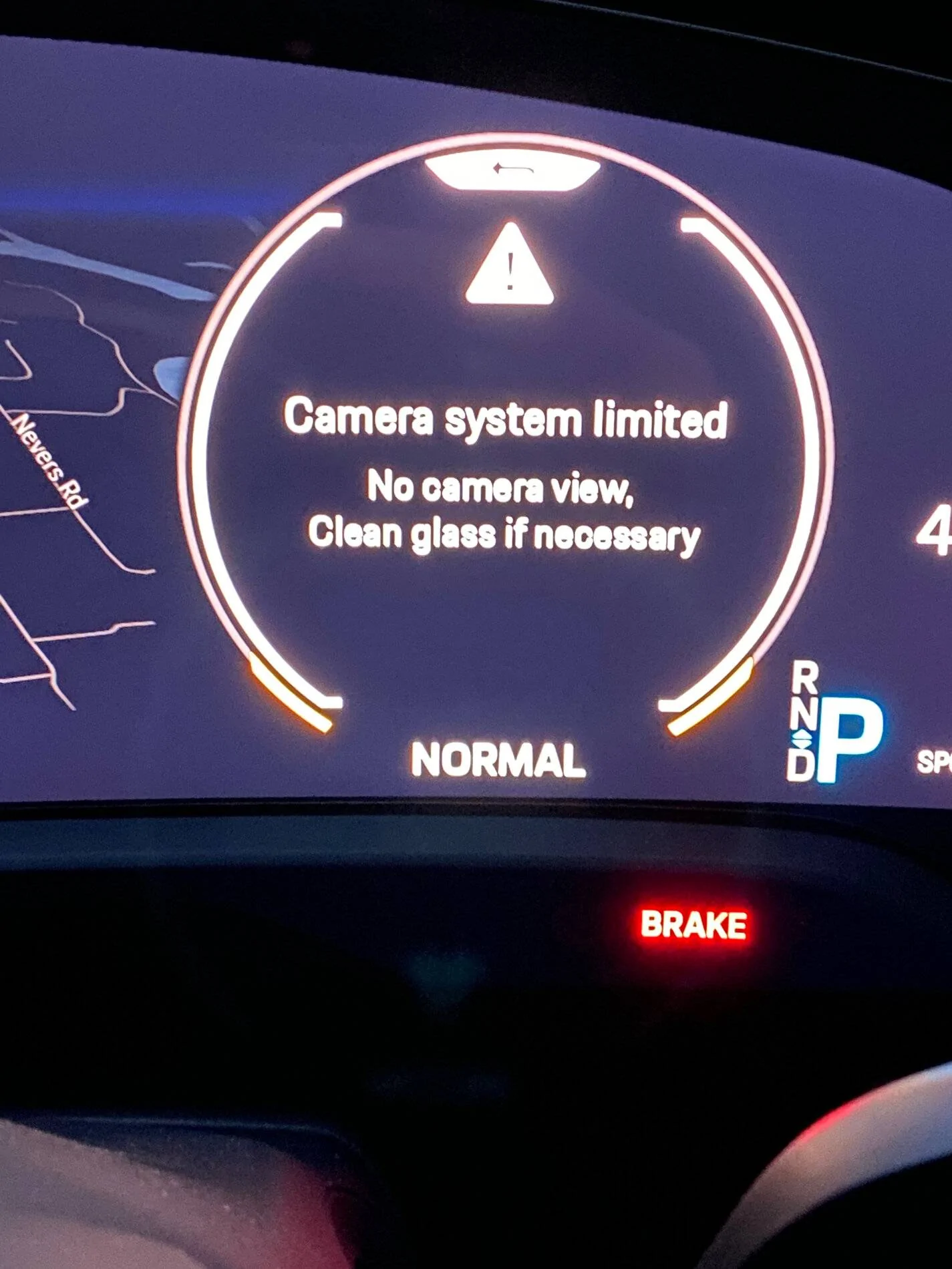

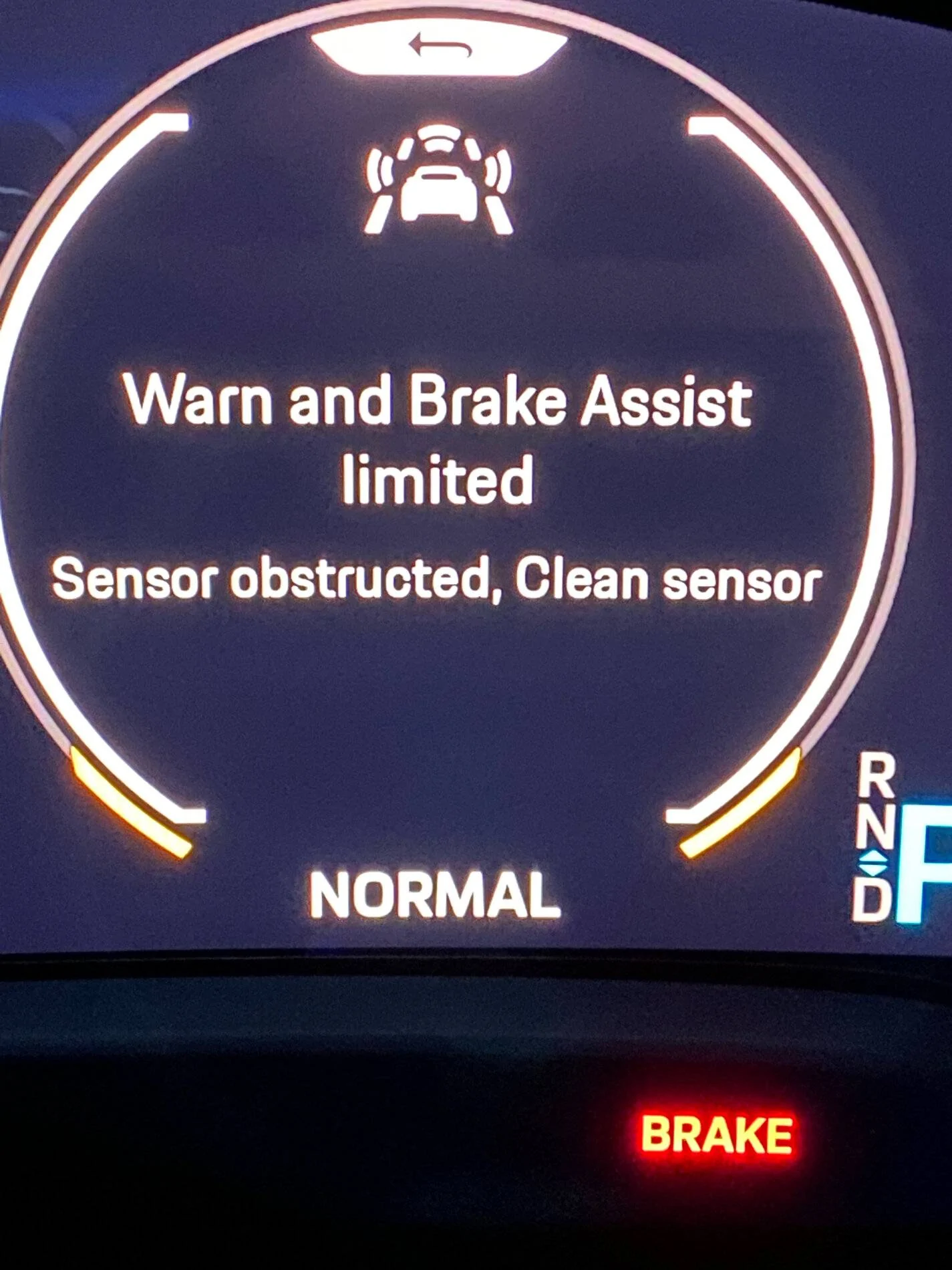

My 2021 Turbo has more bugs than I can list, but here are some:
AC noise, loud clicking/electronic typewriter sound. Was not there when I purchased it, but is now, and Porsche seems to think it is normal. No other Taycan I've been in has the noise and it is factually not "normal".
LCA, when it rains says the sensor is blocked, guess the car isn't made for the rain
My PCM changes settings all the time, with no input from me. Minor settings like upper right temp to time, or more major, logging me off while driving and putting me in guest mode (sometimes it will not let me log back on, I'm greyed out and will not activate), to the passenger display settings changing all the time, sometimes it is there, sometimes it is off. and don't get me started on XM radio, lack of antenna.
I've had parking light failures, which cured themselves, then returned. My side mirrors occasionally don't fold down, even if I depress the button to manually activate
Two days ago my car, on its own, switched to German then later back to English
On top of that, I have a brake fade, that is disconcerting at best, given I can't depend on pedal feel being the same each time I brake.
I've sent Porsche videos and pictures of all the errors, warnings and notices, but they seem to think it is all normal, or if they can't duplicate it (on a very short test drive) they just don't touch it. Mind you they have the videos of the errors, the changes, the noise etc. It boggles my mind how unreliable the systems are.
I love Porsche and have owned 911s for many years, bought three new ones in the last 5 years, but this car is not up to standard (for a vehicle over $180,000 or any vehicle) and should never have been released until it was more settled.
I have experimented most of these bugs but on a very intermittent basis : clicking sound, PCM acting up, parking aid cameras, XM radio antenna warnings while the radio plays XM radio, etc. All resolve themselves at next startup.
