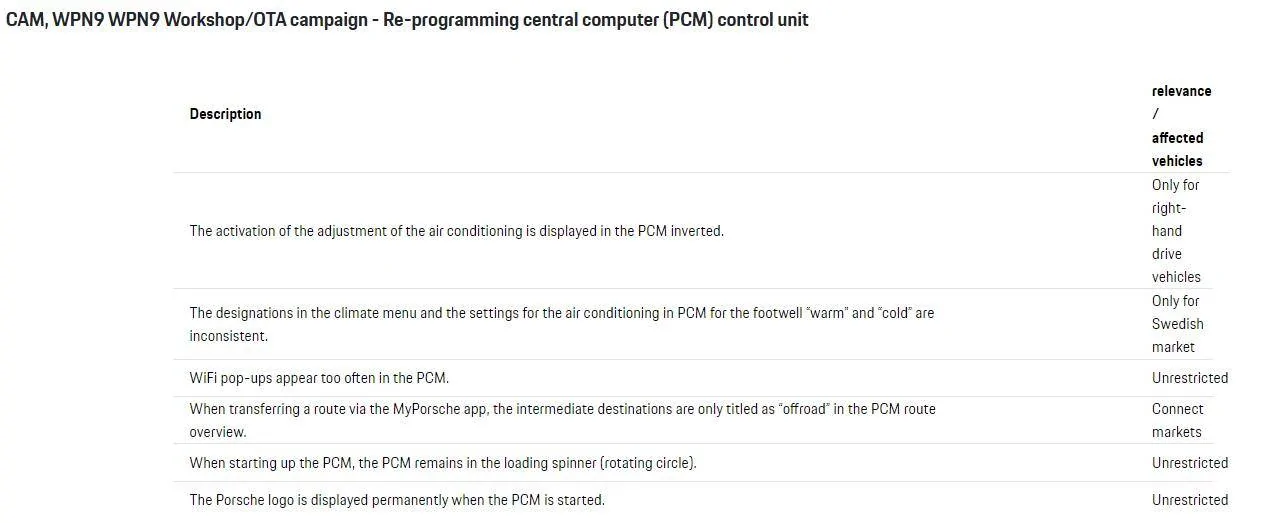

Does anyone know whether WPN9 will also be applicable to MY23 cars?
I have the Porsche logo issue at the PCM start and I contacted my dealer to get the WPN9 update. They told me that it doesn’t have a WPN9 recall but rather a WPN8 one.
Any feedback? Is it because I am in France and it is not released yet? Or is it because MY23 need WPN8 instead of WPN9?
I don’t want to do the WPN8 upgrade and end up doing the WPN9 a month later.

Just took my 21 for WPN9. They said it's a much simpler update of PCM with a few fixes. As a software guy I imagine WPN9 is on top of WPN8 but given how involved WPN8 is to install, the dealer might have to apply WPN8 first anyway. I think NHTSA safety issues are addressed in WPN9 so it may be focused on US market initially to address the recall.
Thanks. Given the list of bugs, it is unlikely it is for US only (there is even one bug specific to Sweden)
Porsche Taycan WPN9 Campaign? IMG_8571
BTW I am having one of the bugs, that’s why I am questioning the fact that my dealer said that he only sees WPN8 as a recall for my Taycan.
Did anyone get WPN9 installed on their MY23?
