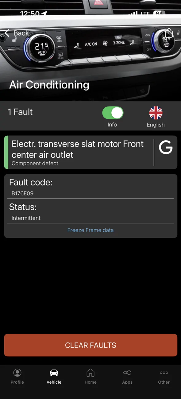

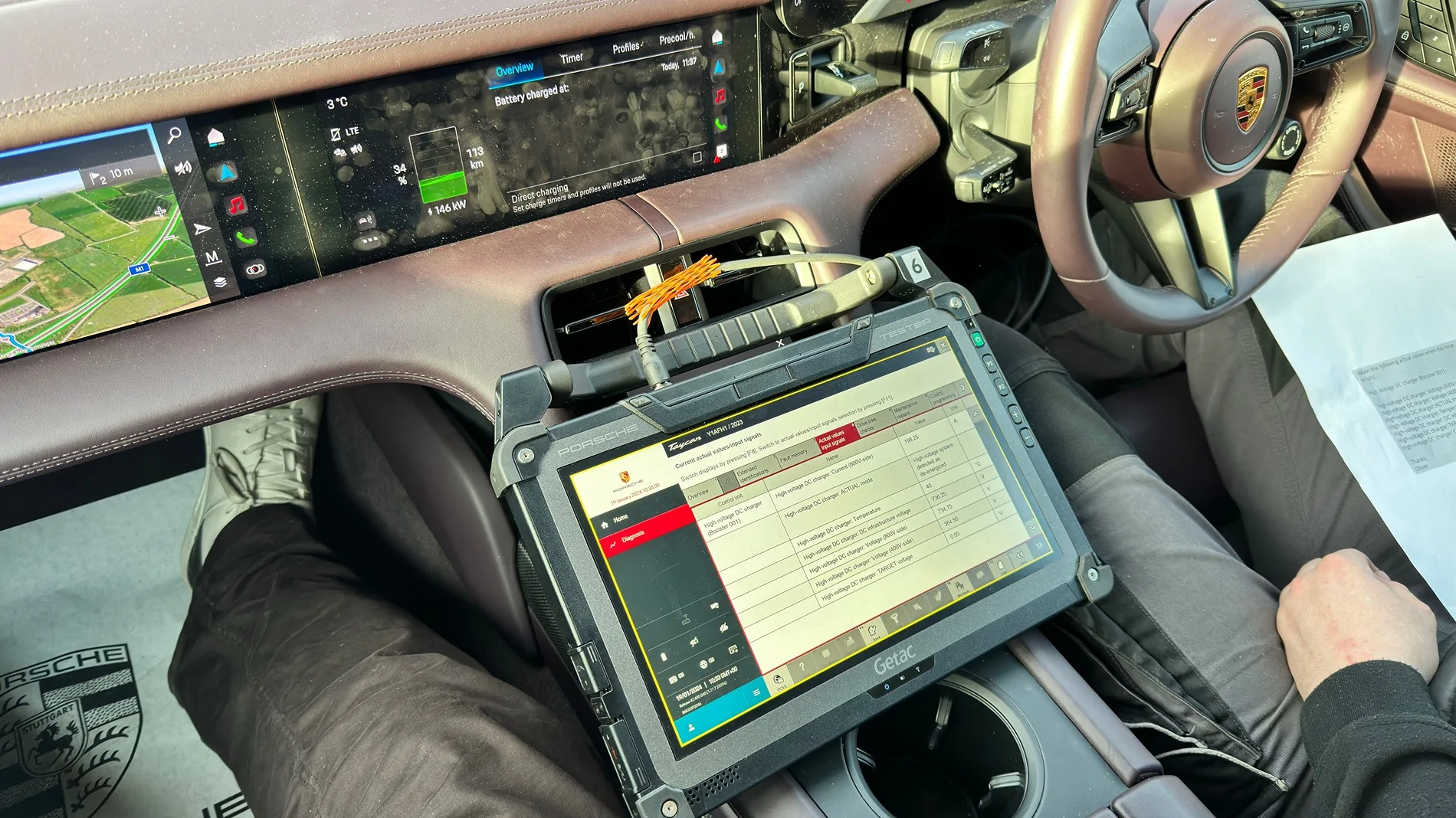

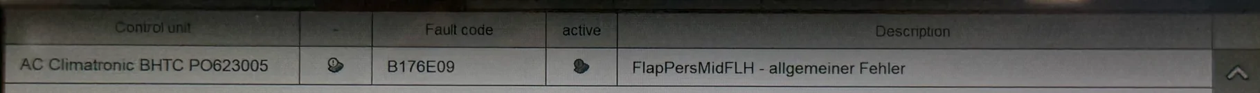

I presume your tech had a PIWIS with him to scan for faults before they disappear. For those without a PIWIS, I could suggest one of the other OBD scanners, I find the OBDeleven VWAG edition seems to show me faults well, sometimes with better explanation than the PIWIS (but the error ID code is the same in PIWIS as it is in OBDeleven). For example, here is one of the errors my car recently threw when it stopped blowing any hot air into the cabin:
PIWIS display:
Porsche Taycan Yellow Electrical System Error - Service Required 1763105338264-2h
OBDeleven display (on my iPhone):
Porsche Taycan Yellow Electrical System Error - Service Required 1763105487623-2n
Free app like CarScanner can also show you faults (sorry, I don't have a screenshot of the above error by CarScanner).
Bottom line, if diagnosing intermittent Taycan issues, it can be helpful to learn how to scan the car for errors when the issue occurs, and log them to show service, to give them an idea what is going wrong. As mentioned above, the error codes on the 3rd party software should match what shows up in Porsche's own PIWIS tool, so it can be used for diagnostics (and warranty coverage determinations).
