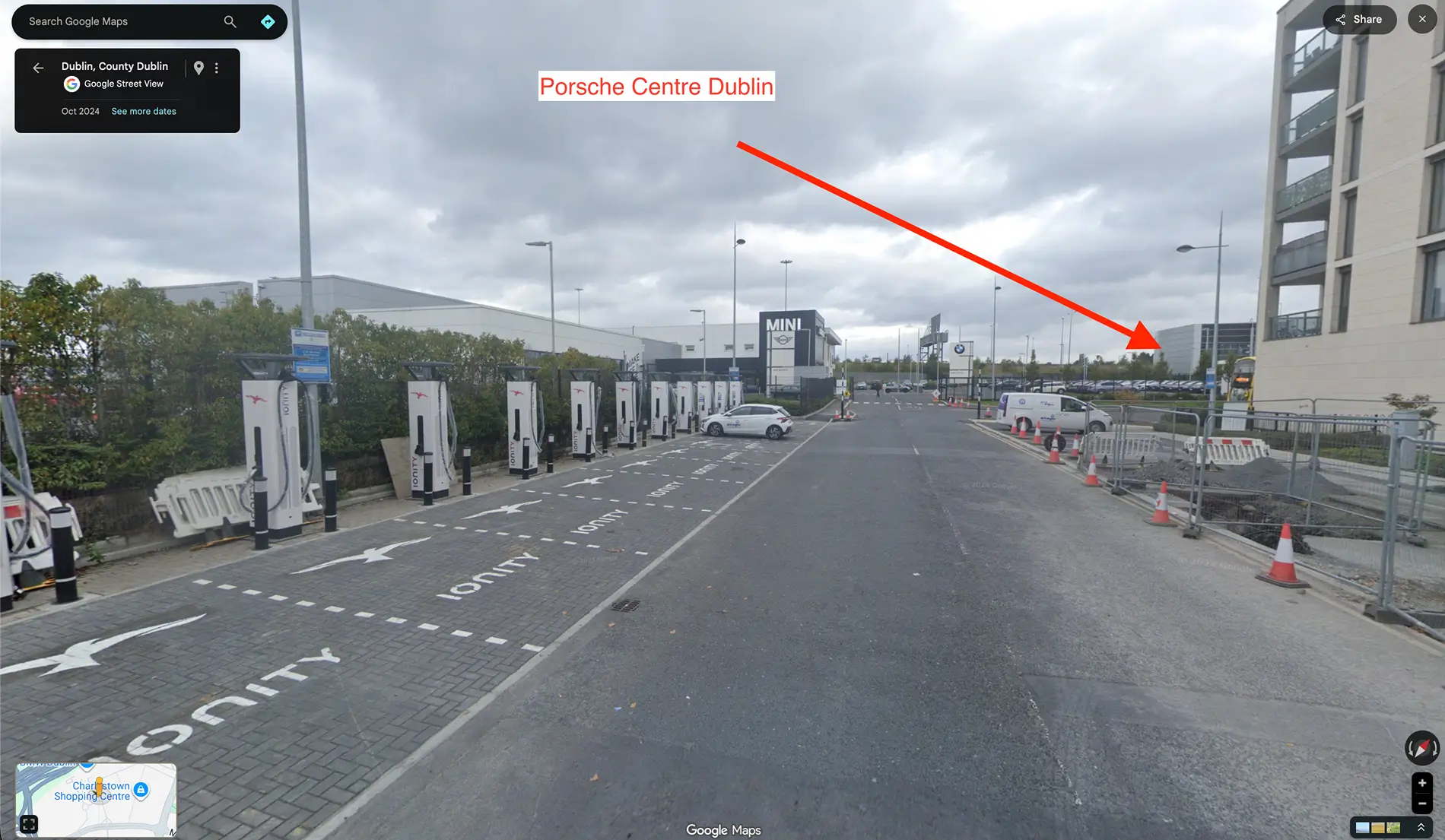

I had a similar problem with reproducing a charging error on my Turbo S. It would fail every time but only if it started at a low state-of-charge and was on a 350 kW charger.
They tried for days to reproduce it on both AC and the 150 kW charger they had available, but it was always fine.
I eventually managed to organise a technician to drive with me to a 350 kW charger which was 50 km away and plug in their PIWIS computer while it charged and failed.
For the first time in weeks, the damn thing refused to fail when plugged into the computer. I could not understand it! The one time I needed it to fail, it refused.
I dropped the technician back at Porsche Centre and went to work. That evening, out of frustration I drove back to that station and tried again. It immediately failed – refused to take in any energy. I tried on a few more charging stations – and failure each time.
Porsche Centre now could see the failure easily and the fix was straightforward.
Nothing worse than a complicated failure reproduction process that involves off-site charging. I was so thankful the thing eventually completely broke.
Nowadays there is a 12-pedestal IONITY station right outside the (only) Porsche Centre in Republic of Ireland. It would have been a much easier thing to try and reproduce today for me!
