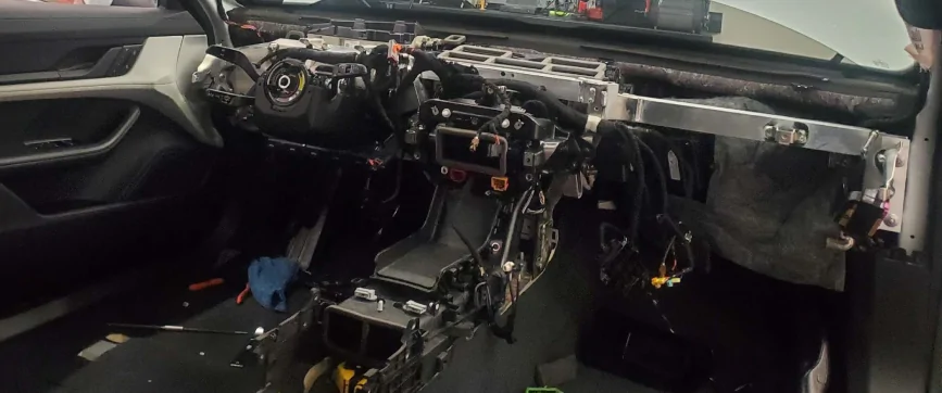

Often the shops have their hands tied as far as what they can or cannot do. My heat died on my Taycan a little more than a month ago. I scanned the car, got 3 errors, HV heater and 2 valve servos. There was no loners for a couple of weeks, so I kept the car as I could drive it without heat, with a manual defogging if needed via a microfiber cloth on a stick. Once they got it in, they ran diags, ordered a new HV heater, replaced it. Still no heat, turns out the two valve servo motors need replacing too, so another round of ordering. I could be annoyed, as this made the repair process longer, but I talked with the tech and the thing is, they have to follow the process for warranty repairs. In this case the process was to clear all errors, which resulted in only HV heater error coming back, so they replaced the heater. Only once the heater was back in action, did the car try to operate the bypass value and another HVAC valve, which returned errors again. So I could be annoyed, that I knew from day one what the issue was, but to be perfectly honest I only had a strong suspicion which turned out to be correct. The shop has to follow Porsche process if they want to get paid. And if it was on my own dime (not Porsche paid warranty), would I authorize purchase of all parts up front not knowing whether they will in fact be needed later? I'm not sure (I don't know the cost, which would have been a major decision factor). Oh, I also made a mistake by tying the heat repair with ASA2 recall, because Porsche ETA for the part was only 1 week out, but still not there 2 weeks later, so this ended up in an unnecessary delay (they wanted to wait for all parts before working on the car). I've since decoupled the two services, will come back whenever the recalled seat cushion makes it.
So bottom line is I think my dealer does the best they can within the framework set by Porsche. It may be possible your dealer is in similar situation. Could Porsche make it better, definitely. For example, they could support running remote diagnostics, or a way for customer to trigger a log scan/freeze when a problem is happening, or at least no-appointment-drop-in for a quick car scan to catch an error which happens intermittently.
PS> Talking to the service people, usually when heat dies in a Taycan it's a quick HV heater swap. My Taycan decided to be an exception, replacement of the broken valve servos requires a complete disassembly of the dash, which takes more than a day to take apart, then more than a day to put back together!
Porsche Taycan Yellow Electrical System Error - Service Required 1764742170694-jc
I sure hope when they put it back together this week (parts finally here), there won't be another valve somewhere under there which will require it to be taken apart again.
