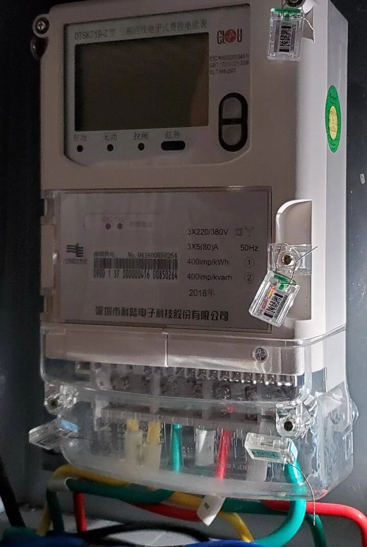

I have 3 phase 380V 30A, gives me 34.2kW, installed. The charger can only take 22kW, but the car can only load with 11.2kW
With the figures You have quoted there is some mistake I available power. But it doesn’t matter since the car limits charge to 11 kW.
