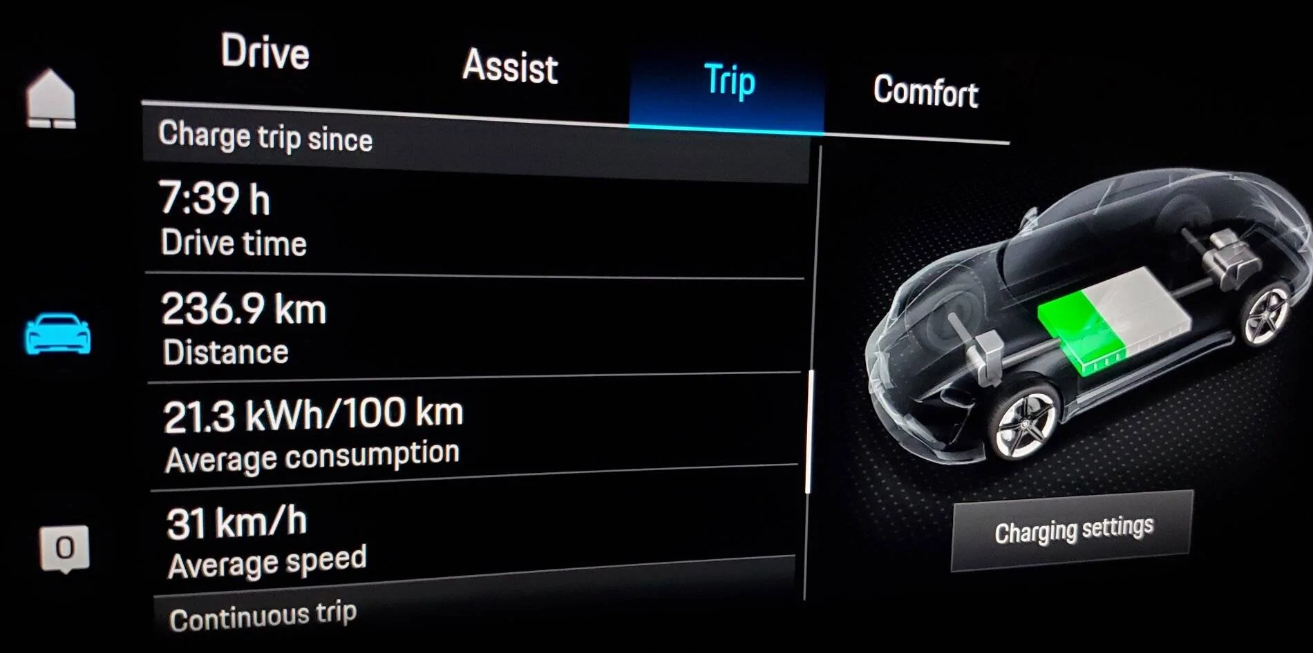

Yes! The consumption is so low, the battery so big, really no need to charge all the time, unless you have long distance every day...
Porsche Taycan 22KW charging 20200906_134608
And this is pushing the car in city driving with a couple of LCs.
