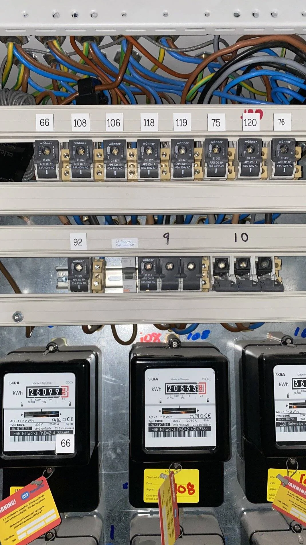

Oh that is interesting – I have ordered the 22 kWH charger in my Taycan. Though, I think my apartment block is only delivering a 63A circuit to my underground parking space.
Do you happen to have any links/info on this – so I can perhaps start planning for it?
My apartment distribution board – think this means I have 1 phase 63A supply

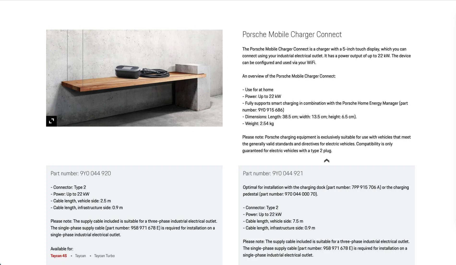

I wonder is this maybe a US version of the free charger (was free at time of ordering; costs more now) that is coming with my vehicle. I always assumed the 22 kWH requires 3-phase power - wonder if thats true?
https://content3.eu.porsche.com/prod/pag/tequipment/TeqFinder.nsf/TeqFinder?ReadForm&ba=Taycan&ma=PCGB (RL)&sp=1&bt=J1&mo=Taycan 4S&co=40&ac=product&pr=418E4BE0C59AF682C125856E00280F43
edit: On closer inspection yes, the 22kWH charging does require 3-phase power.
Not correct, look at the bottom right, a part number for single phase.
I think this is it, now available in Europe.
