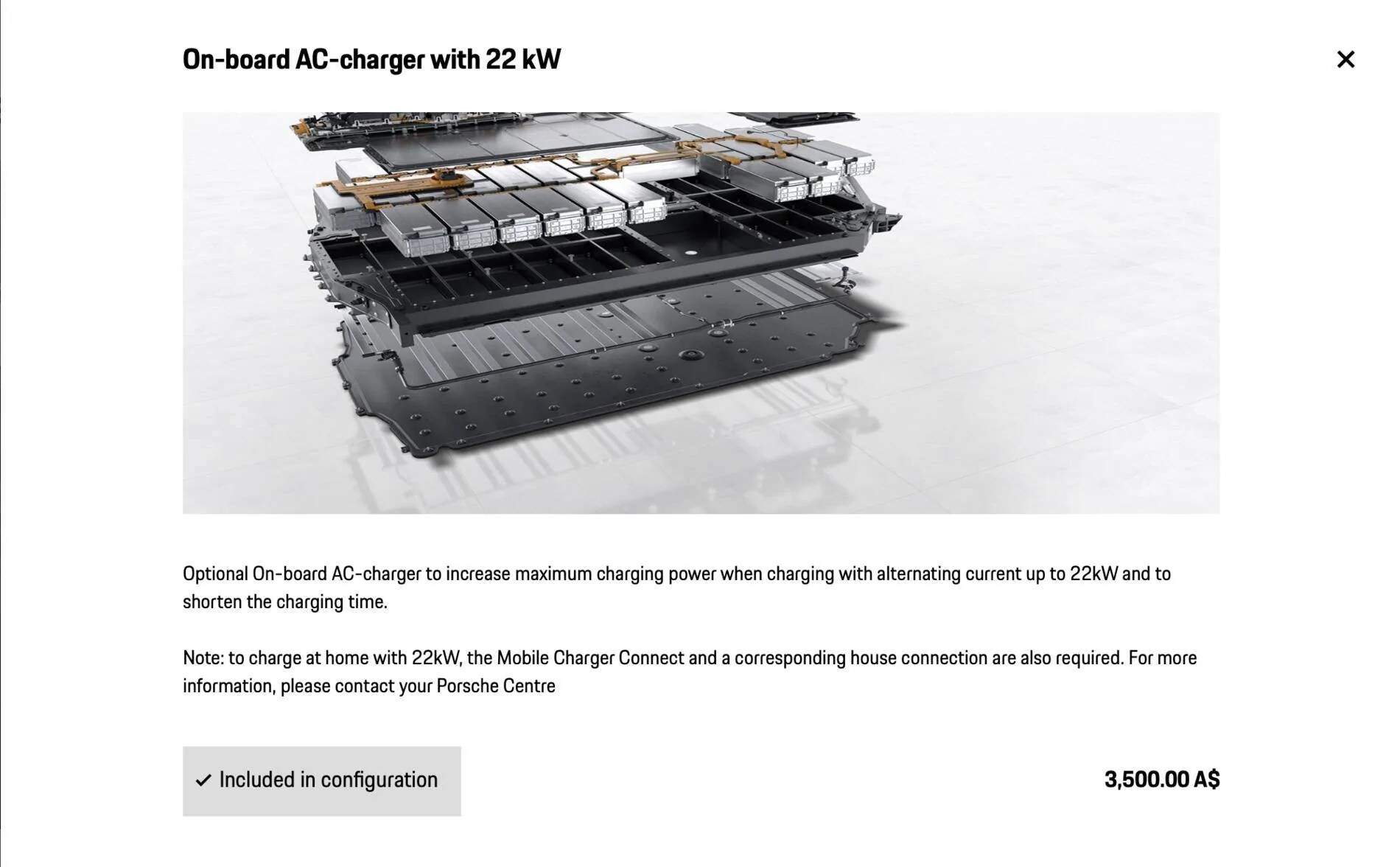

Look what I just found on the Australia configurator.
Porsche Taycan 22KW charging Screen Shot 2020-09-08 at 6.30.29 AM
Porsche Taycan 22KW charging 22k

wow that’s an expensive option!

Yes very expensive and not worth it if you ask me. 11 kw will do just fine when charging at home.

the 22 kW charging option from Porsche enables L2/AC Charging at a 22 kW rate - that would require what ever AMPS/Power/1 Phase/3 Phase ROW charging - this is a very fast rate and matches the highest rate of any AC based L2 charger I’ve seen - the previous record being the 19.2 kW rate when you optioned a dual charger for a Tesla Model S…
there is a limit on what charge rate EV’s can achieve with AC power because you need to provide AC to DC converters (chargers) inside the vehicle to convert the incoming AC power to DC power for the battery. Currently the Taycan ships with an 11 kW AC/DC converter - so that is the limit of the vehicle’s charging when provided with AC power…
the onboard DC charging hardware is limited to 270 kW for 800 volts, and 50/150 kW for 400 volts
_IF_ you were to install a FastDC charger in your home - at say 15 kW capacity - charging your Taycan from the FastDC charger would charge at 15 kW rate because it would bypass the onboard AC/DC converter and just shove DC current directly into the battery…
I would prefer this because that means the on-board AC/DC converter would no longer be the limiting factor in maximum charge rate.
You can puchase FastDC chargers for about $8000 - so a $3500 AC 22 kW option is approaching 1/2 the cost of a low end FastDC charger - I’d consider the money better spent on a FastDC charger because it would benefit all EV’s - Even my ChevyBolt can charge at 55 kW via FastDC - so in my case it would work for all my EV’s and I’d no longer be limited by arbitrary “on board” AC/DC converter limits for how fast my EV would charge.
Porsche would have to modify their softare however, because right now FastDC charging is not subject to timer/profile limits and always charges immediately and to 100%…for a home FastDC charging you’d still want schedule and battery % control.

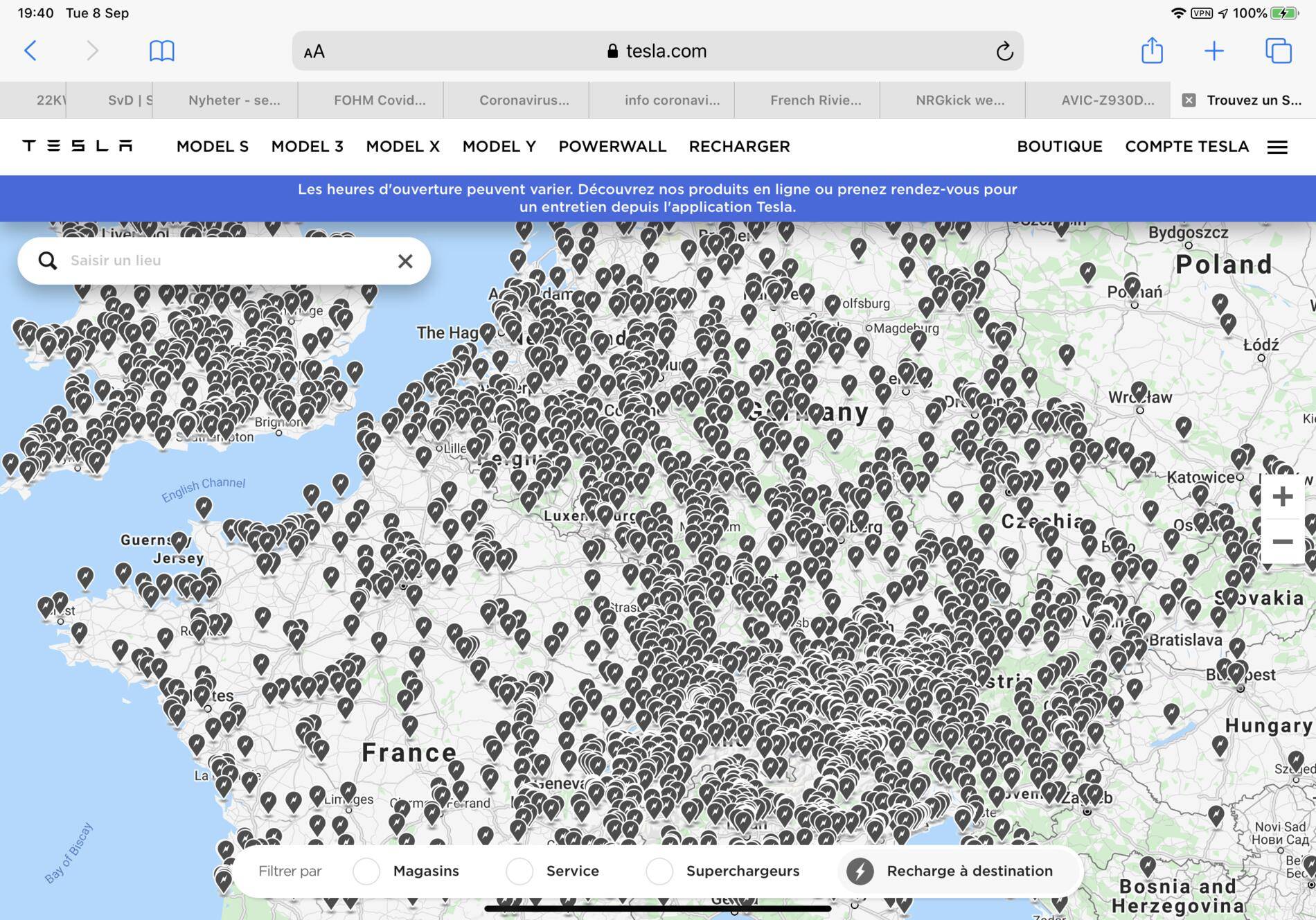

$3500 for a 22 kW AC charger on the Taycan just makes no sense to me. You’re not going to find a lot of L2 22 kW AC chargers in the world europe or otherwise…
Well here in France there are quite a lot of 22 kW AC chargers. The Zoe can take 22 kW and that is a popular car here!
Also all the Tesla Wall connectors with 3 phase wiring will deliver up to 22 kW! And so will most of the Tesla destination chargers, and there are a lot of them. I guess we are fortunate to have quite a lot of 3 phase installations in Europe.
3,907
3,552
Here is a screenshot of the European destination chargers. Mainly at Restaurants, Hotels, Sports complex and Golf Clubs etc. Really useful to take into account when planning a trip. And in Europe this is with the standard Type 2 connector, not Tesla specific.
Porsche Taycan 22KW charging 62460C54-28CB-477A-B8F4-CA7836E3FF59

@Scandinavian thanks for the correction - I was wrong - apparently Europe is well covered by 22 kW chargers - the US has few if any 19.2 kW chargers - I've updated by original posting.
at the moment the 22 kW charger option really seems to only make sense in the non-US markets. And it doesn't quite fit the US market given it's unique requirements.
