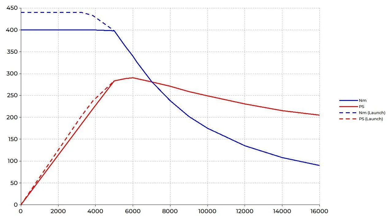

3.1. Front motor/inverter - Taycan Turbo S
This motor/inverter combination is used only on the Taycan Turbo S. Besides having significantly higher torque limit of 400Nm, it also has a special launch control mode. When (and only when) launch control is activated in the ECU, the torque is additionally boosted by 10% to 440 Nm.
Here is the maximum output graph of the Taycan Turbo S front inverter as seen by the ASG. The dashed line shows the maximum output in launch control mode. The graph is taken at close to 100% SoC:
Porsche Taycan Part 2: The J1 Powertrain 1745246899892-rk
The X axis is motor RPM. 6000 RPM is roughly 100km/h.

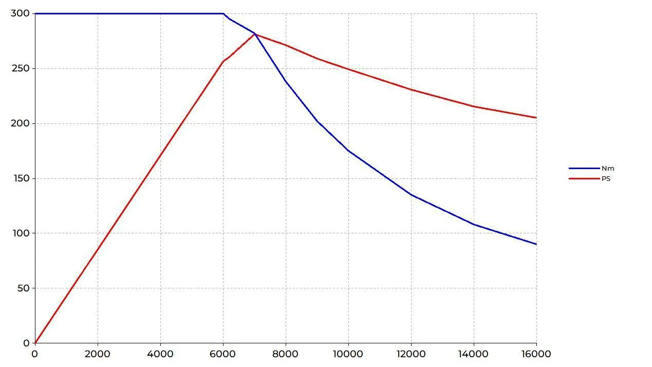

3.2. Front motor/inverter - All other models
With the smaller 300A inverter, the maximum torque is 300Nm. There is no launch mode, the torque is the same regardless of whether race start is active in the ECU or not. As visible from the graph, the power output is exactly the same, albeit the Turbo S inverter has an advantage until about 105km/h, when their outputs converge. From 0-60km/h the Turbo S inverter has 46.7% more torque on tap.
Below is the graph for the 300A variant, as seen by the ASG near 100% SoC:

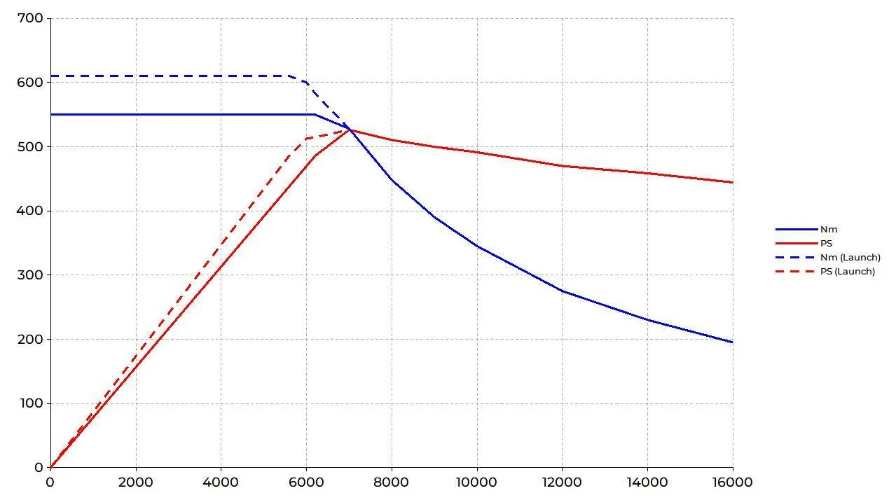

3.3. Rear Motor/Inverter - Turbo S, Turbo, GTS, Etron GT RS
The bigger one of the rear motors/inverters. The standard torque limit is 550Nm. During race start activation in the ASG, the torque limit is increased to 610 Nm. The peak power output is about 525 PS.
Below is the graph for the maximum possible output, as seen by the ASG near 100% SoC:

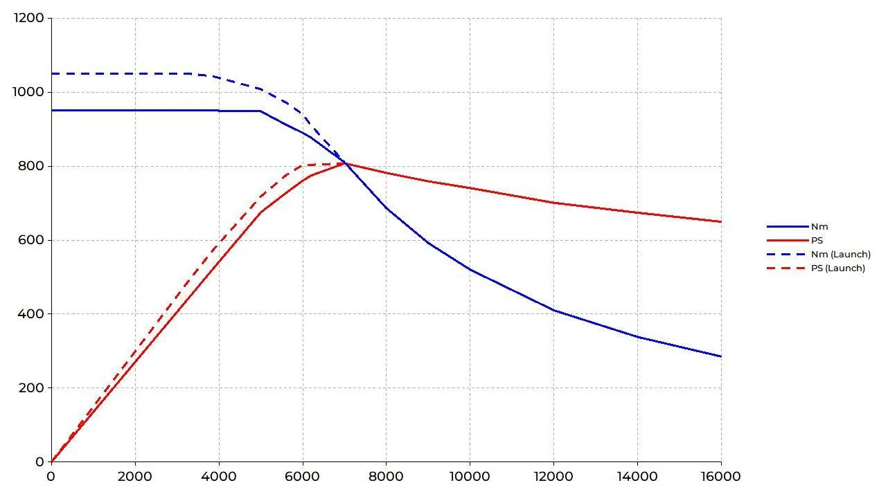

5.1. Taycan Turbo S
Porsche Taycan Part 2: The J1 Powertrain 1745249491960-tl
Maximum 800 PS / 1050 Nm in launch control, 800 PS / 950 Nm outside. At 100% SoC.

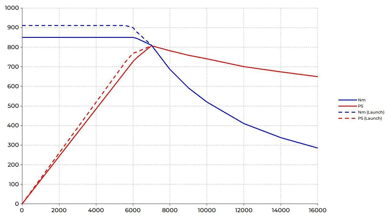

5.2. Taycan Turbo / Taycan GTS / Etron GT RS
Porsche Taycan Part 2: The J1 Powertrain 1745249674952-ol
Maximum 800 PS / 910 Nm in launch control, 800 PS / 850 Nm outside. At 100% SoC.

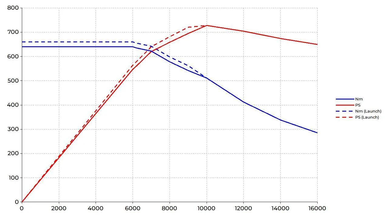

5.3. Taycan 4S, Taycan 4 - Performance Battery Plus
Porsche Taycan Part 2: The J1 Powertrain 1745249826826-33
Maximum 730 PS / 660 Nm in launch control, 730 PS / 640 Nm outside. At 75-100% SoC.

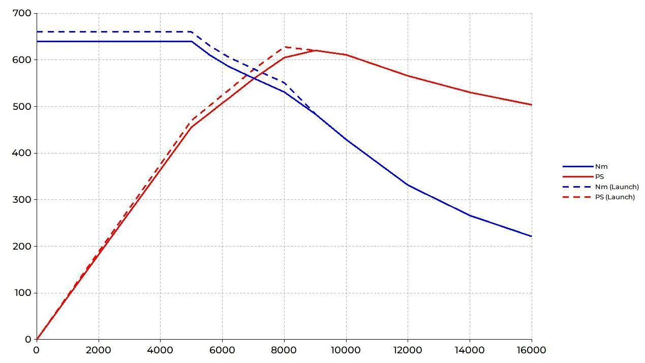

5.4. Taycan 4S - Performance Battery
This graph was taken at about 80% SoC. I do not have a full 100% SoC graph for this battery.
Porsche Taycan Part 2: The J1 Powertrain 1745249960602-u7
Maximum 660 PS / 660Nm in launch control, 660 PS / 640 Nm outside. At 100% SoC.
At 80% SoC: 630 PS / 660 Nm in launch control, 620 PS / 640 Nm outside.

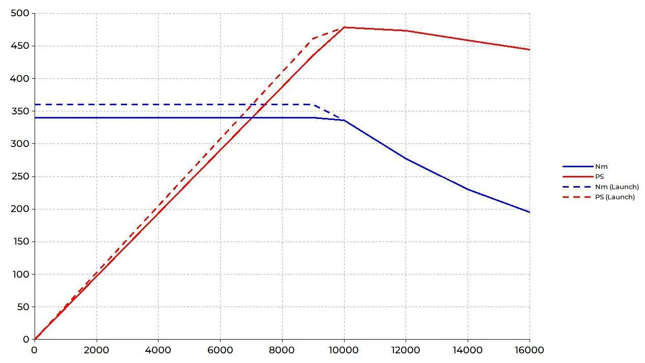

5.5. Taycan RWD - Either battery type
Porsche Taycan Part 2: The J1 Powertrain 1745250092167-hc
The RWD Taycan manages 480 PS and 340 Nm outside launch control and 480 PS and 360 Nm with launch control.
