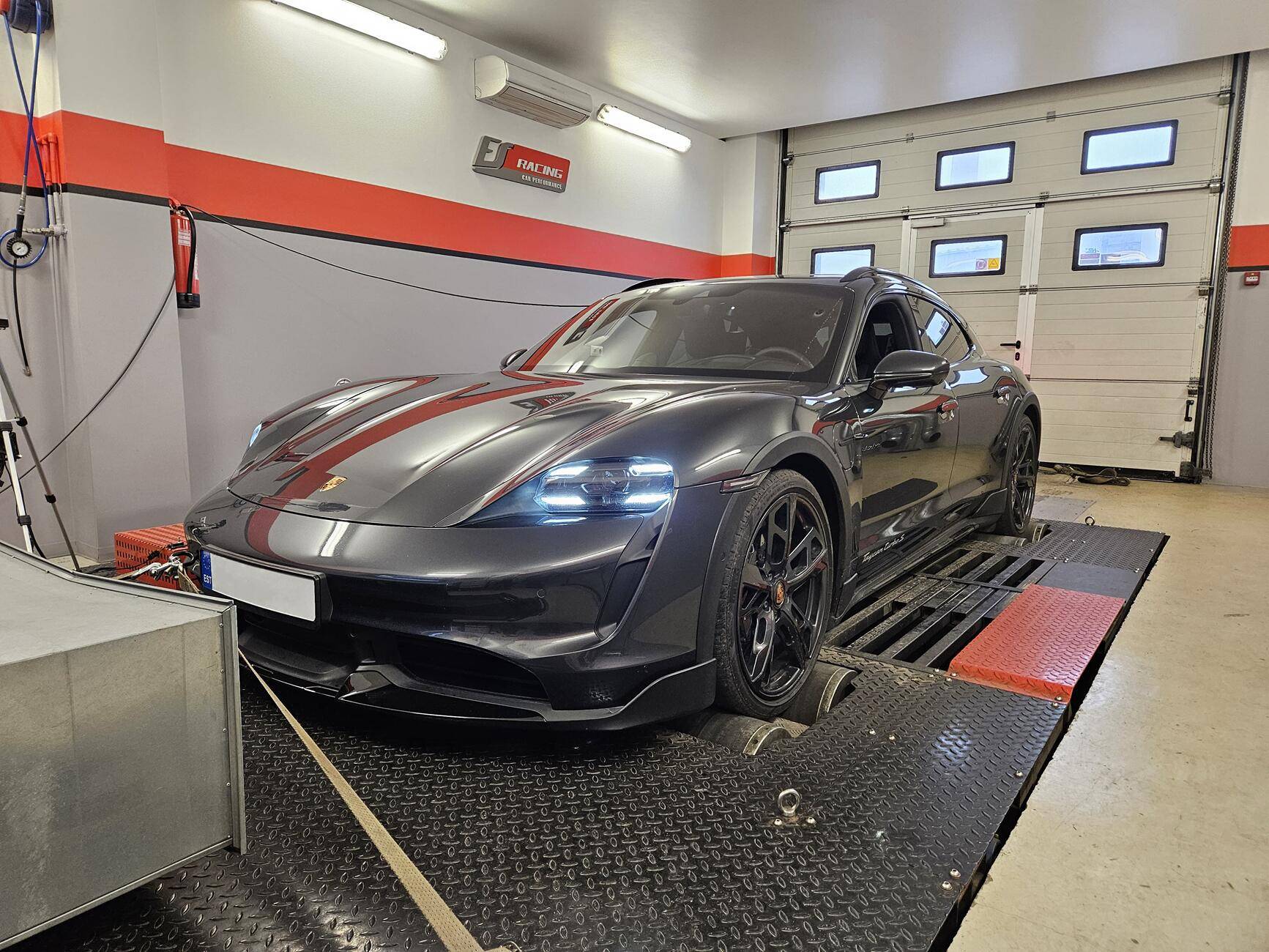

As promised, today I put the car on my dyno again:
Porsche Taycan Part 2: The J1 Powertrain 1745422391876-ji

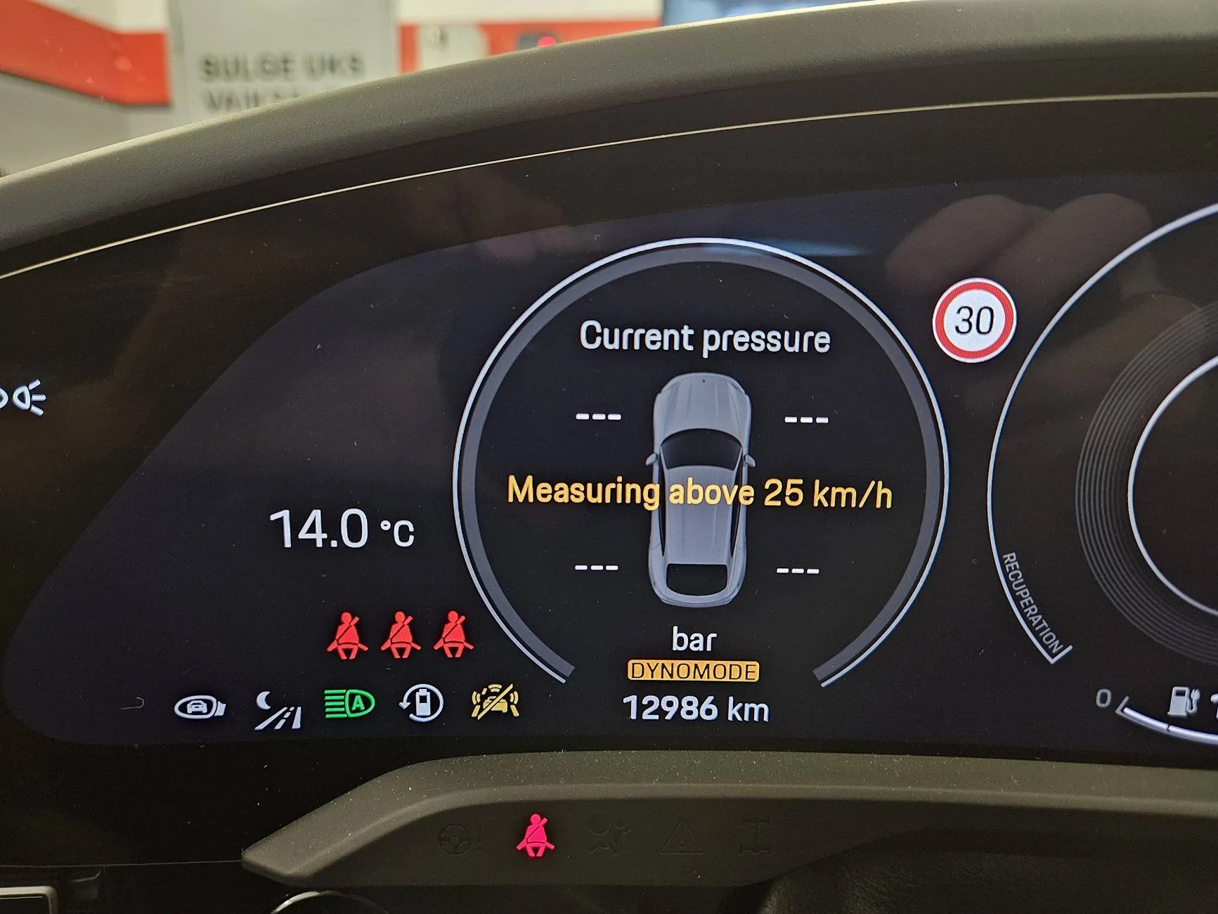

Then I put it in Dyno mode and ran it, which according to some companies is "impossible":
Porsche Taycan Part 2: The J1 Powertrain 1745422442690-kd

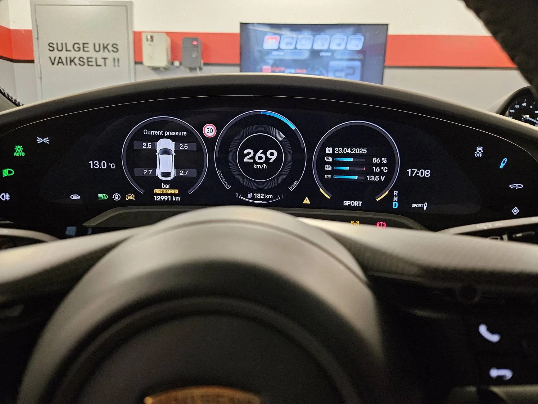

And I tested the max speed limit. I got 269 km/h indicated on the dash with 21" wheels and the OEM fitment tyres (with modified ASG of course!):
Porsche Taycan Part 2: The J1 Powertrain 1745422504533-f

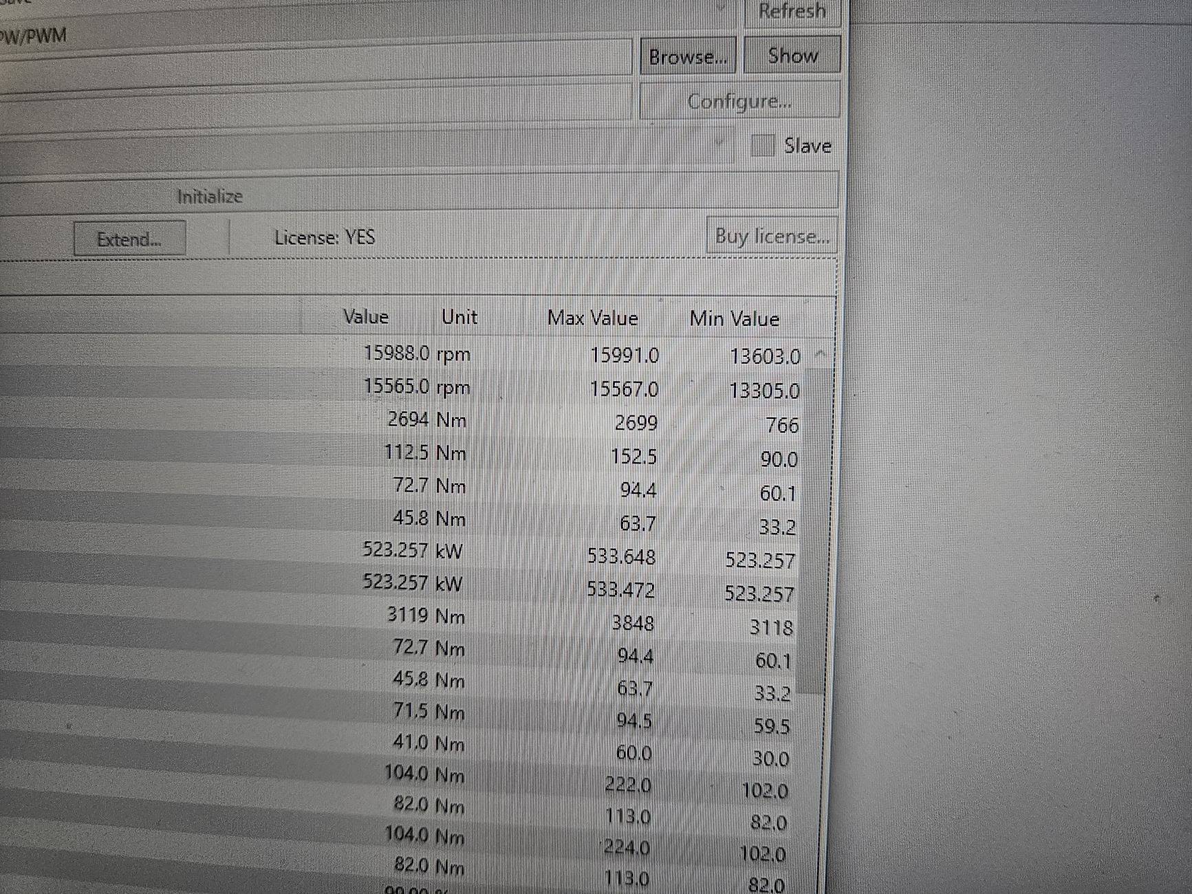

At that point the car had 16000 RPM on the rear motor and was bouncing off the limiter, and 15500 RPM on the front motor:
Porsche Taycan Part 2: The J1 Powertrain 1745422625401-f3
The link between the front and rear on the dyno was engaged. I didn't want to do any funny stuff like letting the front wheels spin faster than the rears.
I didn't do any power runs because with 56% SoC that's pretty pointless (you can see already in the screenshot the limitation was 523 kW from the battery, so probaby around 460 kW output power). But if someone wants to see the most boring dyno graph in the world with a diagonal torque line and flat power line, then I can do that when I charge the car to 100%.
The ASG is much more precise though than the dyno can measure, because when you do the coastdown measurement then the regen shenanigans really mess stuff up and you end up with inflated power figures.
