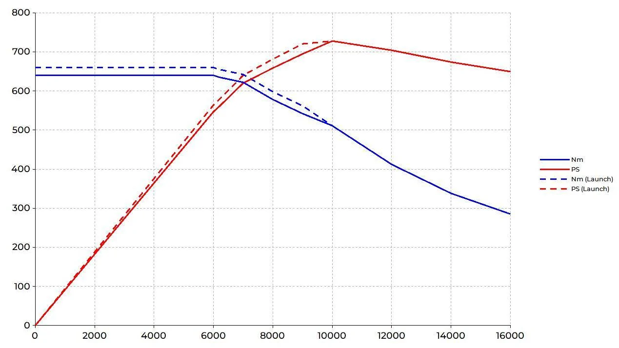

There is a PEAK torque increase of 5-10% at low speeds.
However, the Taycan 4S at e.g. 85kph has 50% more torque and 50% more horsepower than stock in normal mode.
85kph would be 5100 rpm right ?
So based on your chart (suggestion btw: a stock vs what-i-am-selling chart would make this convo a lot simpler, at least to a seemingly IQ challenged person like me), stock torque at 5100 is 427 Nm ?
This chart is in second gear to show the total performance of the motors over the rev range, but the car has also a first gear.
From factory the shiftpoints are different for every mode, and especially on the 4S you have to alter them a lot. So a full apples to apples comparison through the rev range can not easily be done.
However - a 0-100kph (60mph) power chart could be useful to add in first gear for each model. This would show when you reach the maximum power.
By the way - I am the first one to provide any charts. All the companies selling until now just made random claims without having any data to back them up! But I love data, and more data is always good.
I think it is a great idea. I will work on these charts and add them. It will take some work.
