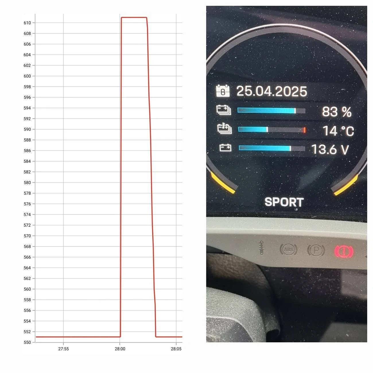

Any idea why I get this reading with my Turbo S CT ...using carscanner.
Battery temp: 14C
83% SOC
sport sportplus (launch ready): abt 611 Nm max torque
Normal sport sport plus. Non launch ready: abt 551 Nm
Should be 1050Nm with TS no?
many thanks for ur insights.

I have no idea what Carscanner is logging and whether their conversion values are correct.
Seems like it's torque for rear inverter, but even then the correct values are 610 and 550, not 611 and 551.
You can ask them why they are displaying it incorrectly - I don't use carscanner, but from my short conversation with the author a while back they were empirically searching for values and formulas, so that is not a serious tool, but more of a toy.
I also don't think the total torque was even loggable via $22 on OBD, which CarScanner is using, but you can log front and rear motor torque separately. At least with ODIS or a tool using ODIS dump.
TQEM1 & TQEM2.
I am using factory level datalogging with A2L data, not dealer level, and definitely not toy tool level.
In the A2L the total torque is Elm_tqActSum_VW - but you can never get access to that without installing a special patch into the ASG.
TQEM1 & TQEM2.
