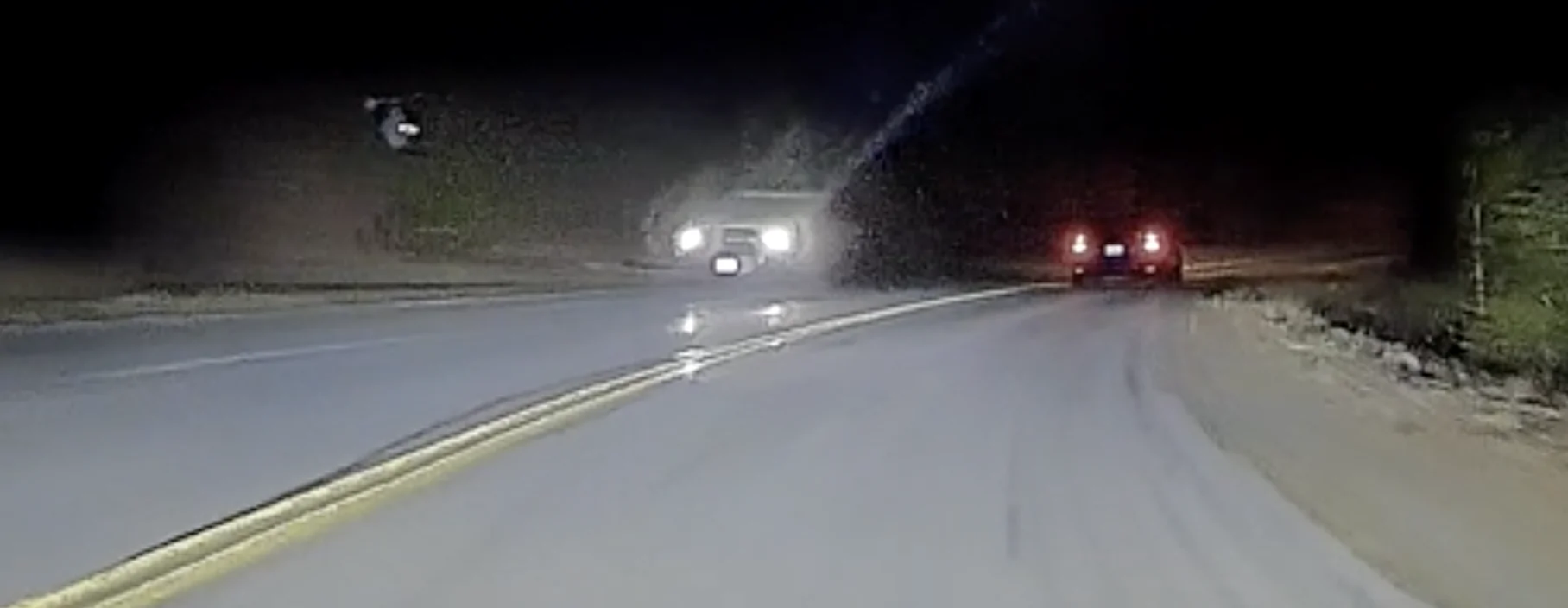

I recently upgraded to the J1.2 and finally have Matrix LED enabled (in Canada they have been legal for many years but we get US-specced cars so always deactivated).
1. Magic carpet
Pretty gimmicky in my opinion, gave me quite a startle when it first came on as it's very bright. As far as I can tell the distance doesn't change based on speed. Does "curve" around bends pretty well.
2. Matrix high beam
Works very well, although I think Porsche's version has a much bigger "cut -out" than other manufacturers. Overall the light is very bright and very uniform. Fairly reactive. Although advertised I dont think there are "cornering lights" - unless they're so subtle as to not notice.
Overall very impressed with these lights and happy to finally have Matrix activated

You didn’t capture the lane changes where it sees where you’re going, “magic carpet” starts covering your new lane then swipes away from the old one.
I still like how it’ll light up the sides and makes it brighter but the magic carpet is still active.

Mine have never worked well. I get flashes from other traffic always if I use the automation. I've complained it several times in service but I only get blah-blah about very good and bright lights.. True but it's very visible it often messes the shading.
Safety issue.

Surprised that yours do not work well. Mine are absolutely great and have performed very well. I think I have only been flashed at maximum a handful of times with nearly 80 k km’s driving.

For the people saying they don't work well, they may be miss aligned. In the manual there is a auto realignment procedure - it involves parking face first perpendicular at 90 degrees to plain straight wall, and living the car/lights on for 15+ minutes from what I recall.

Matrix is amazing, but even in the OP's video, if you look closely you'll see it blind the opposing driver and shines on the entire car, roof and tailgate included, for about a second. This is from the main/high beam, which is controlled by the matrix light system and likely would not be influenced with headlight/low beam calibration.
Mine doesn't do that tho`, it's much faster to react.
Which makes me think his are simply not aligned
