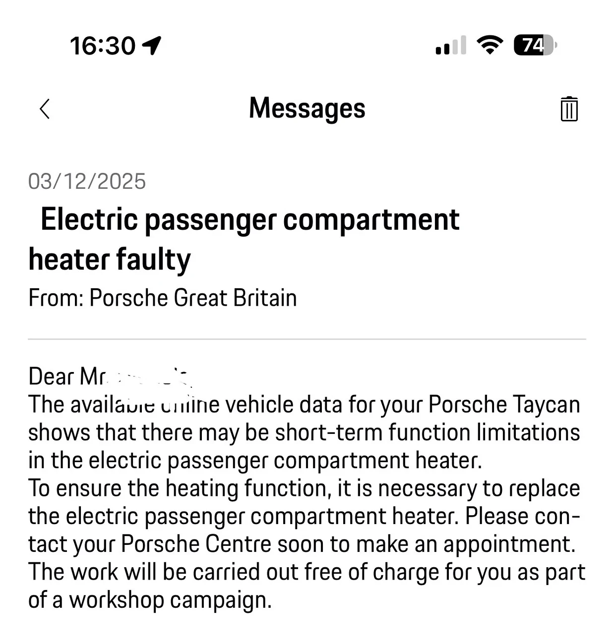

Porsche Taycan Another Heater ! IMG_4089
only just spotted this message in the My Porsche app. No other comms, not even a notification or email! Just happened to spot there was a message under my profile in the app.
MY24 GTS ST, 20k miles
I’ve had the air con compressor replaced previously but no heater issues before. Not actually experiencing any issues - so not sure if I might ignore. Bit fed up of taking it to the workshop!

Must be blowing cold air. Mine MY24 CTS dies December replacement dies January..
Surely you must notice the lack of heat?
Don't ignore, that means there's an active fault and it's a matter of "when" not "if", and that "when" is coming soon.
The shop should have all the parts in stock, then they'll do it in a day.

I’m curious whether this passenger heater malfunction would affect battery preheating/heating. If the heater is broken, does that also mean the battery won’t preheat?
90
8,445
7,444
If that's the case, then it's a really big problem!
Pre-heating battery will cost you extra charging time, perhaps some range. No heat in the cabin means no defrosting/defogging windows, much worse. It's considered a safety issues in more than one country.
