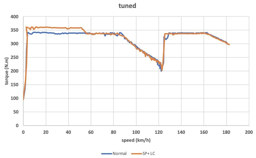

1/ torque vs speed for different modes:
The 2 curves are almost identical. Almost because SP+ still has this small overboost in torque in the very beginning: we are talking of +6% for 2.5 sec. Does it have a noticeable effect on the results? no. It would matter in Formula One, not here.
Porsche Taycan Anyone tune their BASE RWD model with Redshift Performance? Screenshot 2025-04-26 at 13.52.07

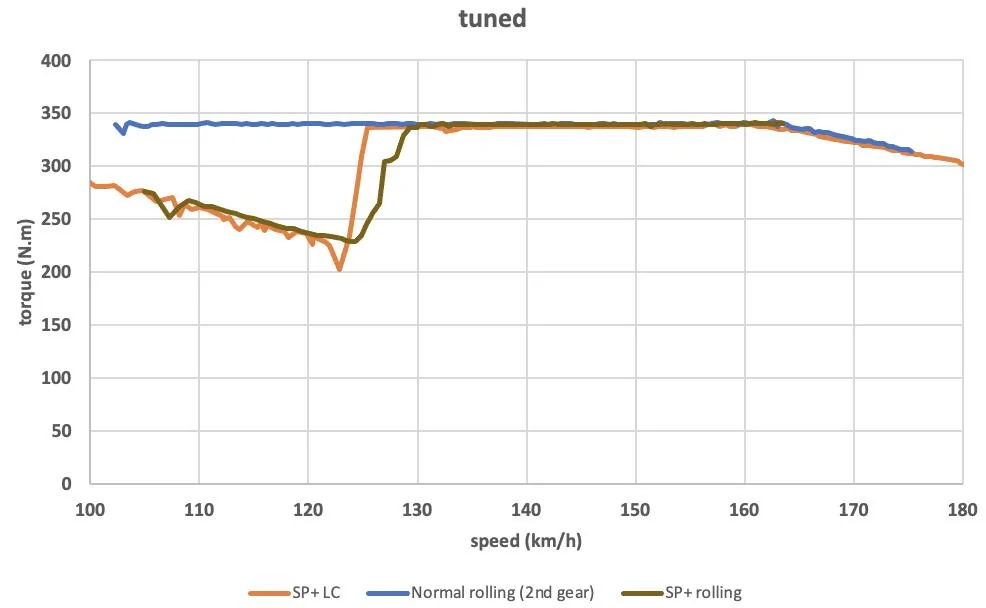

From a rolling start (100km/h), the 2 curves are also almost identical. Almost because in Normal mode the car was in 2nd gear, while it was in 1st gear for SP+ But after SP+ shifts to 2nd gear, they are identical. I also include the power curves : higher torque in 2nd gear (Normal) but lower power too (lower RPM).
Porsche Taycan Anyone tune their BASE RWD model with Redshift Performance? Screenshot 2025-04-26 at 13.52.15
Porsche Taycan Anyone tune their BASE RWD model with Redshift Performance? Screenshot 2025-04-26 at 13.52.22
It was discussed if it makes sense to shift a bit later, ie 130km/h instead of 120km/h. It won't change much : at a certain point you'll have anyway this drop in torque/power when shifting.
Porsche Taycan Anyone tune their BASE RWD model with Redshift Performance? screenshot-2025-04-26-at-13-52-07-jpg
This puzzles me. Torque drop should come much earlier in non LC. Even the 2nd gear torque drop comes in exactly at the same time. Are you sure the blue line is non-LC here ?
There are no errors in @Gru chart. It looks exactly correct.
His measurements are from a tuned ASG. So both are the same except for the launch overboost at start, which is not enabled in normal mode for him.
No his car is not tuned @Gru can you confirm?
yes. tuned ASG in Normal non-LC

it is ... now ? (recently)
That's the numbers I got with a tuned ASG. so I can compare the stock and tuned results
Wow OK. Congrats ?.
Well then this solves all the mystery.

So difference with my tune is that both graphs would look identical from a standstill. And also you get the 20nm extra for 2.5s if you floor it at higher speed also.
which will be hardly noticeable I think.
Thinking this still makes a difference even if small
