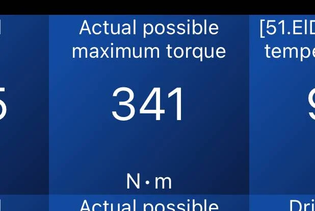

In case it helps, it looks like this in one of the screens and called “actual possible maximum torque”.
Porsche Taycan Anyone tune their BASE RWD model with Redshift Performance? IMG_8010

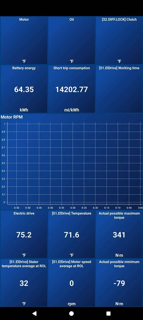

So I used the dashboard method. Max torque reads 1 until I put the car in drive then it displays 341(all driving modes). When I've driven it live and recorded data before I've seen torque go way past that though so maybe there's something else to it. Again this weekend when I have more time I'll drive it and try to get some live data. I want to get to the bottom of this now ?.
Porsche Taycan Anyone tune their BASE RWD model with Redshift Performance? Screenshot_20250424-153900
This is getting interesting :) so you saw actual torque going higher than 340?

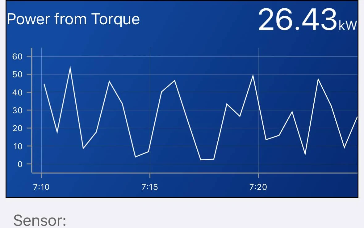

There is no “max available power” screen. You can only check power live. I think the best way is to check is “power from torque” screen. It essentially calculates the power from the torque and RPM. You can choose to customize a screen and search for “power from torque” and pick the chart format. That will get you something like this:
Porsche Taycan Anyone tune their BASE RWD model with Redshift Performance? IMG_8013
