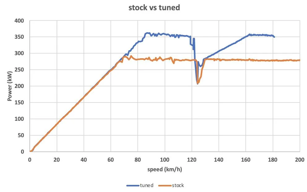

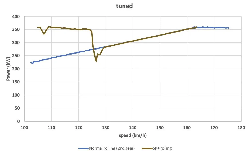

It was discussed if it makes sense to shift a bit later, ie 130km/h instead of 120km/h. It won't change much : at a certain point you'll have anyway this drop in torque/power when shifting.
In term of power, the curves (perhaps the most interesting ones) below illustrate the difference in power in real life where you (almost) never use Launch Control. You will never feel a difference below 70km/h.
@Gru how did you plot the Power vs speed graph with Carscanner? What are you using to display the power?
Thx!
Gru
Aug 21, 2022
424
585
Taycan Sport Turismo - 20"
Thx!
I exported the rpm/torque/speed and used Excel for these plots. I don't think it's possible to do it with Carscanner.
For the power, kW = Torque (N.m) * rpm / 9550

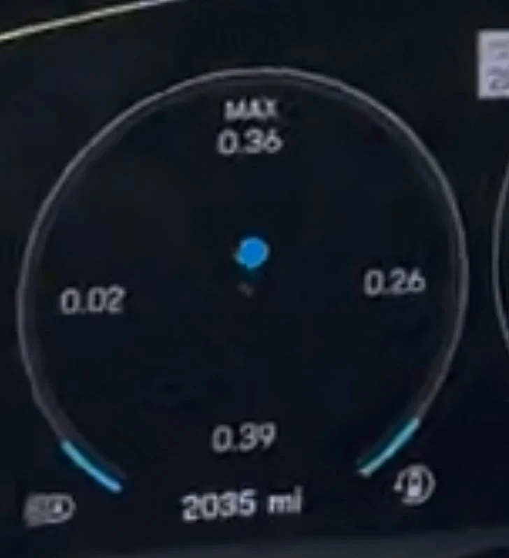

@Gru @Emokeff88
When you have a chance, do you guys mind checking your max G figure recorded for acceleration on the left side circle of the dash? (Looks like the attached picture). In non-LC mode i can only get 0.55-0.56G with my stock RWD PB+. Wondering tune makes any difference at all on this. (Likely not given max torque is not changing but i would like to rule out anything else possibly at play like throttle filtering etc, that could actually impact the g force experienced by the driver). Appreciate you doing this. (Btw you can clear the max history through the menu, in case you want to take a fresh reading).
