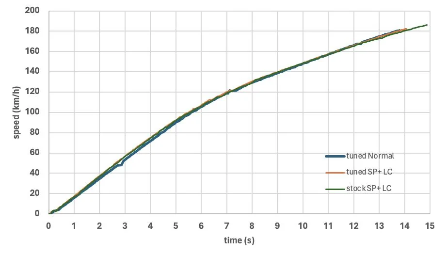

@Gru thanks a lot for plotting those graphs. Very helpful. It confirms that @prj was 100% right.
About this one:
2/ 0 - xx km/h:
These runs were made different on different days, different weather, almost similar SoC (but not identical) so the values are not to be taken as the best one can obtain.
Would you have the same graph with the curve for "Stock Sport+ without LC"?
If the curve is way lower without LC, I understand why people who tuned the RWD has the feeling of a more powerful car. The reality is that LC is not used very often in the day to day and can only be used from a stopped position. Sometimes you just want to hit the accelerator and get the power and this, not necessarily from a stopped position...

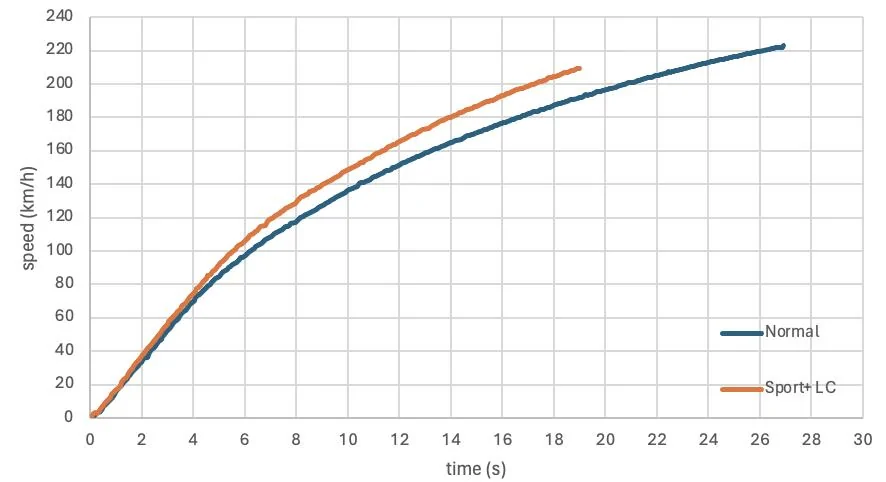

no, I don't think I have (I'll double check).
but it it shouldn't be very different from stock Normal, in fact it should be identical: torque curves are identical. (Prj could confirm)
I think I plotted the stock Normal in the other discussion (the "neardy" one).
edit: that one.
actually Normal and Sport+ non_LC were identical and I plotted only Normal
Porsche Taycan Anyone tune their BASE RWD model with Redshift Performance? Screenshot 2025-04-26 at 15.24.31

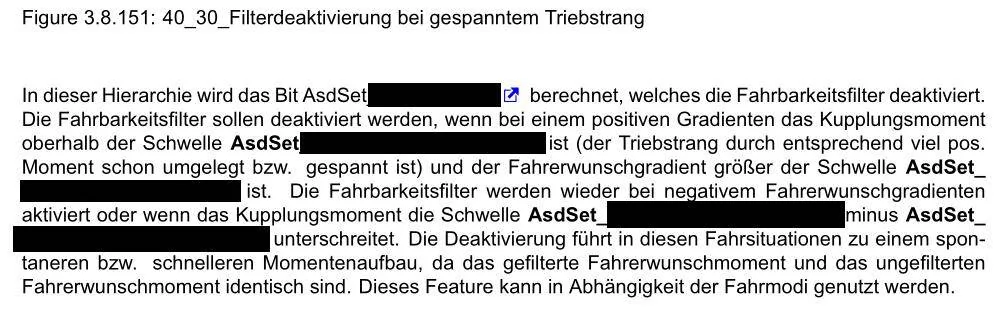

Is it simpler to have the same tuned torque/power curve in all modes, but maybe just enable your custom torque filtering elimination only in sport mode?
Torque filtering can be set based on mode, but for THAT there is absolutely no point. Because I don't do a dumb hack that just turns it all off. There is no benefit from turning it off completely over doing it through the correct function, it just makes the car drive like crap when you're trying to drive it normally.
The driver request filter bypass activates only with significant pedal input and only if the powertrain has some forward torque on it already. You have to move the pedal more than 40-50% in a short time.
Having it locked away behind modes defeats the purpose.

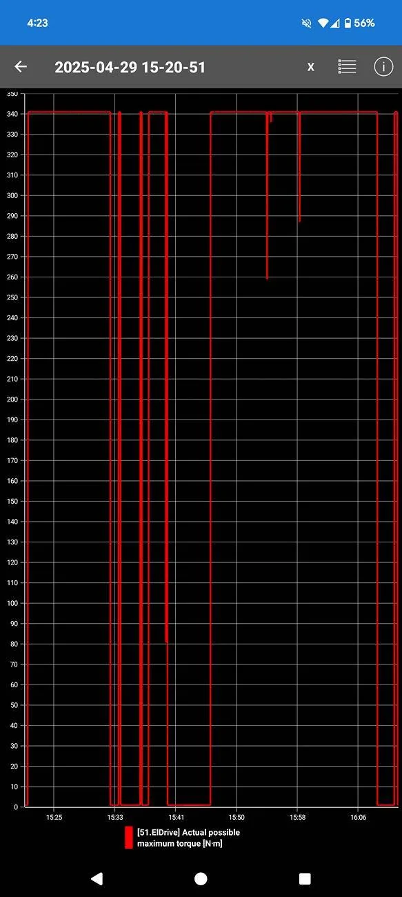

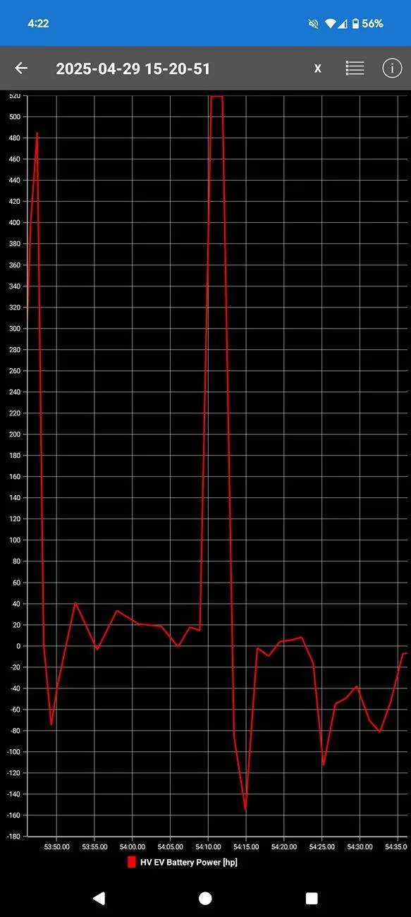

My daily drive has a bad tire so I drove the Taycan to work today and pulled a few stats... As mentioned just to double tap, it looks like torque is locked in & 341. I left this morning at 100% SoC and did some good low traffic pulls. Unfortunately the data captured was not the Dashboard mode as I never clicked it. On the way home I made sure I was in dashboard mode at around 83% SoC. Take this with a grain of salt, this is my driving in afternoon work traffic, doing short pulls. I'll get to that 570hp I saw in the past eventually.. (maybe more?). You guys are the experts though, I'll let you interpret all this. If the weather is good this weekend I'll try for real.
1. Battery power is not motive power. Battery power draw is significantly higher, the powertrain is nowhere close to 100% efficient.
2. Nothing in the ECU shows a such parameter (power in hp). This means someone made that parameter up on the spot (including the scaling for it). The controller shows battery draw in kW, but again this is not motive power.
3. Your torque is not 341, the scaling in your app is wrong. 340 is the max it can ever run out of LC. Small difference, but still...
4. This is exactly what I mean by using toys for logging instead of real tools.

2022 Taycan RWD PB+
2. Nothing in the ECU shows a such parameter (power in hp). This means someone made that parameter up on the spot. The controller shows battery draw in kW, but again this is not motive power.
3. This is exactly what I mean by using toys for logging instead of real tools.
Again....didn't say I was the expert, do with this information what you will
You don't have to be.
And I did just that.
What you provided matches what was provided earlier here, and also the curve that is in Part 2 :)
