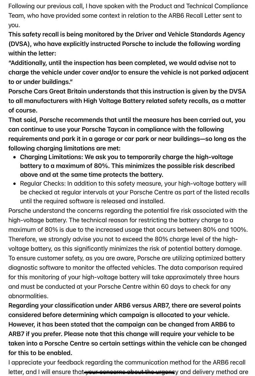

For reasons which they have not been prepared to or able to communicate, Porsche GB had issued different ARB6 charging constraints to different UK Taycan owners. Similarly some owners with cars which supported OTA remote battery condition monitoring received the much less impactful ARB7 recall while others like myself were placed in the ARB6 camp.
The intial ARB6 advice to me, relayed from the UK DVSA safety authority, was:
not to charge the vehicle under cover and/or to ensure the vehicle is not parked adjacent to or under buildings.”
I challenged the Porsche GB CEO office on this because the restriction effectively meant the vehicle could not br charged anywhere. Contrary to UK consumer legislation this made the vehicle unfit for purpose.
After some ‘toing and froing’ they have issued the amended ARB6 recall advice below. The key parts are in bold.
The major change is that the car can be charged in a garage or car park or near buildings—so long as it is not charged above 80%.
Whilst this relaxation is good news, the new Porsche GB advice now differs from the safety authority’s advice. I’m checking that with the DVSA CEO’s office and will update later.
Porsche GB have also said that the campaign can be changed from ARB6 to ARB7 - this requires a Porsche Centre to enable certain settings. My understanding is that whilst the 80% charge limit would still apply, this would remove the requirement for a workshop check every 60 days.
Hope this is helpful to others. In my opinion the original advice from Porsche GB was untenable. I’m glad I was able to persuade them down a different path so I can continue to use (charge) and enjoy the car.

Updated UK ARB6 Recall and Charging Constraints
Interim updates on post #131 above:
(1) I’m awaiting confirmation on whether the ARB6 > 7 switch has happened.
(2) The Uk safety regulator DVSA has told me to ignore the ARB6 charging location relaxation issued to me by Porsche GB (above).
The regulator’s position is that the Charging location restriction communicated in the ARB5 and ARB6 recalls still stands - do not charge under cover, or adjacent to or inside buildings. The regulator will report back to me further once they’ve had a reply from Porsche GB.
