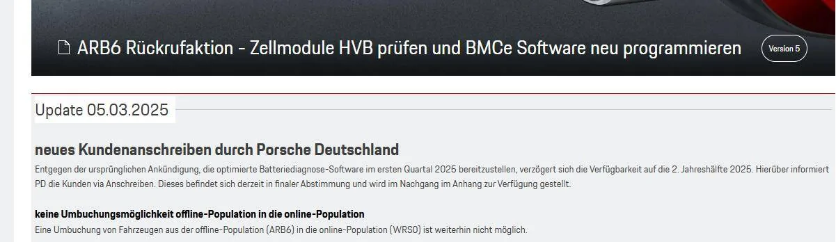

in the middle of purchasing a 2022 Taycan GTS sedan.
I asked about recalls that night still be open - the dreaded ARB6 is one of them (alongside WRS1).
I said that these issues should be remedied before I take delivery of the car.
I have been told that that isn’t possible because the ARB6 software rollout has been pushed back until the 2nd half of 2025!!!!
I am seriously considering cancelling the contract.
Translation:
„New customer letter from Porsche Germany
Contrary to the original announcement that the optimised battery diagnostic software would be available in the first quarter of 2025, availability is delayed to the second quarter of the battery diagnostic software. Half of the year 2025. Porsche Deutschland will Inform customers via cover letter. This letter is currently in the final review and will be made available in the annex afterwards.“
Porsche Taycan ARB6 Recall notice UK.... IMG_5281
