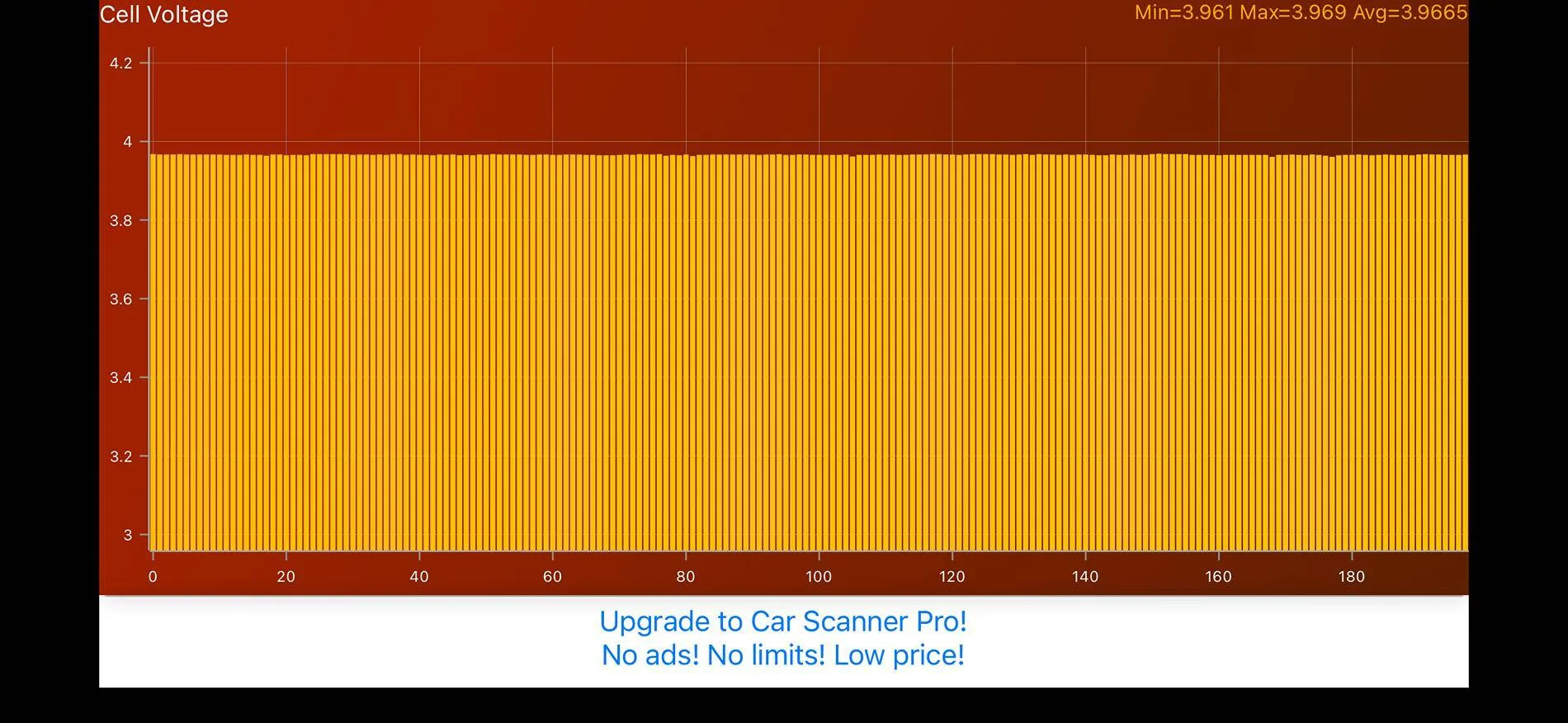

Like many on this forum I recently received the WRS0 workshop campaign letter from Porsche Uk (model year 2020 Taycan Turbo S). No mention of an over the air (OTA) update for the new “optimised battery diagnostic software” as it requires dealership installation.
I would love to know if this pending software update will expose the health of individual battery cells on request via the PCM or only flag dangerous exceptions ?
I’m fairly relaxed about all this as - at 80% charge - my cell data via the excellent CarScanner app looks pretty healthy …
