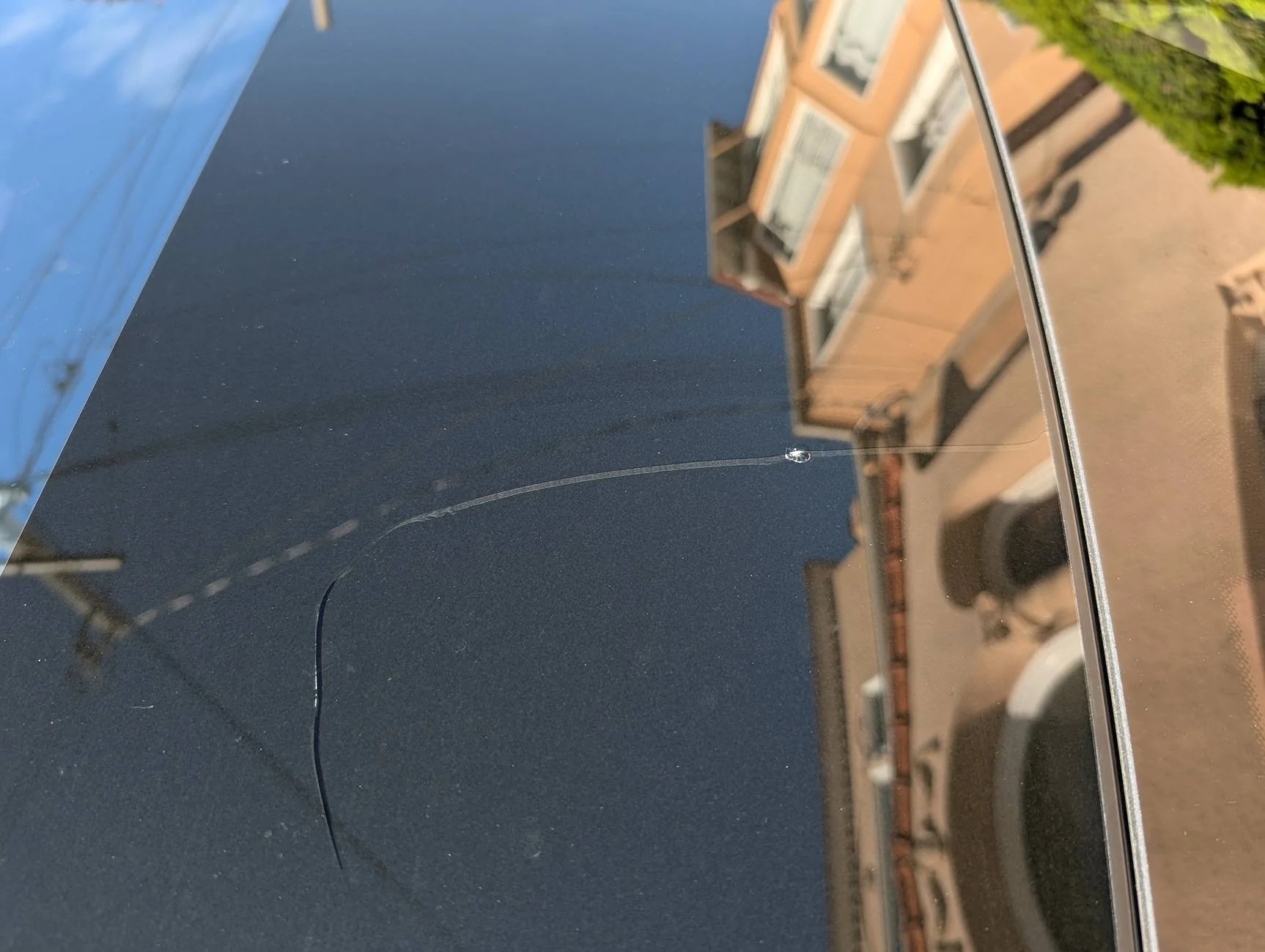

Damn it, I've had the car for 7 days and today, I picked up the dread crack on the glass roof. It's clearly an impact related crack, so it'll be an insurance claim. It's on the non visual part of the glass, so I can still enjoy my VLC roof while I wait for the part.
Questions:
1. For those who had this issue, how long was the wait for the part, and how long was the install?
1. Is there something I should do immediately to it to ensure it doesn't spread or leak? I'm thinking having safelite put the windshield filler in into the impact crater.
btw this is on a wagon WITH roof rails AND variable light control, so I'm guess it won't be the typical $8k glass part...

Mine cracked (VLC) and was replaced under warranty (as the crack appears from under the roof bar mounting point).
It was about a 3 week delay for the part for me.
The crack did grow and separate off in to several paths - about 1cm/day I reckon. But it didn’t leak, so i wouldn’t worry about that. It didn’t affect the function of VLC either.
normally replacement involves also replacing the front windscreen. My OPC had a method to do it where they removed the front seats instead. Apparently the windscreen is only removed to get the headliner out - by taking the seats out, they could just drop the headliner down and leave it in the car.

Once it starts cracking, there’s nothing Safelite can do about it.

It's double layer safety glass: just check if one layer is intact.
While one is cracked, the other layer will keep water out of the car.
If water should get between the layers, better not let it freeze.

Rock chip while on a trip and a week later the crack showed up. They had to replace the windshield as part of the panoramic glass replacement, as it broke, as is common in the roof replacement. About $11,000 in the U.S., covered by comprehensive less deductible. Part took just a few days, but it took over a month to get scheduled into the body shop. 3-day job once in.
