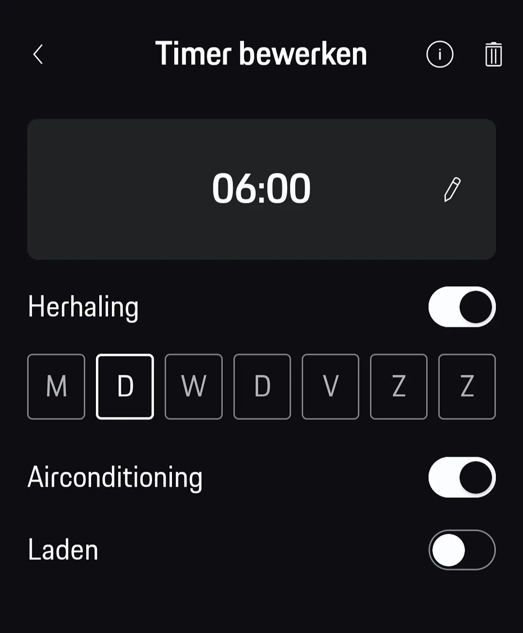

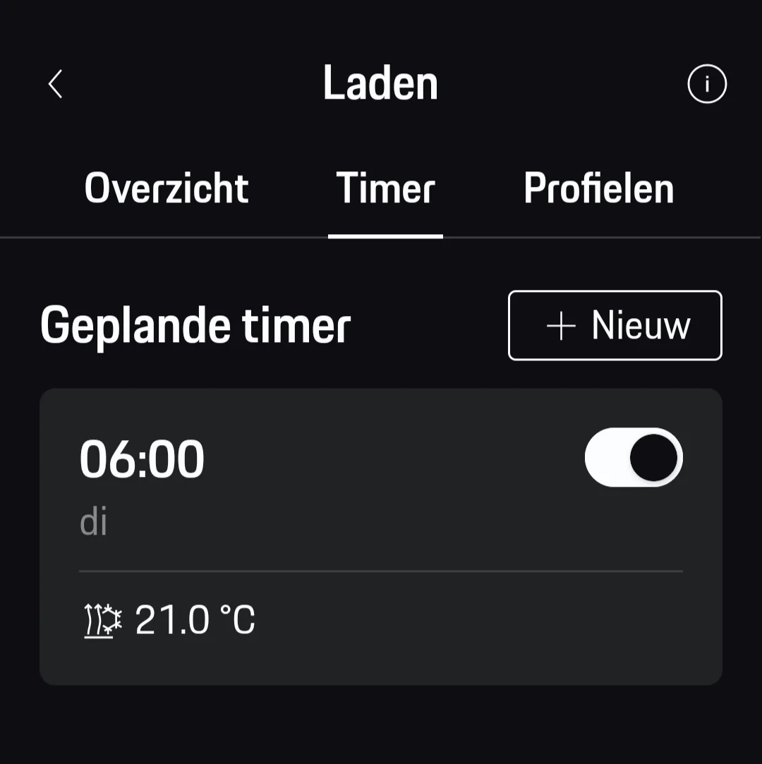

It should look like this.
I don't know why yours says "tomorrow" but mine says tuesday ("di" in my language), which is tomorrow.
Porsche Taycan Cabin preconditioning - have I got it wrong? Screenshot_20251215-083839
Porsche Taycan Cabin preconditioning - have I got it wrong? Screenshot_20251215-083857
With this setting my car is preheated tomorrow but only tomorrow.
If I want more days I just select the days I want.

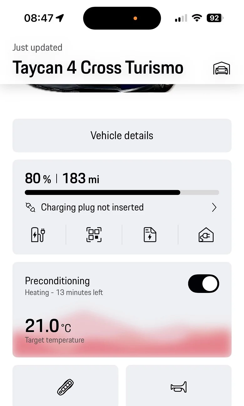

PS In the app it may look like the car isn't preheating but that's just the status in the app, not necessarily the status of the car itself.
I've had that one time, in the app it said it's not preheating (I didn't bother to manually preheating) but when I came to the car it was indeed preheating....

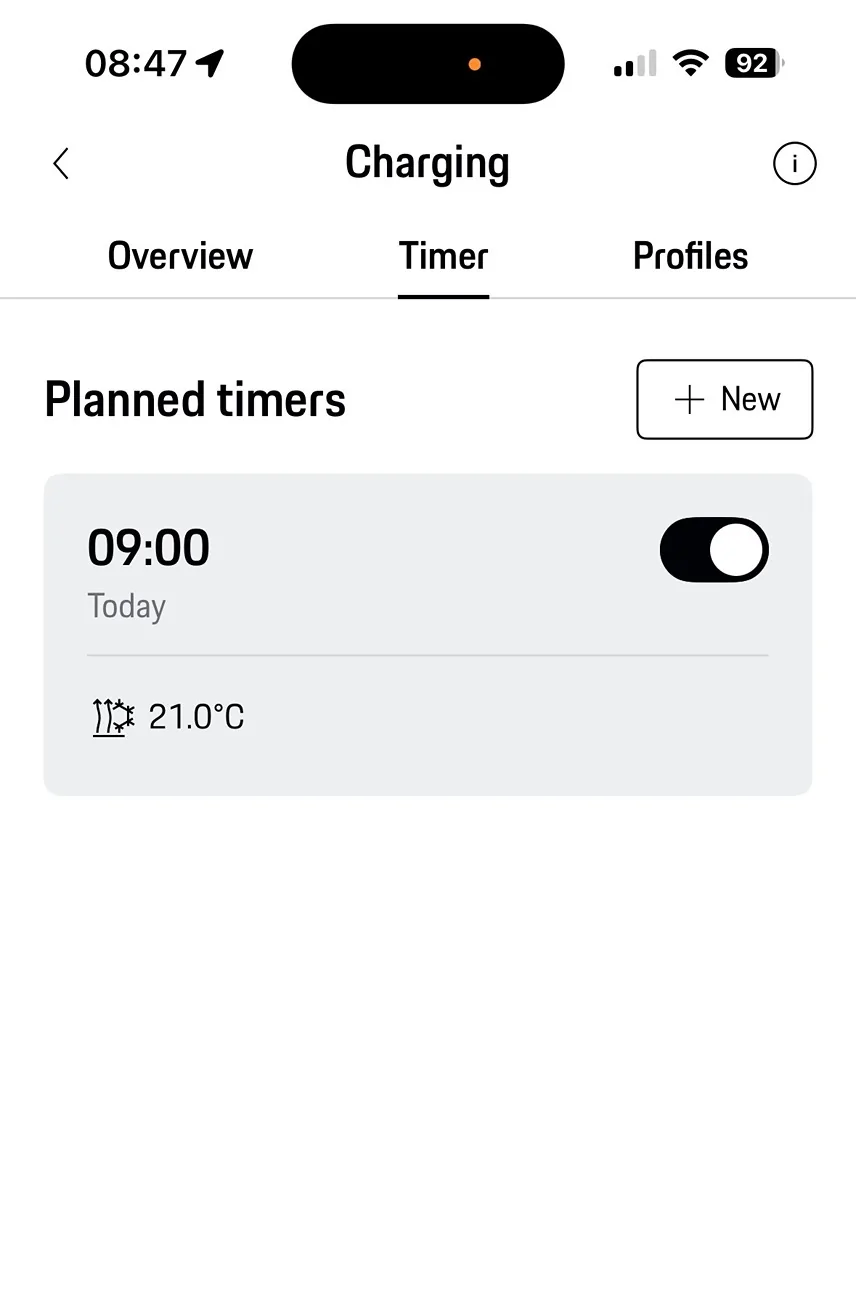

Well today mine is working, one-off preheat scheduled from the app yeateday, didn’t touch anything in the car’s settings
Porsche Taycan Cabin preconditioning - have I got it wrong? IMG_2387
Porsche Taycan Cabin preconditioning - have I got it wrong? IMG_2388
Thanks for the suggestion. I've just had a look in my app and I can get the day names, like in your screenshot, if I enable 'Repeat' (the top option, 'Herhaling' in Dutch it seems, you learn something every day!)
I think I have 2 things to try:
1. Check the preconditioning option in the car's centre console 'battery' screen as suggested by @EVFan
2. Try the 'repeat' / herhaling option as suggested by @SergeyIndy and @Dee
Logically, I don't see why I should have to configure them as repeat timers, and @Leccy61 seems to have it working as I want it to, but as I am rapidly learning; since when is anything logical with these cars? :)

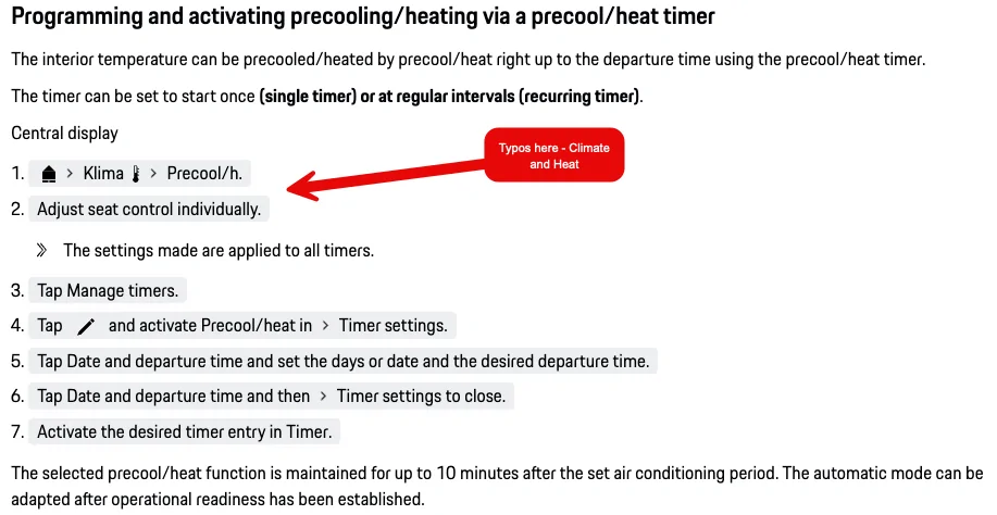

You do not need repeat timers as mentioned in several posts above (or in the Owner's Manual).
Porsche Taycan Cabin preconditioning - have I got it wrong? 1765796923505-8l
If you press the preheat button on the lower panel in the car it will be of no surprise that preheat will start there and then. Again this is not required but sometimes you may wish to use this option when in the car.
Perhaps toggling it on / off may reset something which has got muddled.
You've not yet confirmed (I think) that your timer settings are visible in the PCM when you send them - this is obviously a critical part of the process.
Correct.
But I use them every day of the week, except weekends.
If I deselect "repeat" the next day is called "tomorrow", instead of "tuesday", lol.
Didn't notice that before.
Still learning here, after 5 years and 8 months! 👍🏻
