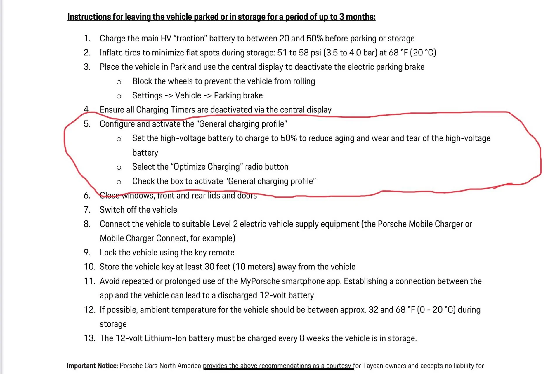

Hence my original suggestion way back in this this thread, delete ALL timers, delete all profiles except for General Profile, set General Profile to 85% minimum charge and optimizing charging set, then make sure it's enabled. But the OP seems insistent on using timer(s) for charging setting them to the same value as the profile.
Yes - this is the answer in most cases. One of the problems has always been that Porsche never published that you needed Optimized charging set for the General Profile to stop at the so called minimum charge. I brought this up with my local Porsche centre and they agreed the only place it is shown is on the storage instructions document:
Porsche Taycan Charge to 85% - What on earth is going on!!! IMG_1422
88
8,363
7,375

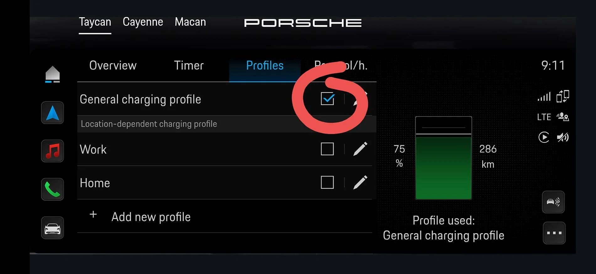

Another thing,
If you set up a profile within the car don't forget to check it!
Otherwise it'll charge to 100% straight away cuz there isn't any timer or profile active.
Simple but easy to forget and probably the solution to most "spooky" behavior of the charging proces...
Porsche Taycan Charge to 85% - What on earth is going on!!! Screenshot_20250119-111931

Another thing,
That is what I meant by making sure it's enabled. But hey, I did read the ISO spec. :CWL:
