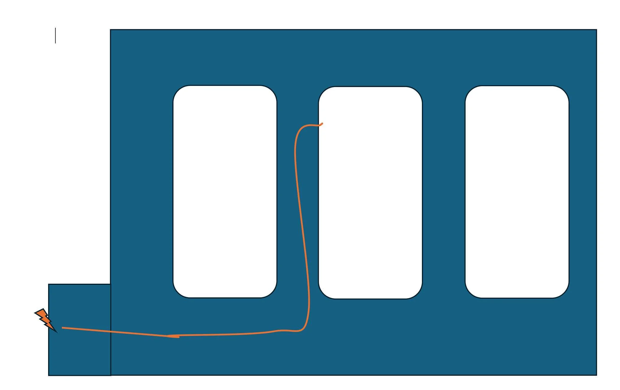

My thoughts only on the OP's specific questions of EVSE location. Mounting on the front wall will allow you to run the charging cable to any of your three cars as they change in the future. Similarly, mounting the EVSE along a side wall will allow you to run the charging cable to a vehicle parked outside your garage if you so choose.
Whatever you buy, get at least a 23 foot charging cable so you have options.

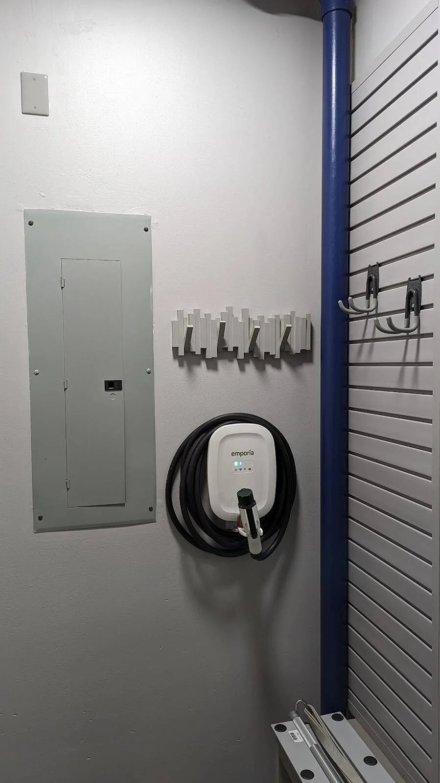

Hi everyone
Thank you all very much for your responses, they were very helpful. After some further inspection by my electrician we determined that 100 amps was more than I could handle so we went with a 50 amp breaker and a NEMA 14-50 wall plug. Decided to go with the plug rather than hardwire so I could easily change out the charger if needed and could also use the Porsche travel charger in a pinch.
I ended up going with the ChargePoint home flex level 2 charger with the NEMA 14-50 plug. I’m happy to say I’m getting 9 kw from that setup which charges me from 20-80% in just 3-4 hours. FYI that is much faster than I got from the Porsche charger that came with the car in that same outlet (5-6 kw) and infinitely faster than the Porsche charger in a 110 outlet (.9 kw)
