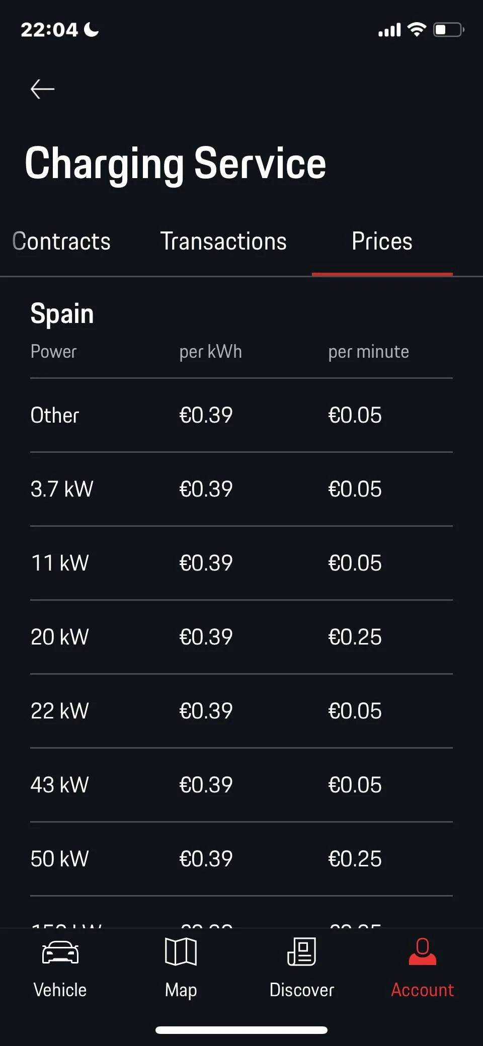

Can you provide source link? Would like to check other countries.
Here in Portugal its a mess. The price is composed of 3 components plus taxes. You need to use an app to even have an idea of the cost.
Thx

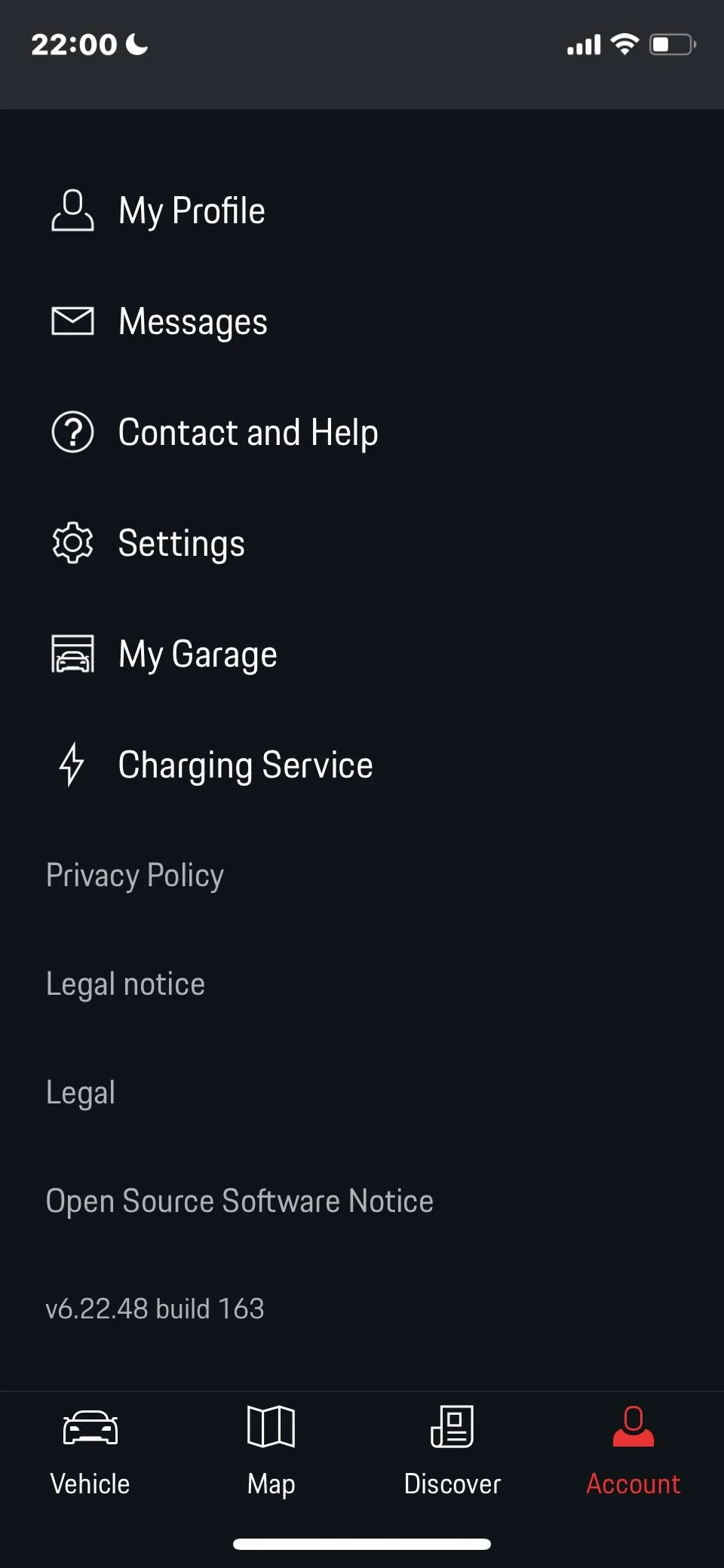

Once your Taycan is delivered you can also find the updated pricing per country for the Porsche Charging Service in the My Porsche app. Funnily enough though I could not find the info for Portugal in my app, but screen shot of rates in Spain are below.
You can't find Portugal because...
Pssst
Don't tell anyone, but Porsche hasn't got a EVSE license so they can't sell energy here... Basically you can drive up to their dealership chargers, make a sad bunny face and they'll let you charge for free because they legally can't charge you... Yet
