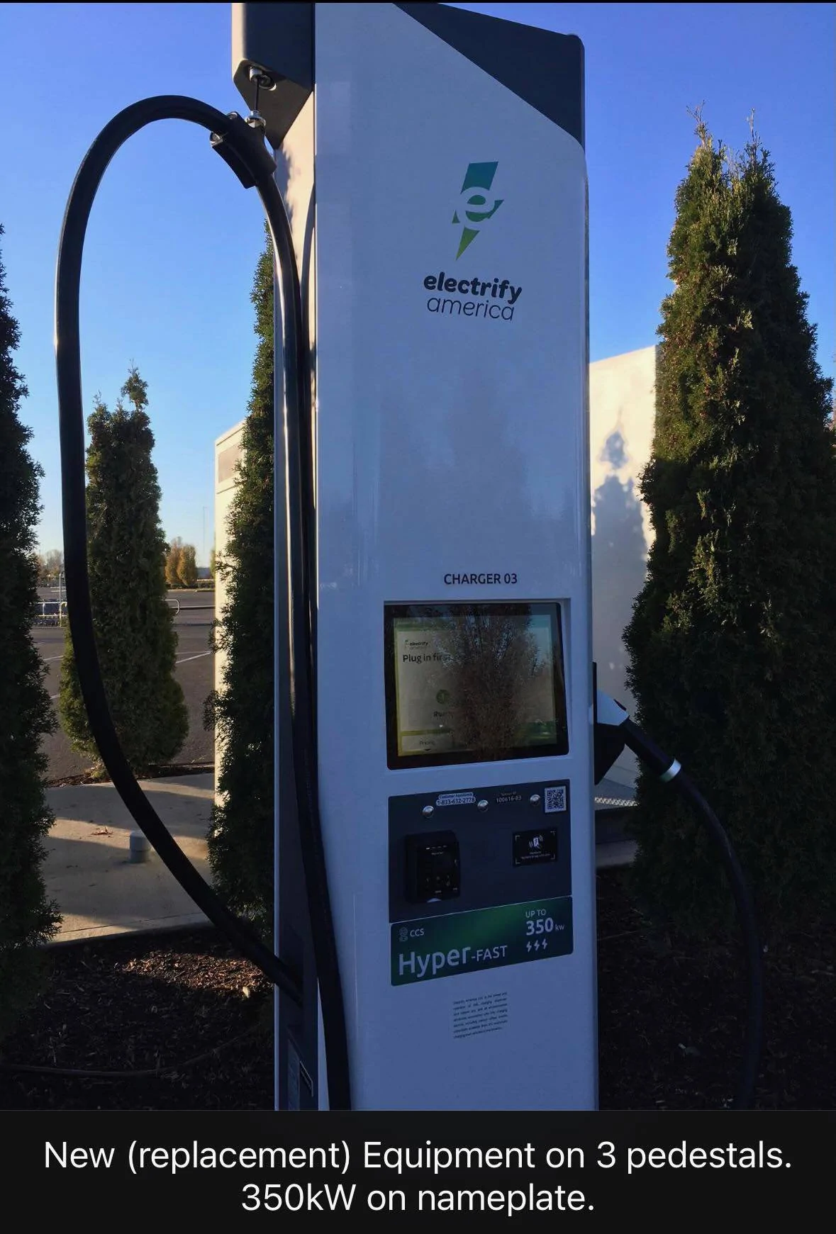

Perhaps you all knew this already, but I was under the impression that the EA upgrade only involved adding new labels to each station. I was surprised to see that the stations themselves have changed, and instead of two charging handles there is now one much longer one.
Porsche Taycan Charging Etiquette IMG_6270
Personally, I think this is a great change! I've sometimes had trouble at EA stations getting my 4s into a position where I could connect one of the charging cables. This should make it a lot easier.

That is a different question. My success rate is 100% at EA stations, but I sometimes have to try a different charger to finally get the charging process started.
So reliability is on the poor side (probably 75% or so), and that is not acceptable. I really expect to have 95% availability, and station failure to be a rare event. Today that's not the case.
That said, the move to a longer charging cable is a good one IMO.
